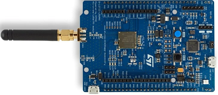

Posted on April 05, 2017 at 22:40
LoRa Discovery Kit
STM32L072 and LoRa Discovery Kit featuring Open LoRa module by Murata using STM32L072CZY6TR MCU
0690X00000603YpQAI.jpghttp://www.st.com/en/evaluation-tools/b-l072z-lrwan1.html

    Murata datasheet for product
    http://wireless.murata.com/RFM/data/type_abz.pdf
    Pin usage analysis
    CMWX1ZZABZ-091 (MURATA LORA)
     1 PA12/USB_DP
     2 PA11/USB_DM
     3 GND
     4 VDD_USB
     5 VDD_MCU
     6 VDD_RF
     7 GND
     8 PB4/DBG_SX1276_DIO2
     9 PC13/DBG_SX1276_DIO3
     10 PA5/DBG_SX1276_DIO4 ?? UNUSED
     11 PA4/DBG_SX1276_DIO5 ?? UNUSED
     12 PB1/DBG_SX1276_DIO1
     13 PB4/DBG_SX1276_DIO0
     14 PB15/SPI2_MOSI
     15 PB14/SPI2_MISO
     16 PB13/SPI2_SCK
     17 PB12/SPI2_NSS
     18 PA10/USART1_RX
     19 PA9/USART1_TX
     20 PA8/MCO
     21 PA5/ADC5/DAC2
     22 PA4/ADC4/DAC1
     23 PA3/ADC3/LPUART1_RX/USART2_RX
     24 PA2/ADC2/LPUART1_TX/USART2_TX
     25 GND
     26 ANT
     27 GND
     28 PA1/DBG_CRF1 (ANT_SWITCH_RX)
     29 PC1/DBG_CRF3 (ANT_SWITCH_TX_BOOST)
     30 PC2/DBG_CRF2 (ANT_SWITCH_TX_RFO)
     31 STSAFE_NRST
     32 VREF+
     33 PA0/WKUP1/UART4_TX
     34 MCU_NRST
     35 PB8/I2C1_SCL
     36 PB9/I2C1_SDA
     37 PB2/LPTIM1_OUT
     38 PB7/LPTIM1_IN2/USART1_RX/I2C1_SDA
     39 PB6/LPTIM1_ETR/USART1_TX/I2C1_SCL
     40 PB5/LPTIM1_IN1
     41 PA13/SWDIO/LPUART1_RX
     42 PA14/SWCLK/LPUART1_TX
     43 BOOT0
     44 GND
     45 PH1/OSC_OUT
     46 PH0/OSC_IN
     47 TCXO_OUT
     48 VDD_TCXO
     49 GND
     57 GND
    WLCSP49

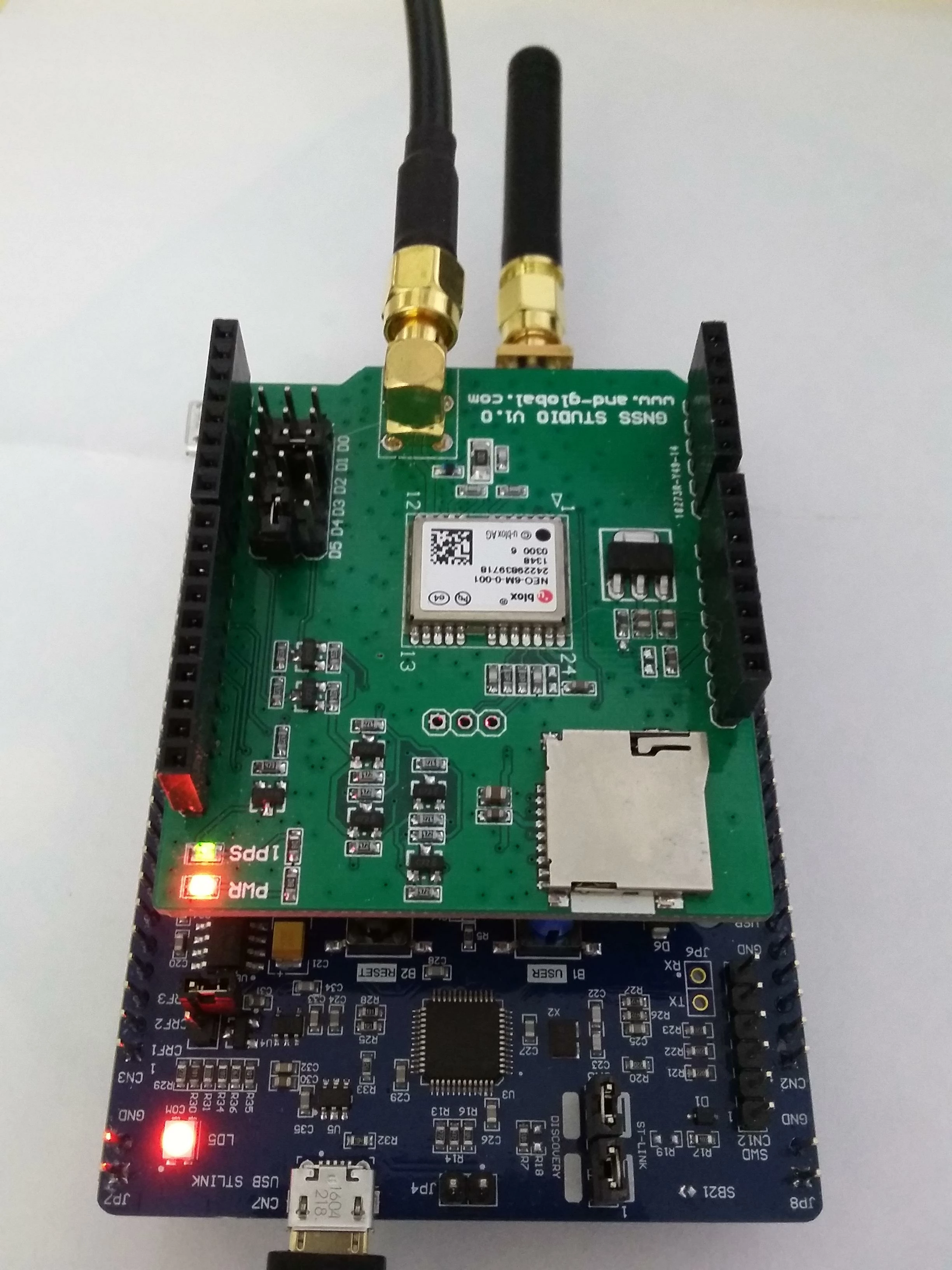

    In order to evaluate the range I built two nodes, one which pings location every second from a GPS shield, and a second that receives that data from a fixed antenna.
    Tesla DeLorean
    Guru
    Apr 11, 2017 8:17 PM UTC
    Posted on April 11, 2017 at 22:17
    So with a relatively low effort test (used good antennas, but didn't clamber up towers or onto the roof), I got fixes out to 3000ft (915m)
    This was with the 14dBm (25mW) TX_OUTPUT_POWER setting. With a better antenna and placement on the vehicle the line of sight was 1.77miles (2850m). The next build of the software I'll try the 20dBm (100mW) setting.

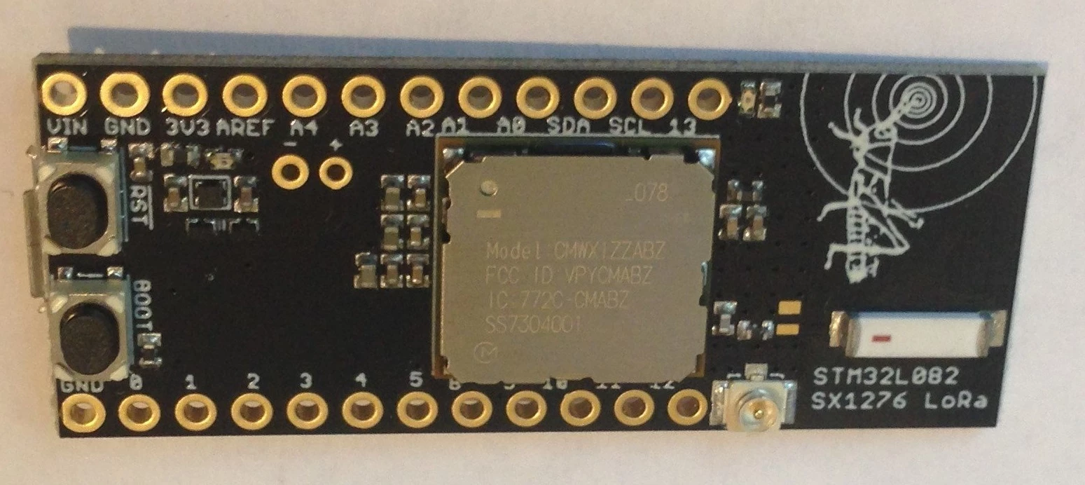

    https://www.tindie.com/products/TleraCorp/grasshopper-development-board/
    Kris Winer has shrunk Arduino type functionality into a minimal footprint using the Murata module.
