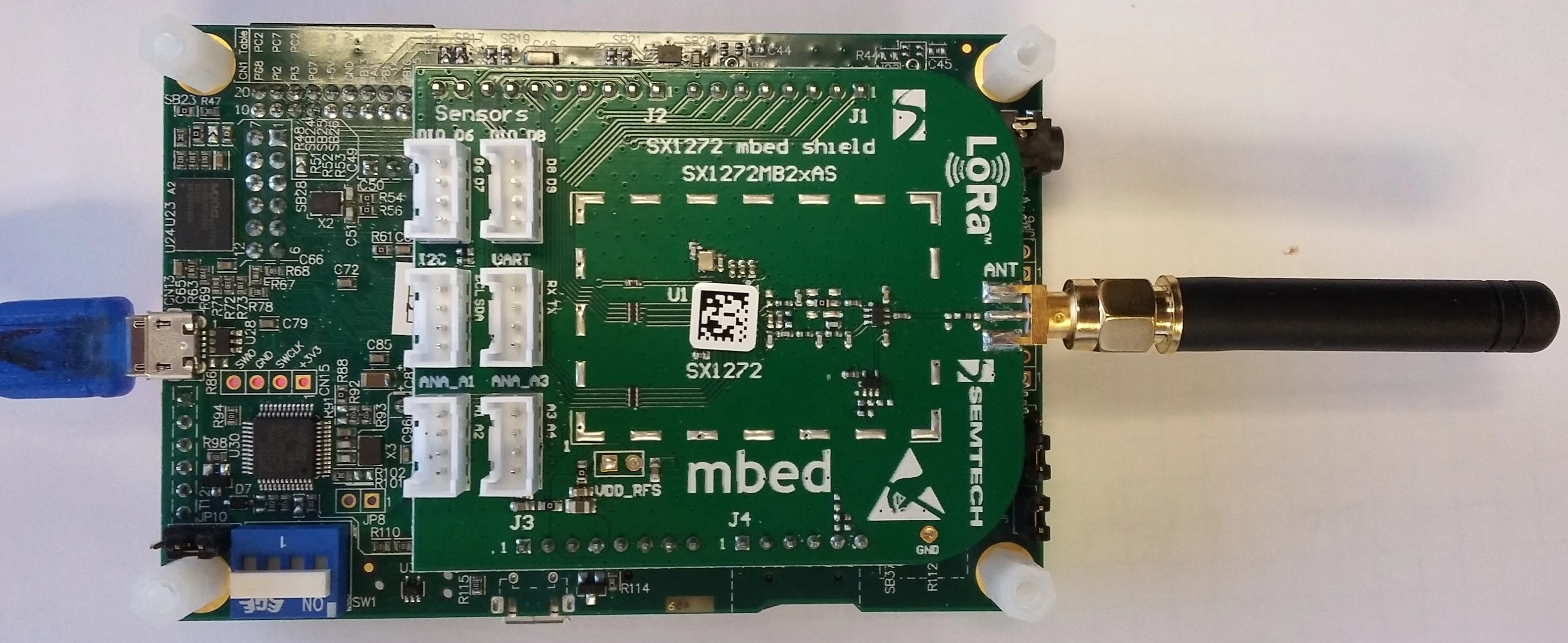

    LRWAN successfully ported to assorted STM32L4 boards using the SX1272 shield
    NUCLEO-L476RG
    NUCLEO-L496ZG
    B-L475E-IOT01A
    https://community.st.com/0D50X00009XkgY0SAJ

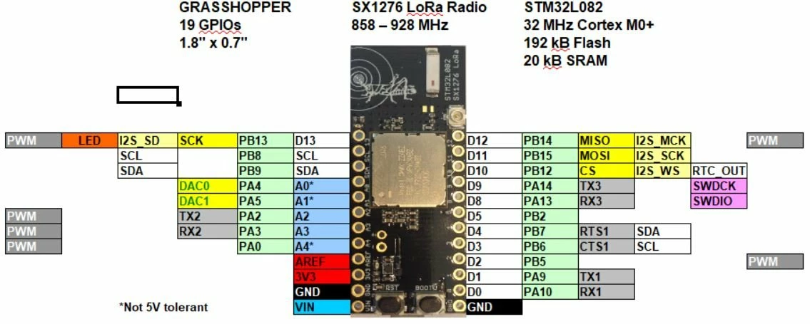

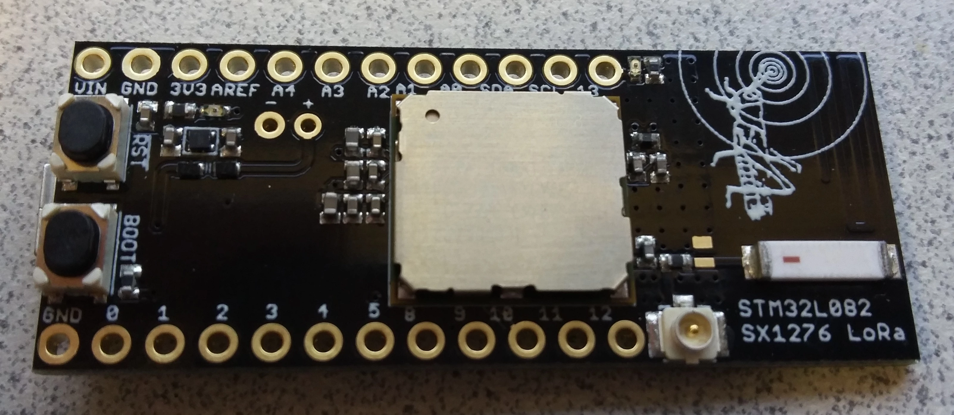

    Posted on September 01, 2017 at 22:25
    Ported code to the Grasshopper, had to change TCXO enable to PH1.
    PB13 is LED
    Schematic looks to be wrong, SWDIO is D8, SWCLK is D9
    DFuSe 3.05 doesn't seem to work properly with the STM32L0
    USART2 works on PA2/PA3, hooked that up for debug telemetry, equivalent to B-L072Z-LRWAN1 discovery board.
    SARTHAK KELAPURE
    Jan 24, 2018 5:44 AM UTC
    Posted on January 24, 2018 at 06:44
    By TCXO enable, you need to say TCXO_VCC? Is it?

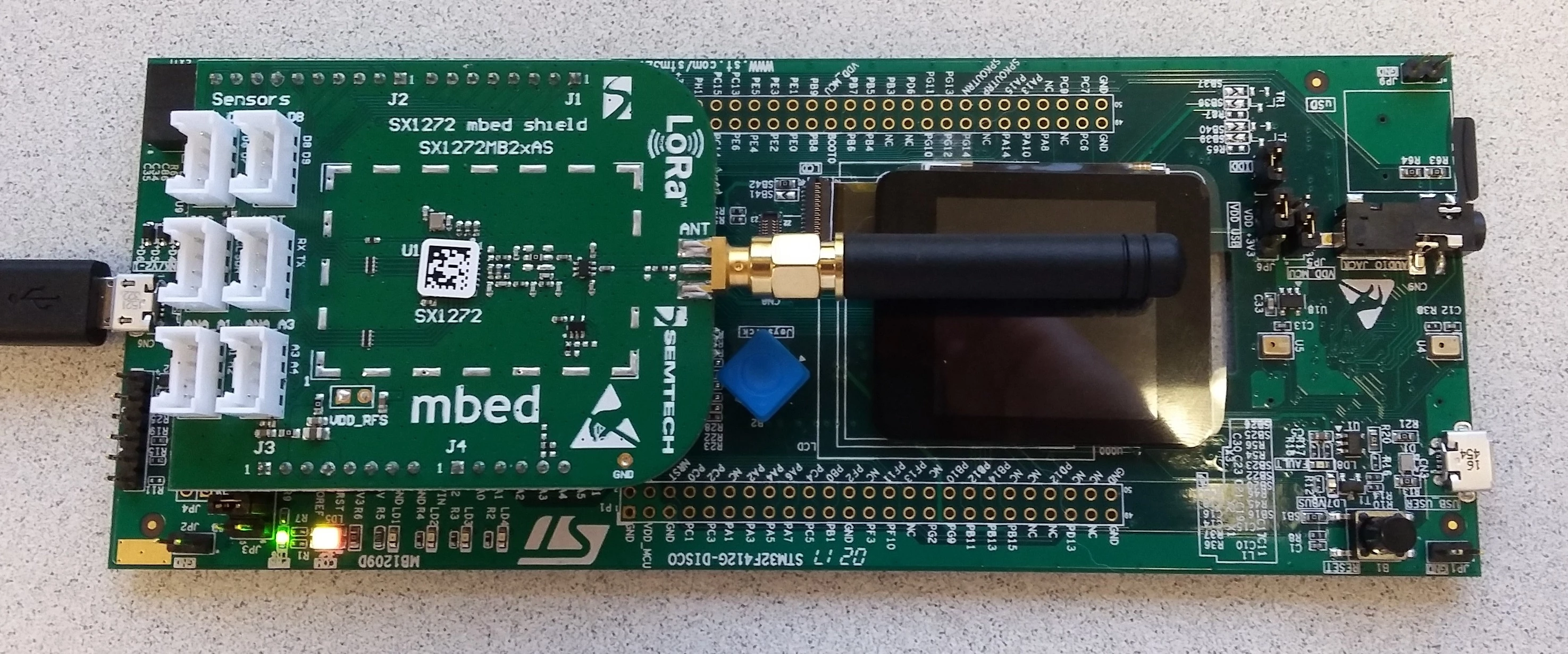

    STM32F412G-DISCOVERY

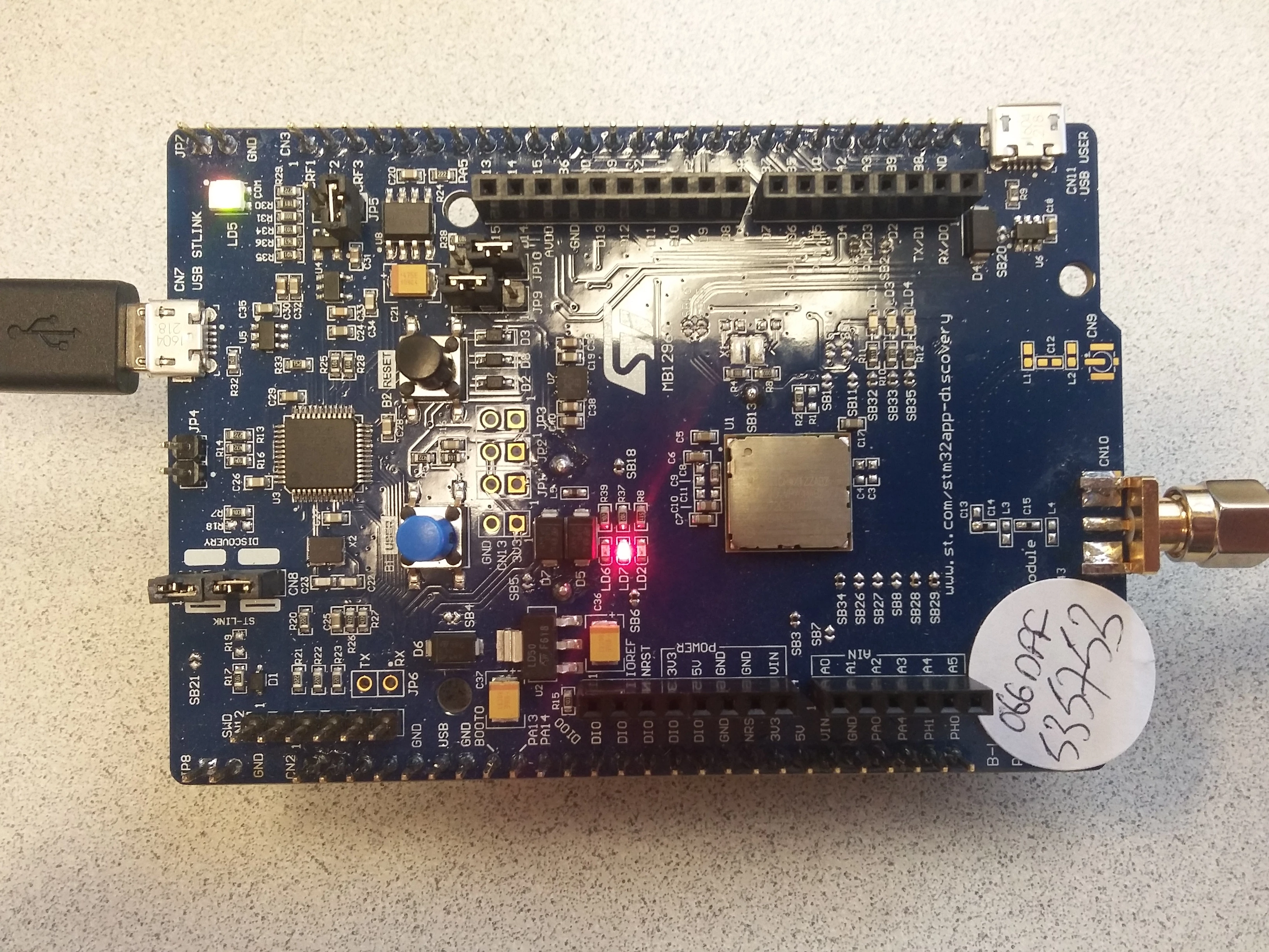

    Former Member
    Oct 3, 2017 3:05 AM UTC
    Posted on October 03, 2017 at 05:05
    Hi Clive
    I don't know how to connect to the ST kit B-L072Z-LRWAN1 through USB to my PC. In attached image, i connect to my PC and don'tload usb driver of st-link/v2-1. It don't connect. please show me the image of connecting your PC with target board of the ST kit B-L072Z-LRWAN1.
    Thans for your help. David
    Tesla DeLorean
    Guru
    Oct 3, 2017 9:29 PM UTC
    Posted on October 03, 2017 at 23:29
    Make sure you have current drivers, they should install as part of the ST-LINK Utilities package, or as the driver only package. You should see 4 or so devices come up related to the ST-LINK, VCP and MSC, etc
    Connect directly to the PC, not via a hub. Try another cable, or USB port.

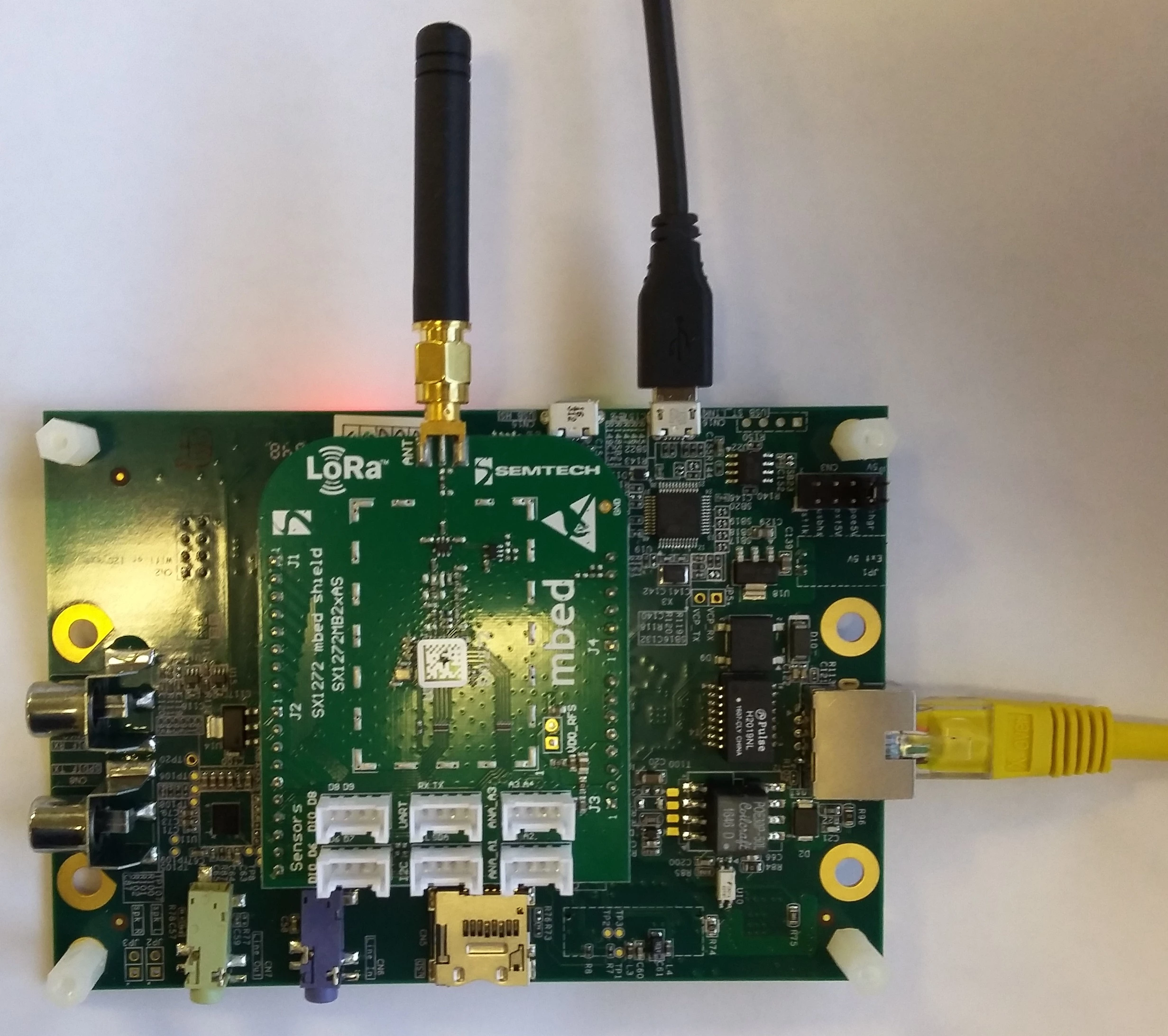

    LRWAN successfully ported to STM32F769I-DISC1 board using the SX1272 shield.
    PoE powered node.

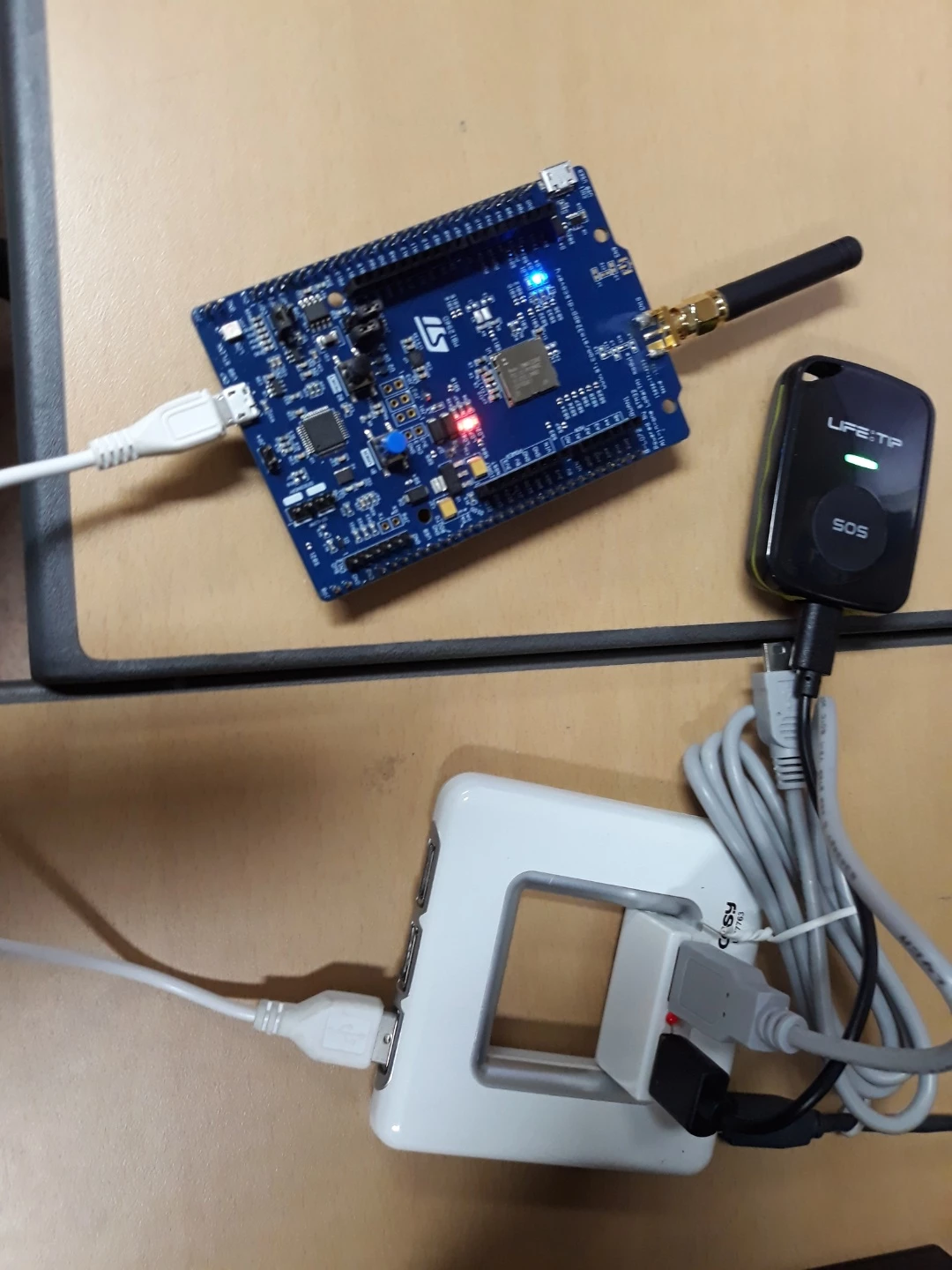

    Hello everybody,
    first of all well done clive for this topic, great initiative. We did a LoRaWan network with the same end-node (i.e
    B-L072Z-LRWAN1) type CLASS-A. Then we used a multitech gateway (Conduit-AEP), Senet as 'network server' and Cayenne (mydevices) as 'Application server'.
    This architecture will be used only during prototype period...
    According to you, is it a good idea to bring back my experience about our LPWAN on this topic?
    We have only start for 3 months, for example placement of the gateway has not been optimized despite this with our demonstrator (Minimum Viable Product) 'The-Proof-Of-LoRaWan-Concept' was succes.
