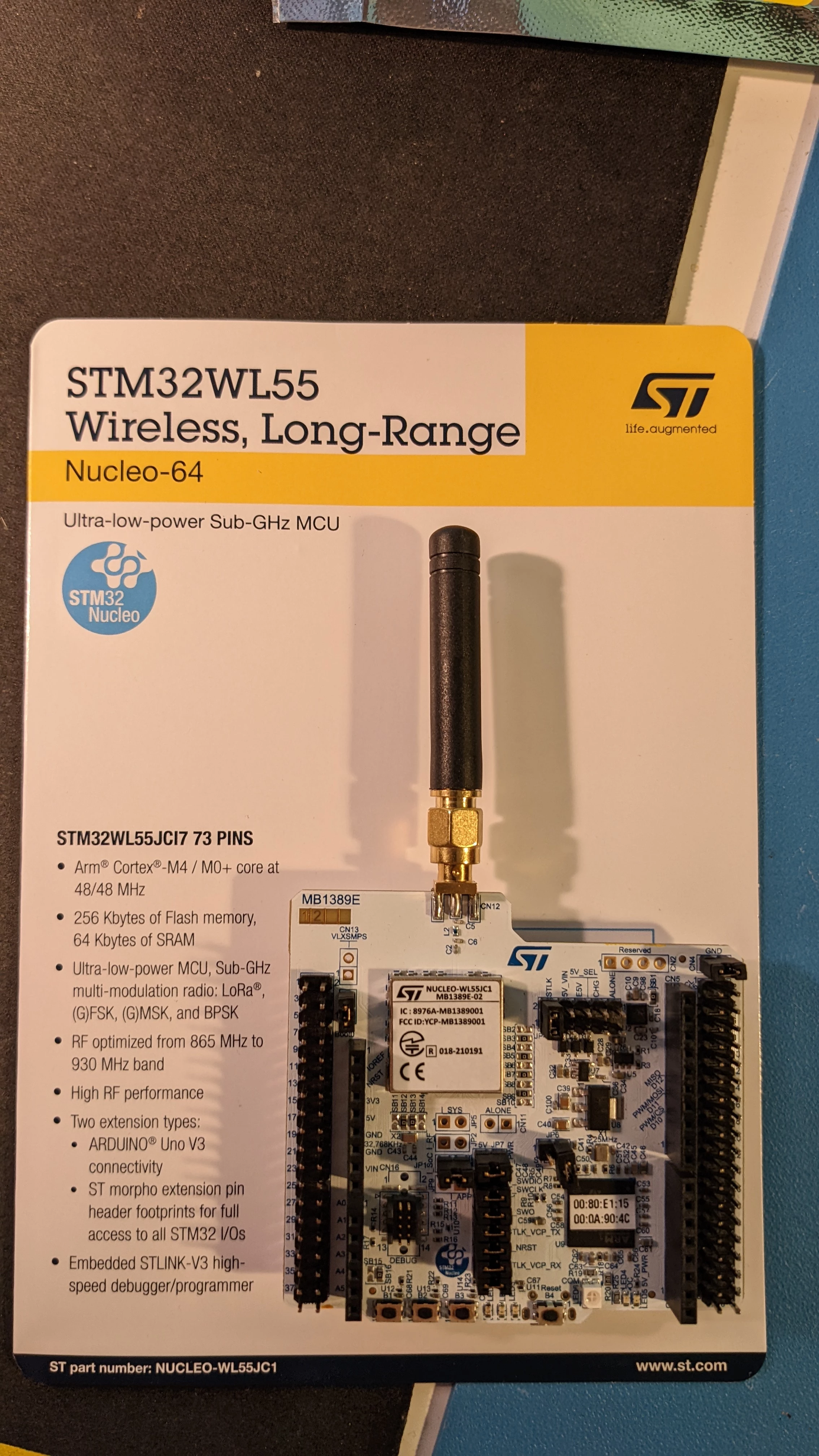

0693W00000Nt3scQAB.jpgI understand that the firmware version is strange and that is probably why the ST-Link utility won't upgrade the board because it doesn't understand it either. Is there a way around that?
This is an official Nucleo-64 board I purchased from Mouser a week ago, see pic above. When you say "Try with a real STLink." do you mean use another ST-Link to program the STM32WL55 microcontroller or use another ST-Link to update the firmware on the onboard STLINK-V3E MCU? Because I would like this to work as it was manufactured by ST. I would like to fix the STLINK-V3E MCU. Is there a way to upload the appropriate firmware any other way?

OK It is an official ST board so an official STLink too.
So, I think you mentioned STLink Utility but this software is too old and replaced by STM32CubeProgrammer.
So, try with the latest version and maybe on another PC or USB cable as you stated you had issues.
Is the jumper JP6 set on STLK RST (STLink Reset) ?
It should not be set to let the STLink work.
