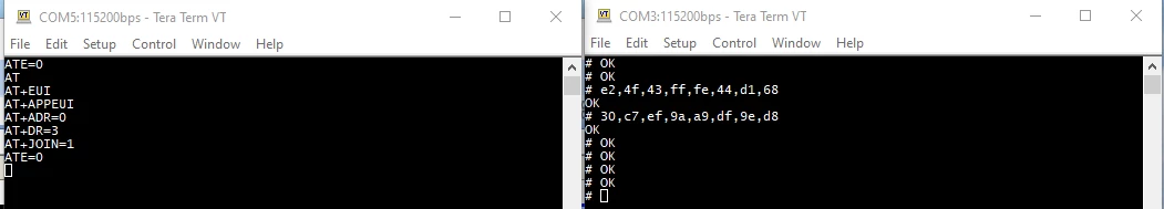

I am sniffing the D0 (modem Tx) and D1 (modem Rx) pins with two TeraTerm instances.
With the original firmware as supplied, I could see AT commands & responses.
After building & downloading the LoRaWAN_AT_Master project in CubeIDE 1.5.1, when the Nucleo is reset, I see a junk character from it, which is echoed by the modem, and the modem then gives its <cr>#<space> prompt, but the Nucleo then never sends any AT commands:
Stepping in the CubeIDE is useless (optimisation?), but I can see that HAL_UART_Transmit is being called to send "ATE=0\r", and it seems to return OK.
But no AT command is actually seen at the pins.
The code then, of course, just hangs waiting for the response.

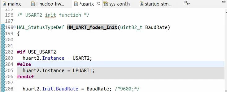

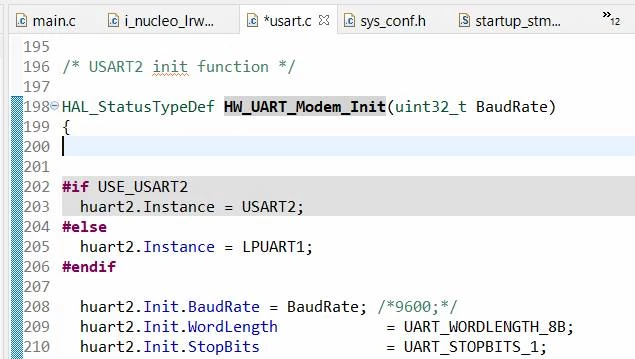

It seems that, indeed, this has never worked:

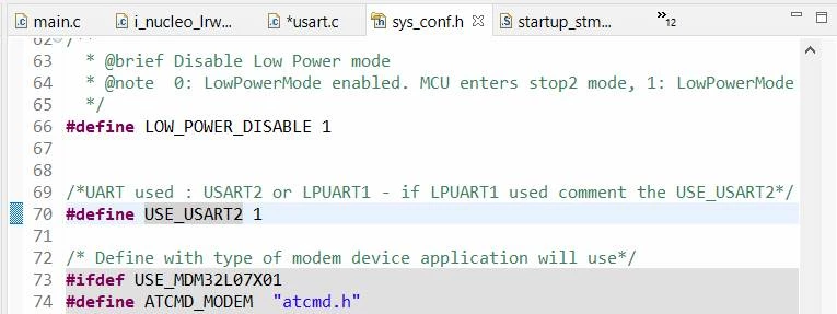

0693W00000Bcnp3QAB.pngIt's using the wrong UART: it’s using LPUART1 – but the I-Nucleo-LRWAN1 is connected to USART2 !
This is correctly configured in sys_conf.h:

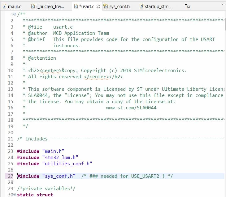

But sys_conf.h is not included by usart.c!
If I add the missing include:
it does then use the correct USART:

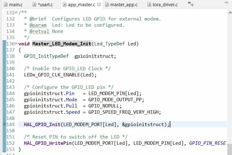

But, when I download & run that, I get a Hard Fault somewhere in Master_LED_Modem_Init:
The behaviour is the same in STM32CubeIDE v1.5.1 and v1.6.1 (the latest).

Hello Andrew,
I do response and will do support to solve the current problem. Effectively by default UART was the LPUART1 due to the missing of initial definition of USART2 which is defined in "sys-conf.h" file. Do include "sys-conf.h" statement in uart.c file. To solve the hard fault (I do have to check completely why) do disable the debug mode ( in sys_app.c the DBG_Init() function). In addition in the Gpio_PreInit() function put in comment the two "__HAL_RCC_GPIOA_CLK_DISABLE()" and "__HAL_RCC_GPIOC_CLK_DISABLE() " statement. To see if you have activities on PA2 (UART2_Rx )/ PA3 (UART2_Tx) pins, best way is to connect a FTDI chip cable USB/UART . I'm working on the problem to solve the issue by this week

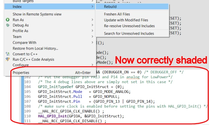

Andrew Neil
July 15, 2021
The code is building correctly - it is doing the "DEBUGGER OFF" part - it's just the IDE that was incorrectly shading the source in the editor.
This was fixed by doing the Index > Rebuild:
