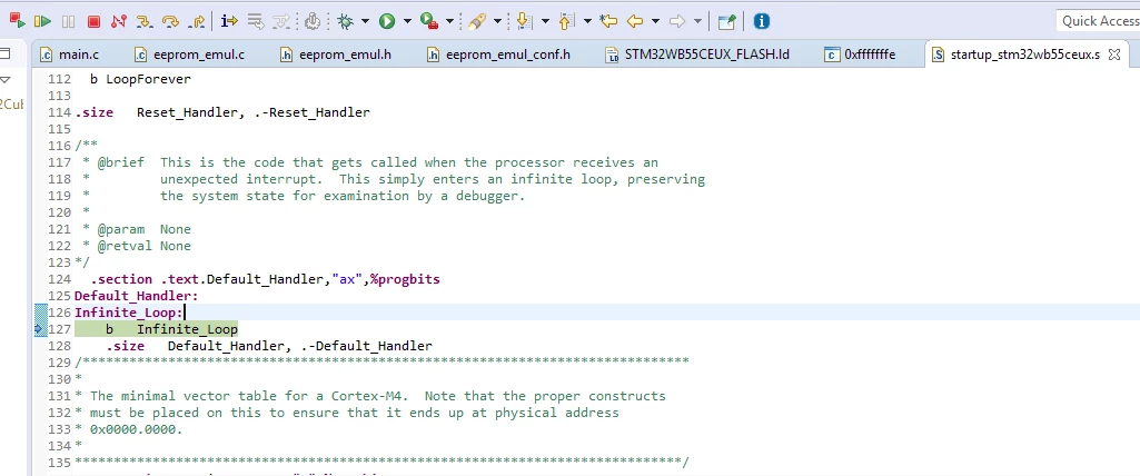

I tried to include an example code of EEPROM from the X-CUBE-EEPROM_V2.0.0 pakage for my STM32WB55CE controller's project. As my SFSA is 0x0805 7000, I have set the Starting address of EEPROM Emulation as 0x08050000. When I debug to check the code, at function "EE_Init(EE_FORCED_ERASE);", its going to the file "startup_stm32_wb55ceux.s" infinite loop section as shown in the screenshot. Please guide why is it happening and what can be done.
If I run only the example code, as I have mentioned earlier, it works. Only after including the same example in my project, I see this problem.

Have you checked that the ICFEDIT_region_ROM_end in your linker file is below (0x08000000 + (SFSA << 12)) - 1 ?
Also you really don't have information about the last instructions executed ?

You can also try to keep the startup_stm32wb55xx_cm4.s file used in the EEPROM emul project which is compatible with the WB55CE product (where did you find startup_stm32_wb55ceux.s ?).
If you set breakpoints in the FLASH_IRQHandler and HSEM_IRQHandler in the stm32wbxx_it.c file, can you check that they are triggered before looping infinitely ?

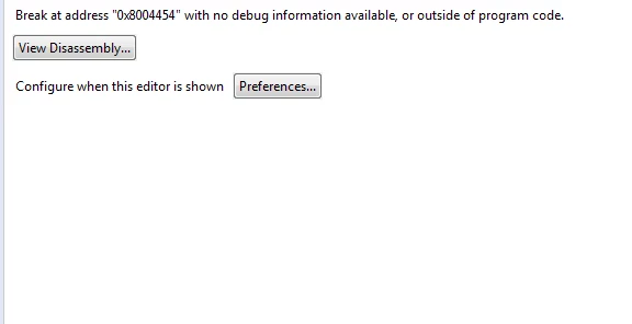

Right now I have added OTA feature to my existing code. SO my code starts at 0x08007000 in the flash. And I am facing new problem in implementing EEPROM emulation.
As my SFSA is 0x57, my FUS and BLE stack binary resides from 0x08057000. So using the formula (0x08000000 + (SFSA << 12)) - 1 , I get 56FFFFFF in hex. But I am sorry to say I could not calcluate the byte size for my code.
Right now I have set my "START_PAGE_ADDRESS" as 0x08040000U. I just tried to test for 5 values to be stored in the emulated region. I am able to write and read only the first byte. i.e; with the following functions "EE_WriteVariable32bits()" and "EE_ReadVariable32bits".
For the next 4 byes the write and read operations are failing with return status  "EE_WRITE_ERROR" for Write operation and "EE_NO_DATA" for read.
And this time I am unable to do debugging also. I get a problem as in the screenshot.
Please guide.
Thank you.

Hello GBehe,
Sorry to hear you had a bad time and happy if you are recovering well.
Which IDE are you using ? So I can help you to determine your code size.
Regarding the size of the emulated EEPROM (not included in the code size), you can find the formula to determine it in the AN4894 on EEPROM Emulation (https://www.st.com/resource/en/application_note/dm00311483-eeprom-emulation-techniques-and-software-for-stm32-microcontrollers-stmicroelectronics.pdf).
Btw, you should at least be able to read/write the first 5 EEPROM values stored so there might effectively be a problem somewhere.
So I can help you:
* Can you share your linker file ?
* As mentioned in my last message, the startup_stm32wb55xx_cm4.s file used in the EEPROM emul project should be the starting startup file for your customized project if you use EEPROM emulation.
* How can you detect the returned status (EE error) if debugging does not work ? Does the debug ability stops after the failed operation ?

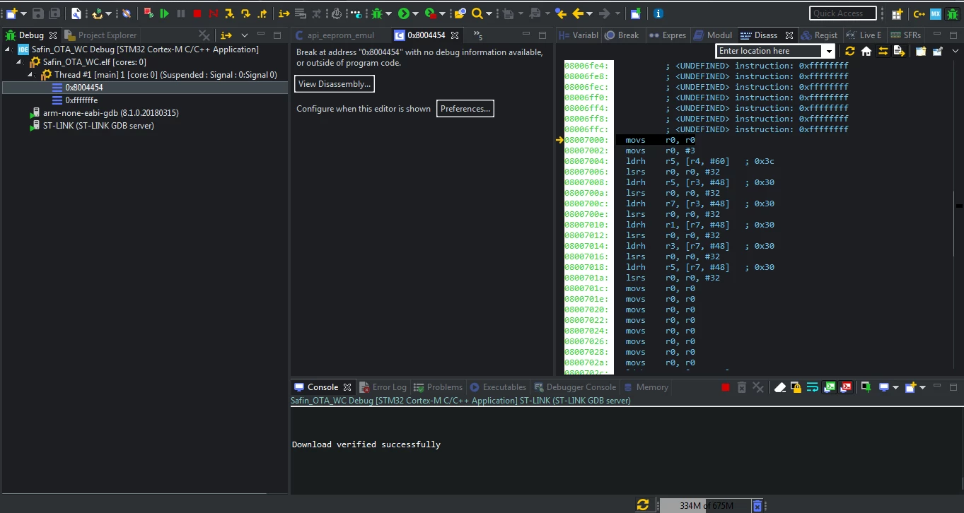

* Also the screenshot you have shared show a break address below the start address for your code (Is this area used by your OTA app ?). Can you try to click disassembly (options proposed in your screenshot) and share with me if the assembly code highlights a specific function ?

The screenshot I had shared, shows address which comes in the OTA application region. Debug stops at the main with the error message in the screenshot.
Please find the screenshot of disassembly (options proposed in my screenshot).

For STM32CubeIDE the startup file is called startup_stm32wb55rgvx.s and not startup_stm32wb55xx_cm4.s. It is located in STM32CubeIDE/Application/User/Startup. If you are using the BLE_HeartRate_ota app I have checked and its startup file is the same than the X-CUBE-EEPROM one.

I could find the startup file in my project in STM32CubeIDE/Core/Startup. Its "startup_stm32wb55xxcgux.s". But when I open it, startup_stm32wb55xx_cm4.s opens up in Cube IDE. I had put a break point just for test, at line 142 - " .word Reset_Handler". On debug, I get the same message which I shared in screenshot. Its breaking at an address which starts before 0x08007000(starting address of my program). Am I doing any mistake in tracing out things?
