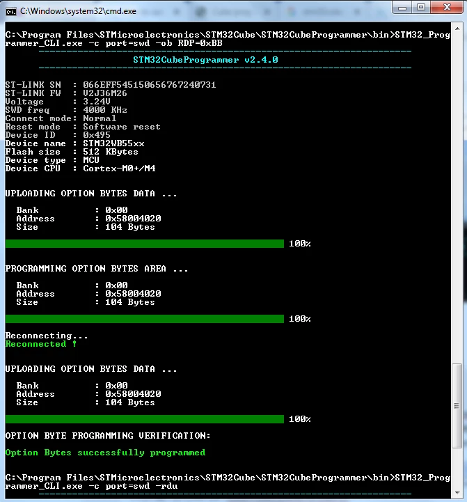

This can be done via the 2 lines in a batch file in CLI mode
CLI.exe -c port=swd -ob RDP=0xBB
CLI.exe -c port=swd -rdu
Or using the mass erase feature available in the CubeProgrammer tool in GUI mode.
Then the upload of the RF stack should be OK.

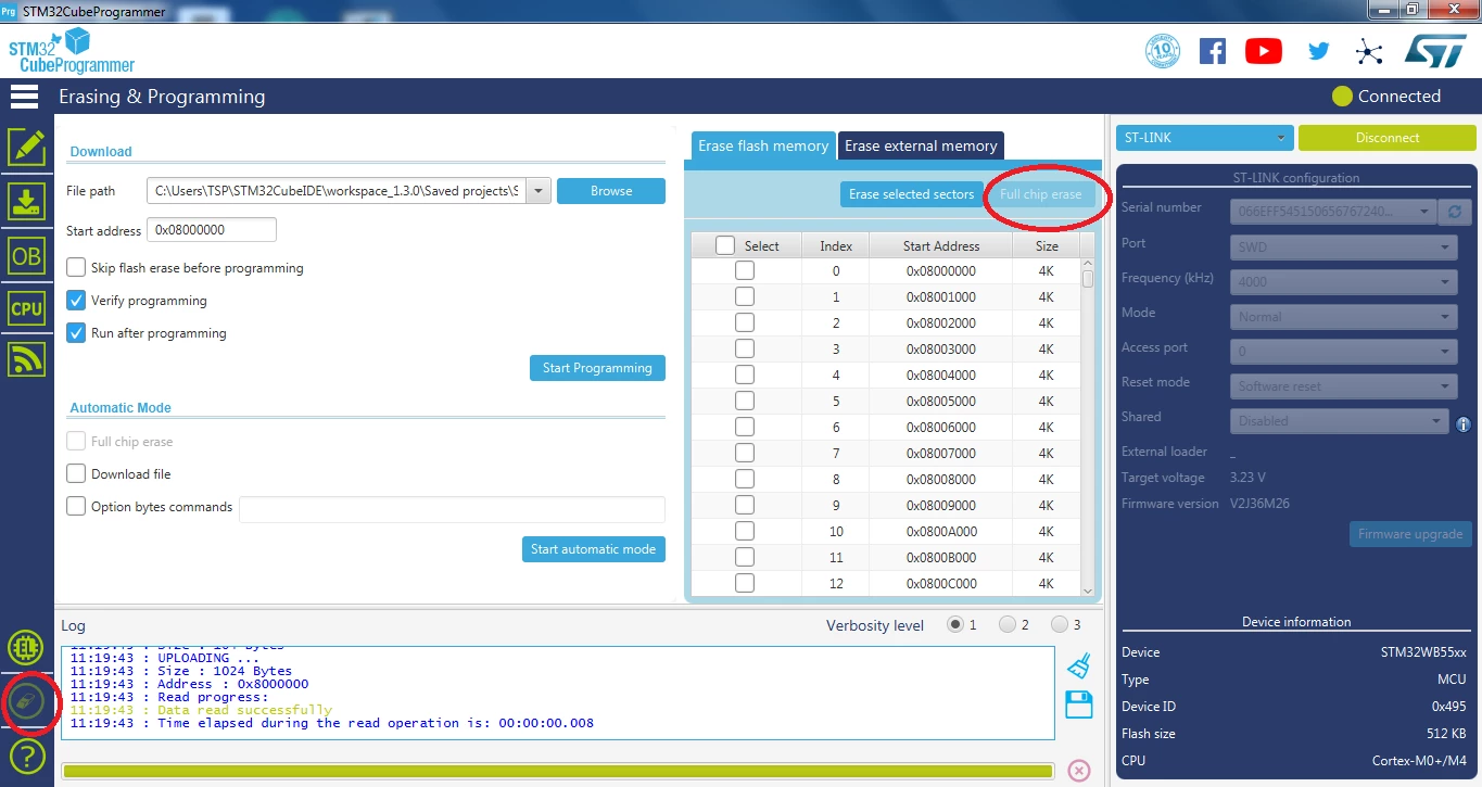

To do a mass erase, I tried first using CUBE programmer GUI. It doesn't provide the option when my device is connected. You an see the screenshot.

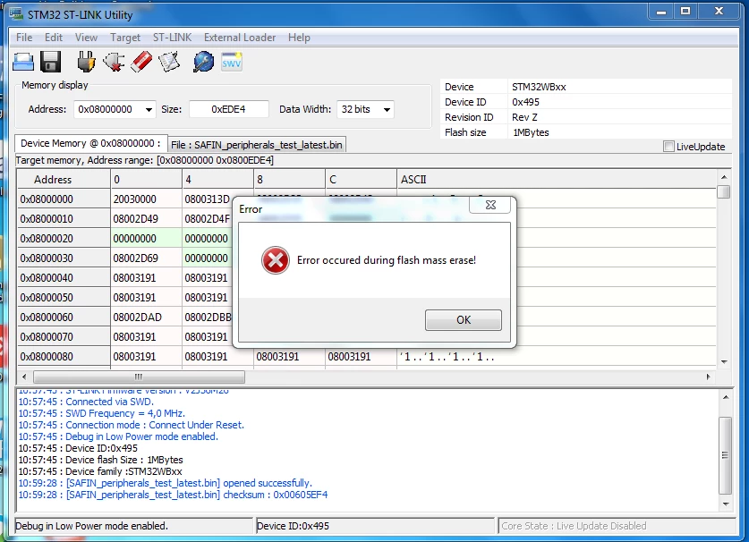

Then I tried doing it in STlink utility. It also ailed. Screenshot attached.
Log:
10:57:45 : ST-LINK SN : 066EFF545150656767240731
10:57:45 : ST-LINK Firmware version : V2J36M26
10:57:45 : Connected via SWD.
10:57:45 : SWD Frequency = 4,0 MHz.
10:57:45 : Connection mode : Connect Under Reset.
10:57:45 : Debug in Low Power mode enabled.
10:57:45 : Device ID:0x495
10:57:45 : Device flash Size : 1MBytes
10:57:45 : Device family :STM32WBxx
10:59:28 : [SAFIN_peripherals_test_latest.bin] opened successfully.
10:59:28 : [SAFIN_peripherals_test_latest.bin] checksum : 0x00605EF4
11:05:19 : Error occured during flash mass erase!
11:19:39 : Disconnected from device.

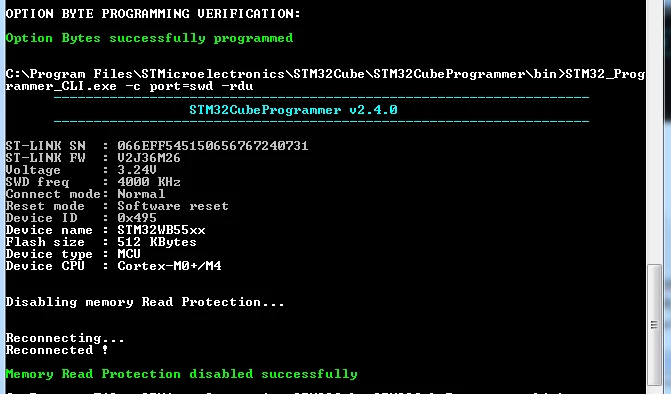

Again, I performed those commands you had mentioned, in Cube programmer CLI. They worked fine. You can see in the screenshot.
GBehe
GBeheAuthor
August 20, 2020
The command for memory read protection disabling also worked.

​Using CubeProgrammer, the mass erase is achieved checking the "Select" option to select all sectors.
Then click on "Erase selected sectors". It must work!
