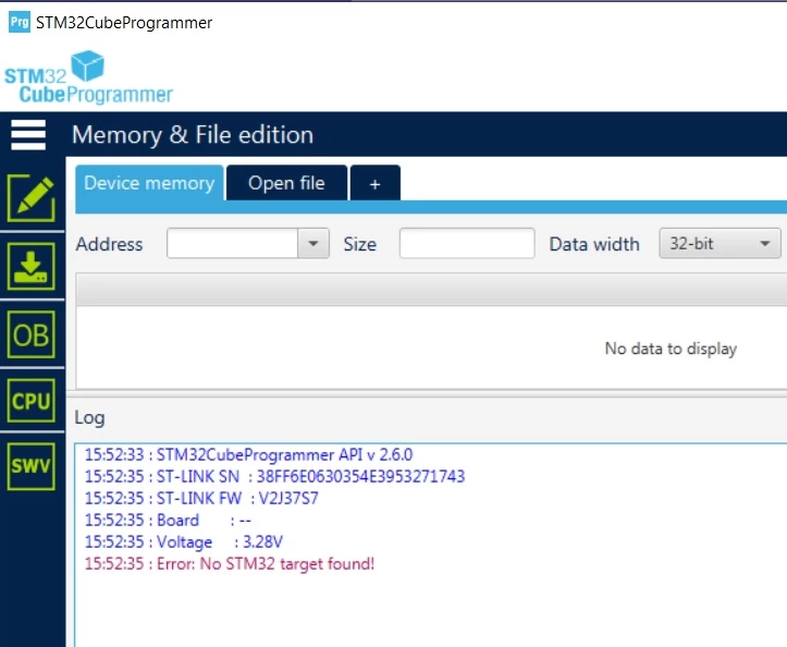

I bought ST-LINK/V2 from a certified reseller, and I have WIO-5E mini with STM32WL5JC from [Seeed.com](https://Seeed.com) on the board. This WIO-5E was already programmed by another ST-LINK/V2. I connected WIO-5E to ST-LINK as required. I want to reprogam WIO-5MINI using this programator. But STM32Programmer answered:
0693W00000YA1JoQAL.pngWhat should I do so STM32Programmer will see STM32WL5CJ from the WIO-5E mini board?

Get a current version of STM32 Cube Programmer, v2.6.0 is a bit old​

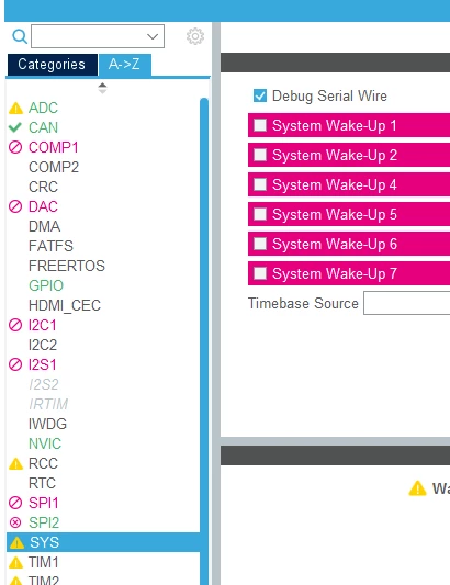

>I upgraded the firmware with a stupid trick
No. thats what you should do, to "start in update mode " .
> Previously downloaded code into WIO-5E sill running,
AAA, new info. It was working before ??
so just look, what you set in option bytes. there is something , that disables SWD , i suppose.
or in your program -> using the SWD+SWC pins for something, change their mode;
+ you set in Cube : SWD ?

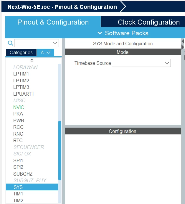

@AScha.3​ ​ Here is my view:
0693W00000YAA2IQAX.pngIt looks completely different from your's view.
But I can't understand the relation between the configuration of an application and trying to connect ST-LINK to WIO-5E mini (with STM32WL5JC chip on the board)
AScha.3
February 7, 2023
ok, (pic was from F072 cpu) , on your WL5x cpu the relevant pins can be set to different functions, if you want SWD debug connect, you must set PA13 + PA14 to SWD+SWC function. otherwise they will do, whatever is set to them.
if you just want flash/load program, maybe you should try bootloader mode and flash this way.
