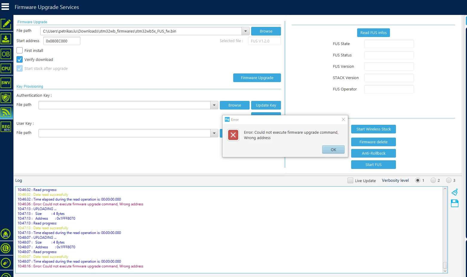

It says I must now download new wireless stack (I have stm32wb5x_BLE_Stack_full_fw.bin)
The instruction say:
  • in Firmware Upgrade Service: (File Path: [Wireless_Coprocessor_Binary], Start Address: [Install@])
The document says: [Install@]. What does that supposed to mean?
I am very confused on what should be Start Address. I tried looking everywhere but cannot find such information. Could someone point me in the right direction please?

I have tried flashing via Firmware Upgrade Services but it does not seem to allow:

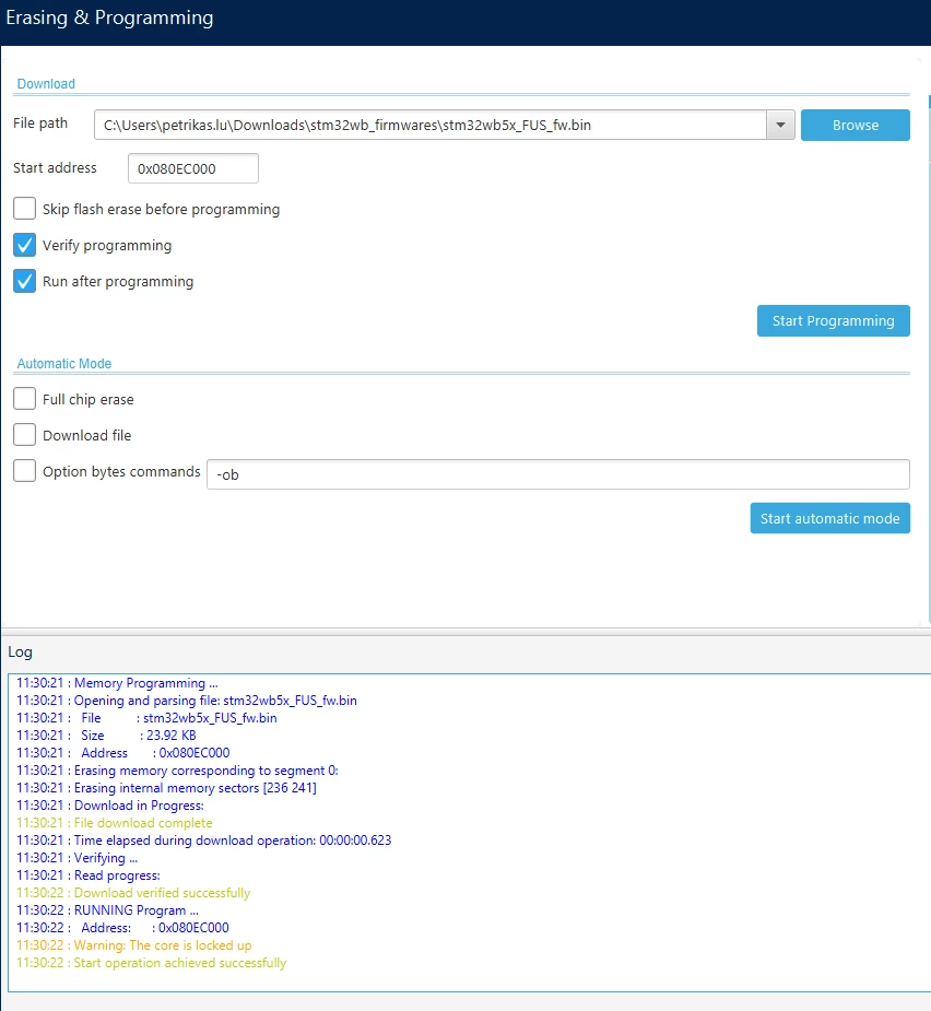

I have tried to flash the firmware via the Erasing & Programming section of STM32CubeProgrammer instead of Firmware Upgrade Services.
I was able to succesfully flash the FUS firmware:

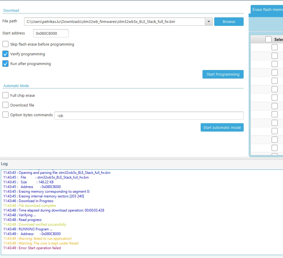

I then moved to BLE stack firmware:
It seems that flashing is successfull apart from a couple of warnings (I am not sure if they are relevant.
I want to know why I am able top flash via Erase & Programming menu and not Firmware Upgrade services.
Also, Since I have flashed all the firmwares, how can I now check if everything is ok?

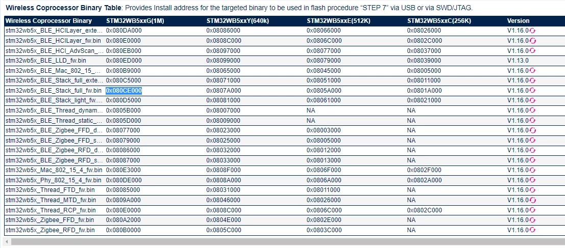

You can look this wiki page which describes step by step how to setup your board. In your case for BLE Full stack (stm32wb5x_BLE_Stack_full_fw.bin) from STM32CubeWB package v1.16.0, the download address is 0x080CE000 if you are working on NUCLEO-WB55 board according to the release note, see the following screenshot:

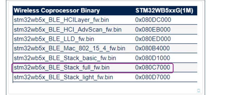

I am confused already again regarding start address of BLE stack firmware. The wiki that you provided says:
And you mentioned 0x080CE000
Is that a mismatch because that image is from an older version?
Remy ISSALYS
Apr 27, 2023 9:11 AM UTC
On the wiki page the screenshot corresponds to an older version of STM32CubeWB package. You should use the address corresponding to your version (the latest is v1.16.0).

Thanks for clarifying again. I have followed the instructions at wiki and getting issues
I simply did:
  1. Connect the st link to the device
  2. Launch the CubeProgrammer
  3. Connect to the device
  4. Go to Firmware Upgrade Services
  5. Click "Start FUS"
  6. Click "Read FUS info" and confirm if the version is correct. In my case it is correct.
  7. In File Path browse and select correct binary file. In my case it is stm32wb5x_BLE_Stack_full_fw.bin
  8. Start address :0x080CE000
  9. Tick "First install" and "Start stack after upgrade"
  10. Click Firmware Upgrade
After that, the error message pops up and says:
Error: Could not execute firmware upgrade command, Wrong address
It seems that this is a known issue:
https://community.st.com/s/question/0D50X0000BNtd6DSQR/error-when-updating-fus-firmware
and here
https://community.st.com/s/question/0D53W00000sq3zcSAA/how-to-update-stm32wb55ce-fus-and-wireless-stack-
I went through these other forum posts but there doesnt seem to be a clear solution
Perhaps it is some issue with my Option bytes? Would it help if I show to you. Although I havent touched them

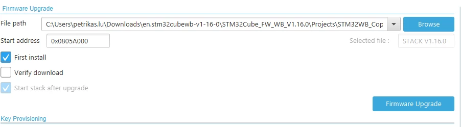

Apr 27, 2023 10:49 AM UTC

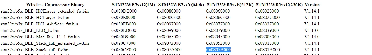

I was able to successfully flash the stack firmware (atleast it said that it was sucessfull) but when I read back FUS infos, it still shows old STACK version.
We are using our custom board that has
STM32WB55REV6. It is 512Kb chip. According to release notes, I should be using address:
The STM32CubeProgrammer version: v2.11.0
I have downloaded latest STM32WB (v1.16.0) package from:
https://www.st.com/en/embedded-software/stm32cubewb.html#get-software
I repeat all the steps.
  1. Connect STMCubeProgrammer with the device.
  2. Go to Device Firmware Update Service.
  3. Click "Start FUS" and read FUS infos:

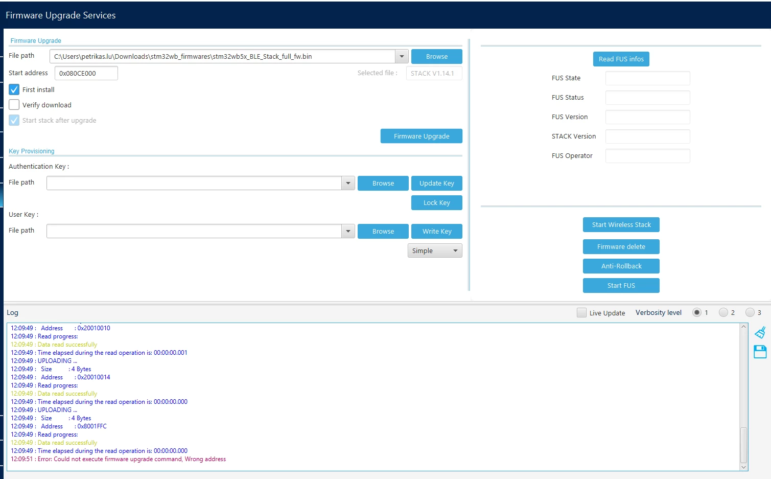

_legacyfs_online_stmicro_images_0693W00000bixPLQAY.png4.Select stm32wb5x_BLE_Stack_full_fw.bin from the package that I have recently downloaded
5.Set the offset to 0x0805A000
6.Tick "First install" and "Start stack after upgrade"
_legacyfs_online_stmicro_images_0693W00000bixQEQAY.png7.Click "Firmware Upgrade"
8.After Firmware upgrade is successfull I read FUS infos again to confirm if stack version has been updated. However, it still says v.1.14.1.1 not sure why
