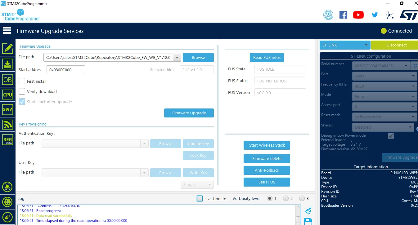

Hello Houda,

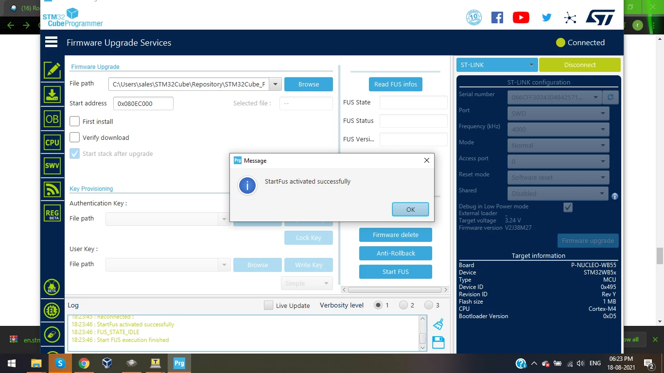

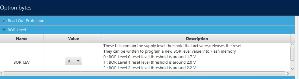

As per your suggestion i started FUS
after that i tried to delete so i am facing same issue, another thing we need to observe here that FUS version still showing v0.0.0.0
Ra.1
Ra.1Author
Aug 18, 2021 12:42 PM UTC
Hello Remi QUINTIN,
1) while going to option bytes it shows that check the flash protection, and another thing i am not able to connect ST-link utility
2) 8 months back i have purchased

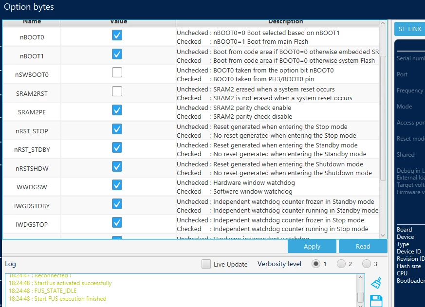

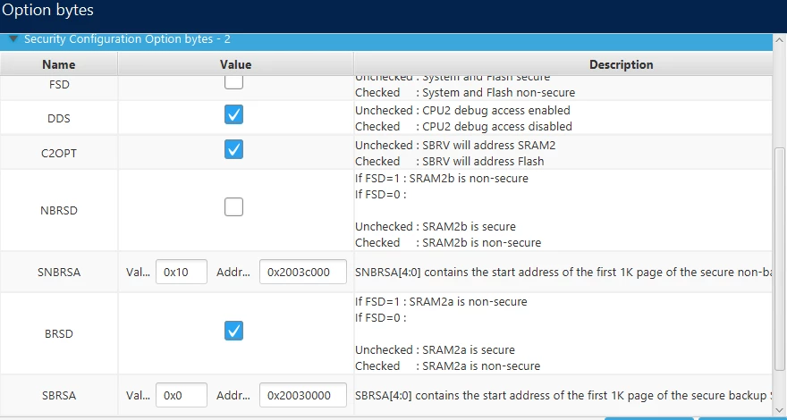

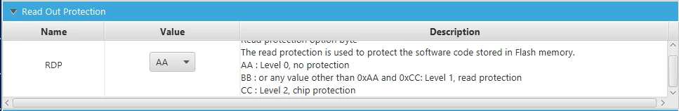

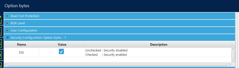

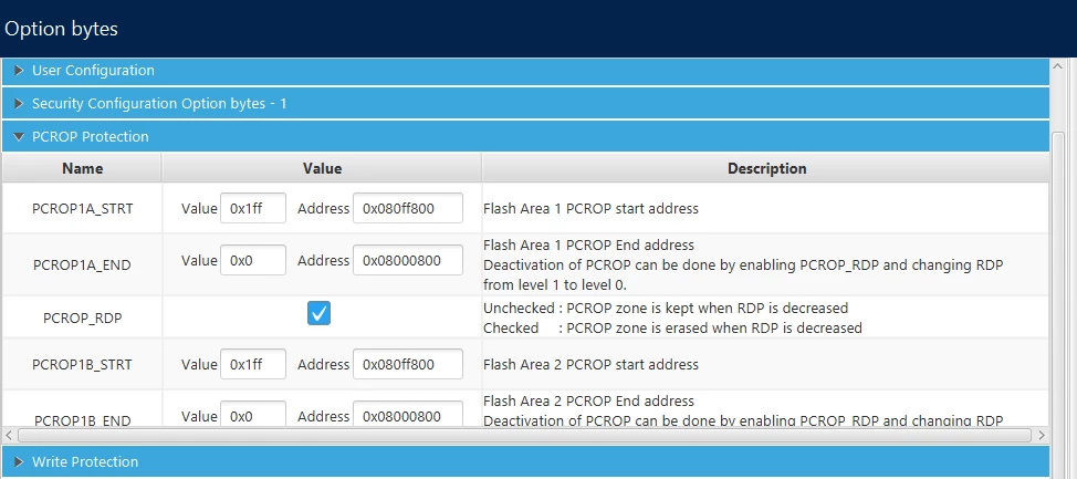

Hello all,
these are for the reference
0693W00000Dph1VQAR.png0693W00000DpgzLQAR.png0693W00000Dph1LQAR.png0693W00000Dph1BQAR.png0693W00000Dph16QAB.png0693W00000Dph11QAB.png

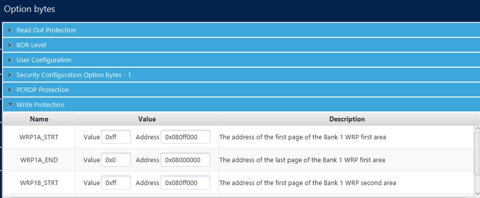

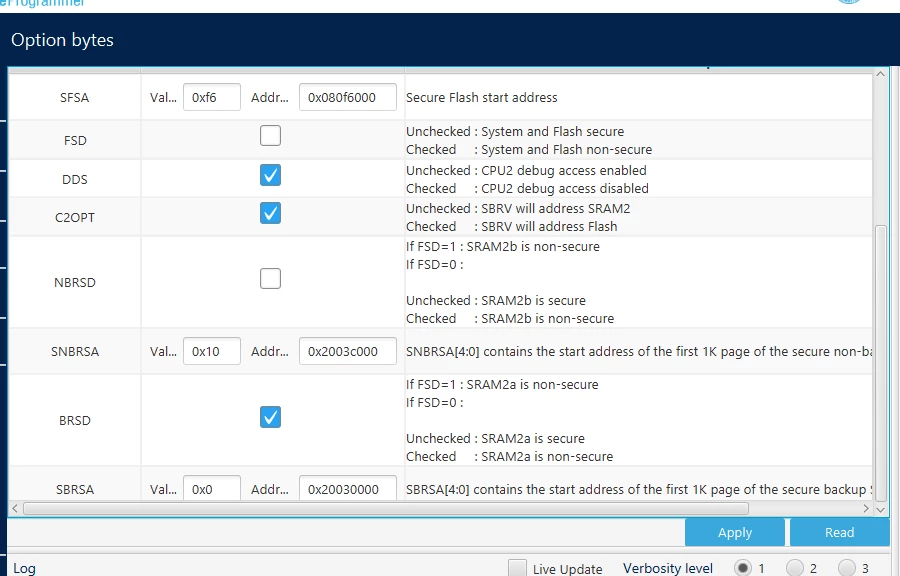

Remi QUINTIN
Aug 18, 2021 12:53 PM UTC
Thanks for the download but I am just missing the 2 most important ones: SFSA and SBRV which are part of the security configuration. They do not appear on the first screenshot.

Houda GHABRI
Aug 18, 2021 2:24 PM UTC
Hi @Ra.1​
Yes the FUS seems to be upgraded successfully according to your traces so I eliminate a FUS version issue.
I will check with our experts what can be the reason to have this issue and come back to you with updates very soon.

Ra.1
Ra.1Author
Aug 20, 2021 4:10 AM UTC
i have another STM32WB DK which is working so i connected and observed that the value of SFSA and SBRSA is differ from the current (which has issue) DK.
so i tried to change the value so it gave the error "option byte program failure"
Remi QUINTIN
Aug 20, 2021 7:03 AM UTC
The SBRV value is still missing but I have enough info with SFSA = 0xF6 to say that the FUS has never been updated on this board as this address is the one of the very first FUS version v0.5.3. At the opposite, the pre-installed FW has indeed been deleted.
From this constatation, I can say that you will never be able to upgrade the FW with this FUS version. You need first to upgrade it to FUS v1.0.2 first and then to the latest version v1.2.
Then you will be able to program the FW stack on your board.
So we have to focus first on the upgrade to FUS V1.0.2.
Remi QUINTIN
Aug 20, 2021 7:10 AM UTC
Looking at the latest WB FW package v1.12, we should be able to upgrade the FUS in one row, just using the stm32wb5x_FUS_fw_for_fus_0_5_3.bin file.
  • Firmware Upgrade Services (FUS)
  • This binary is the utility to flash the Wireless Coprocessor Binaries.
  • Latest version of the FUS to upgrade board containing only FUS v0.5.3
So try to update your board with this binary file. Then you should have the SFSA value set to 0xF4. Then program the RF stack you need on your board. It should work.

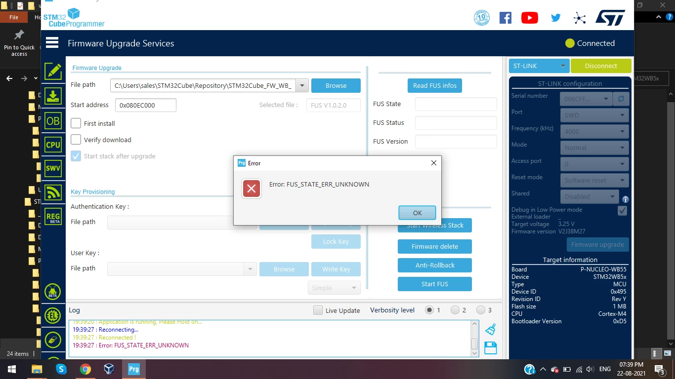

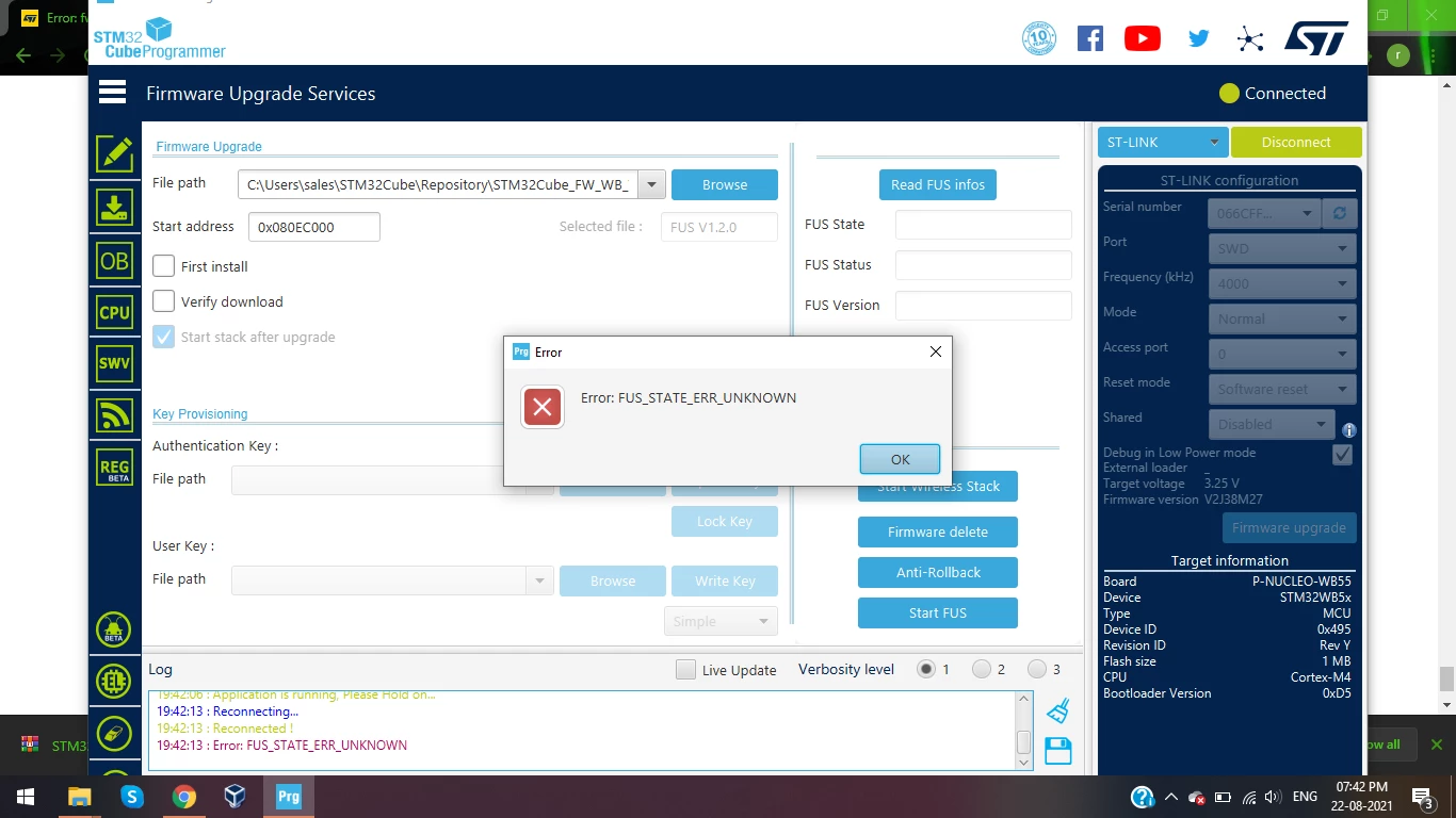

Ra.1
Ra.1Author
Aug 22, 2021 2:19 PM UTC
sorry for late response, i tried with both the files which you have suggested stm32wb5x_FUS_fw_for_fus_0_5_3.bin, stm32wb5x_FUS_fw_1_0_2.bin
but getting same error as shown in below screen shot
0693W00000Dq1d0QAB.png0693W00000Dq1bdQAB.png 19:34:15 : Old Firmware delete ...

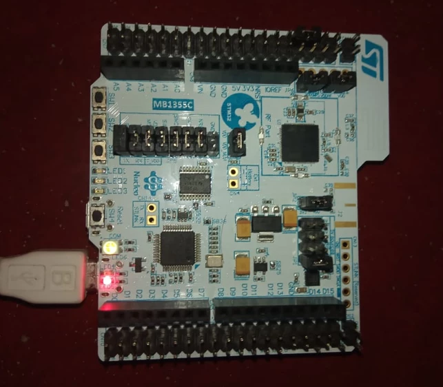

just for confirmation check my board connections as follows
