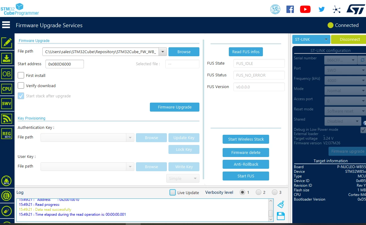

Ra.1
Ra.1Author
Aug 13, 2021 10:22 AM UTC
Hello Imen,
thank you so much for your quick response
As per your suggestion i updated the STM32CubeProgrammer and run it in cmd prompt so get same error..!!
even in software it shows
fus state: fus_idle
fus status : fus_no_error
fus version : v0.0.0.0

Houda GHABRI
Aug 18, 2021 10:21 AM UTC
Hi @Ra.1​ ,
Sorry for the delay.

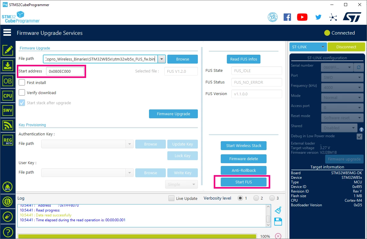

According to your screenshot your FUS is not started (fus version : v0.0.0.0).
You need to start it using "Start FUS " button because M0 cortex can either operate the FUS or the FW not both in same time.
So you need to :
  • upgrade to the last FUS version v1.2.0 , you can find it under STM32Cube_FW_WB_V1.12.0RC1\Projects\STM32WB_Copro_Wireless_Binaries\STM32WB5xWB FW\stm32wb5x_FUS_fw.bin please be sure to put the correct address 0x080EC000 (address may change please read the release note for more information )
  • Start the FUS then do the FW delete.
Do not hesitate to contact me if the issue still exist.
