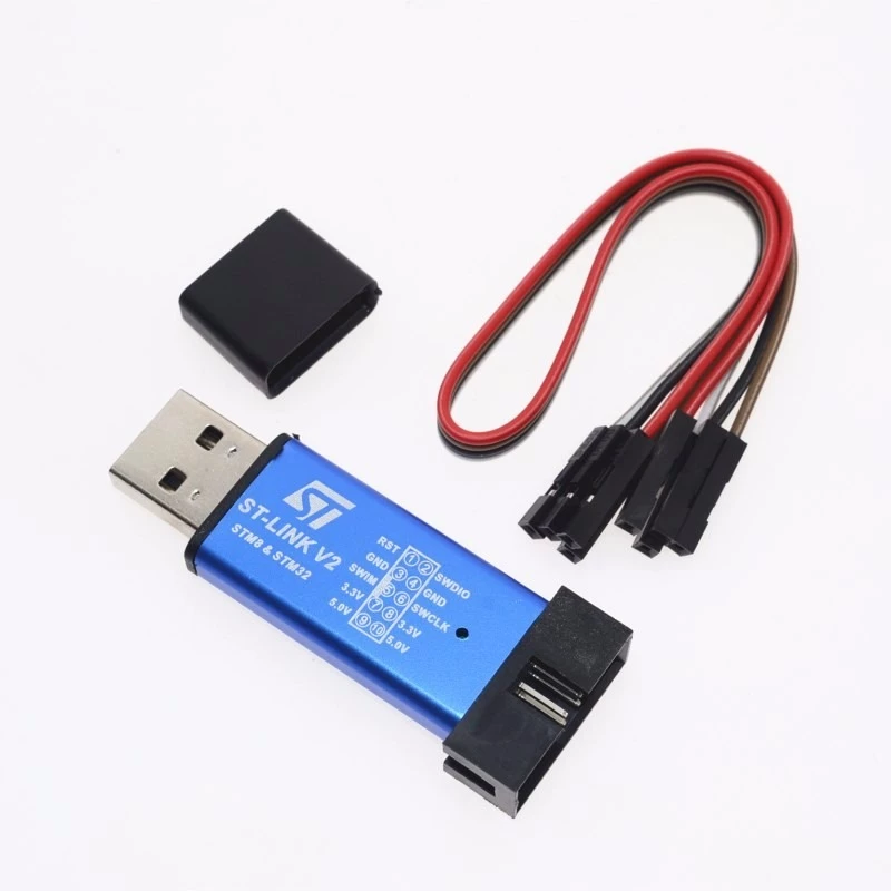

  2. I need a ST-LINK devide like for example:0690X0000060PK9QAM.jpgI have already connected the expansion board on top of the NUCLEO board and this board through USB . Are not both boards ready to be used? I am a bit lost in this. Where can I find information about how is the expansion board connected to the ST-LINK?. All additional basic information you can provide to me is really appreciated (I need to learn from scratch).

That's a clone ST-LINK, but should work, you'd need to solder a header on to JP6 of the USI shield if it doesn't have one. You'll need to mass-erase the part as USI uses read-out protection.

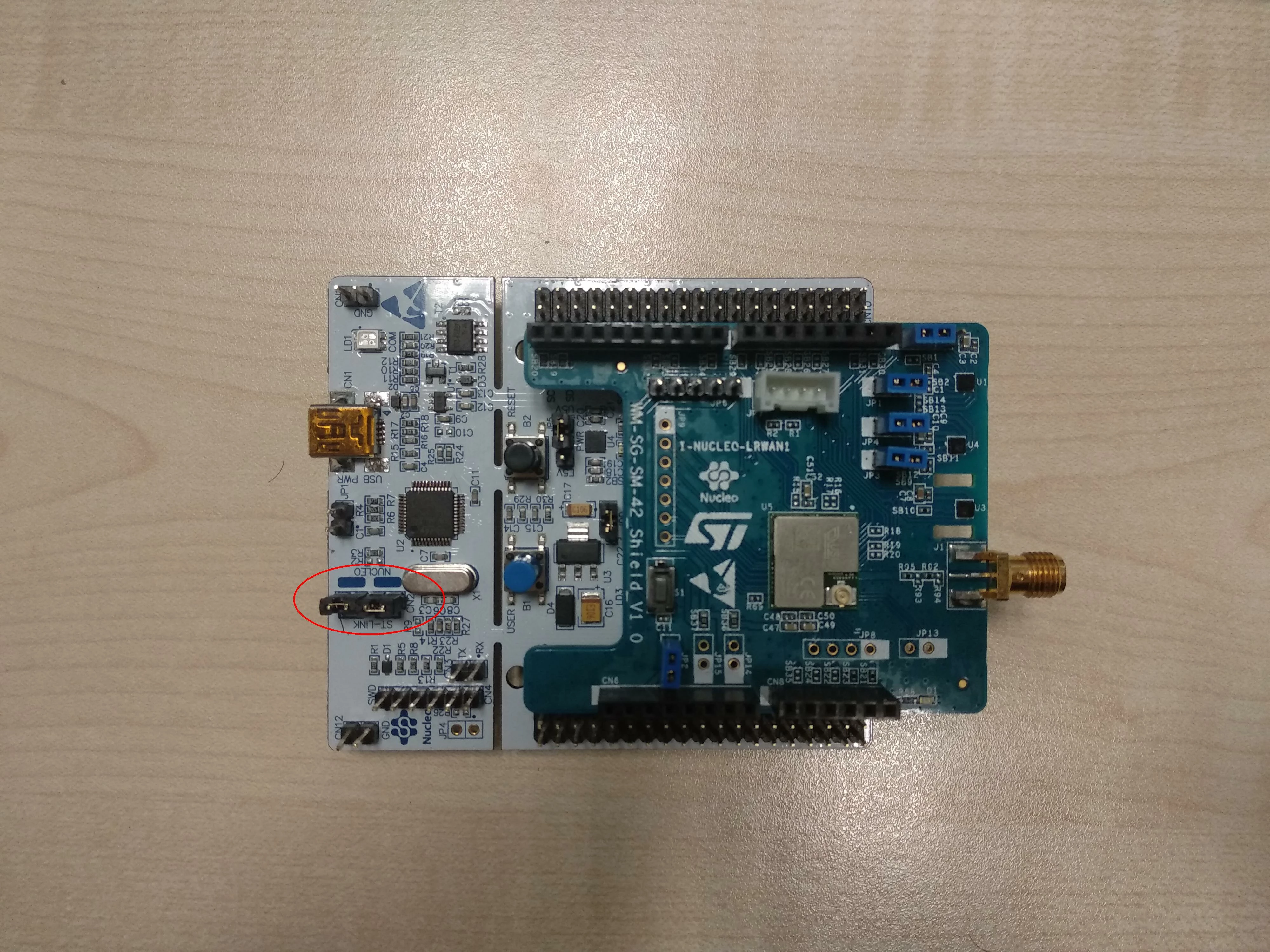

So if I want to use the combination of both boards, do I need to stablish a ST-Link communication between them using the ST-Link pings (CN2)? If so, how should I connect them to the I-NUCLEO-LRWAN1?
Thanks again!
Tesla DeLorean
Guru
Aug 1, 2018 7:59 AM UTC
You'd want to remove those jumpers, and then wire up the CN4 SWD connector to the USI JP6 connector
JP6 Header
1 3V3
2 SWCLK
3 GND
4 SWDIO
5 NRST
CN4
1 VTARGET
2 SWCLK
3 GND
4 SWDIO
5 NRST
6 SWO
You shouldn't need to connect for power.
I'd opt for the stand-alone ST-LINK, it would make debugging both targets easier.

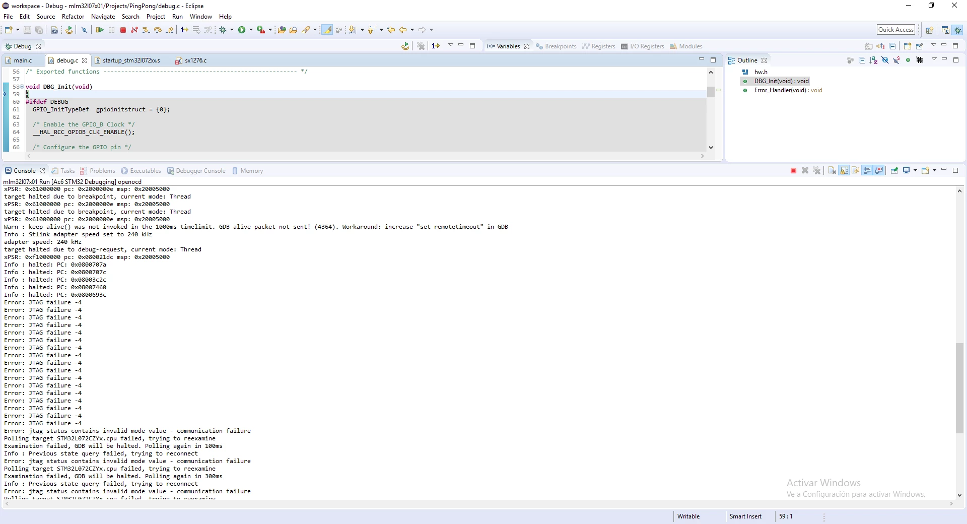

Thank you for your help. By the way, I have seen an example in the Cube software called AT_Master which sends the AT commands to the USI module, which is connected to the radio module. Do you think I can implement the PingPong starting with that example? I would prefer to do that instead if it is possible.
Anyways, I though that the PingPong example was working fine on the B-L072Z-LRWAN1 but it is not. I am getting this in the UART terminal:
I did not modify any code of the example (just added some #includes) and the 'Ping' message is not done. I am just compiling and flashing the example into the board. When I try to debug to see what happens I get this error:
I added some batteries to the board in case it was due to power issues, but does not work either. What can cause this error?
PS: I am working on a Virtual Machine (Windows 10 as guest)
