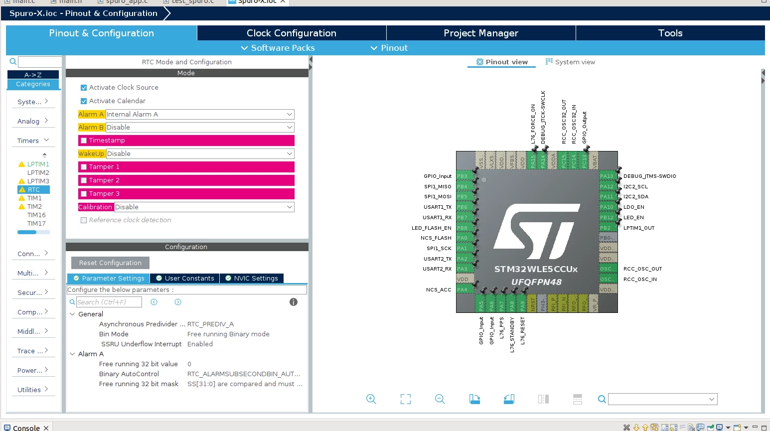

0693W00000QNdk8QAD.pngOriginal IOC File working.

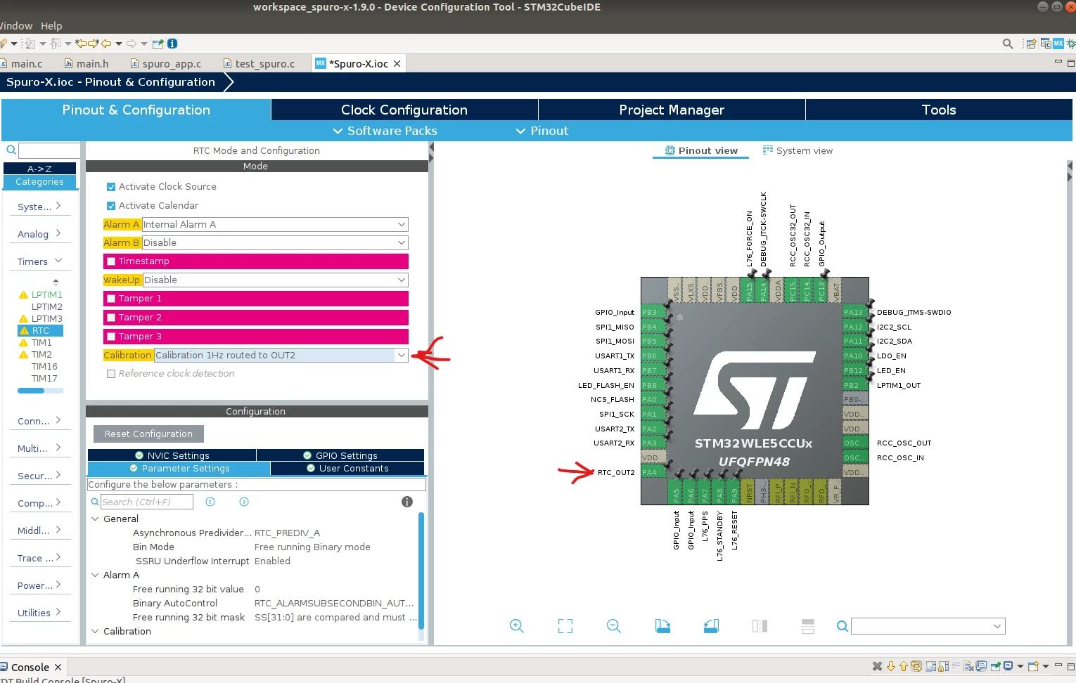

0693W00000QNdkIQAT.pngThen I enable RTC Calibration output on PA4

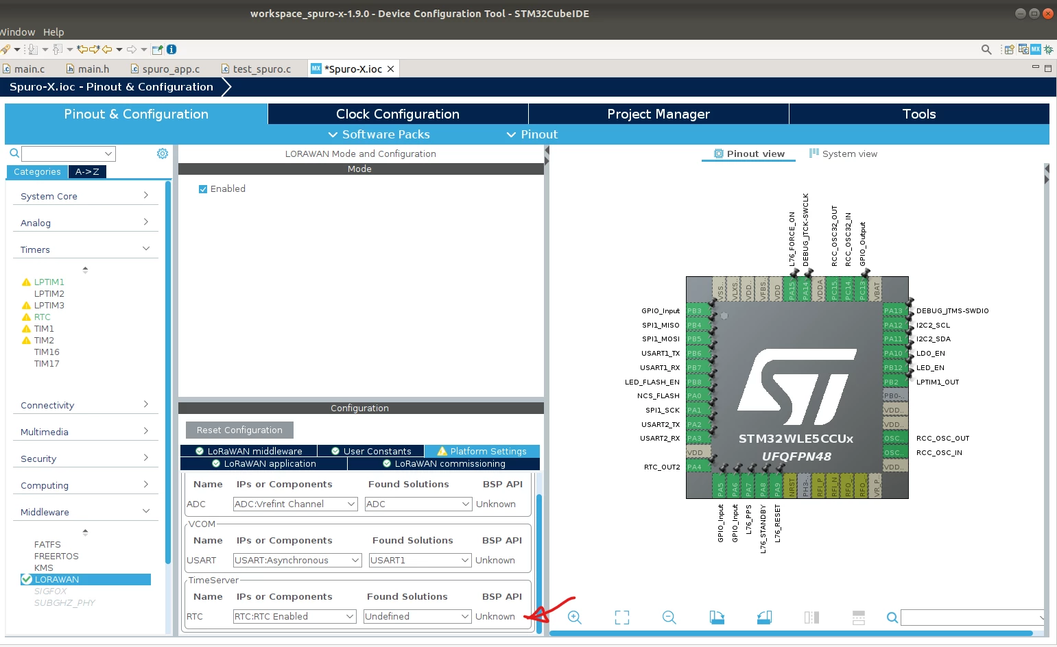

0693W00000QNdkSQAT.pngThis silently makes lorawan settings glitch. Very easy to miss.
If I change "unknown" back to "RTC", then everything works as expected.

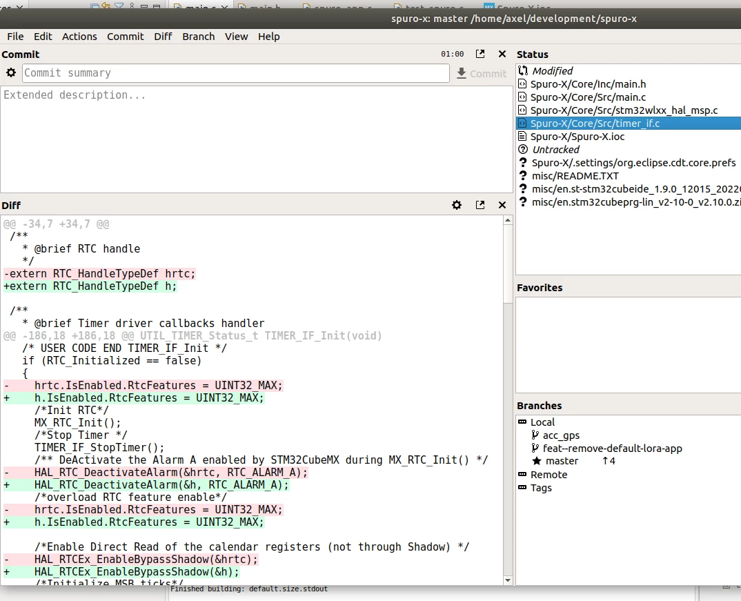

But if code is generated now, then we will get the AfterGlitch.ioc file (attached) and and we have the issue of hrtc renamed to h (among other things), see image below.
