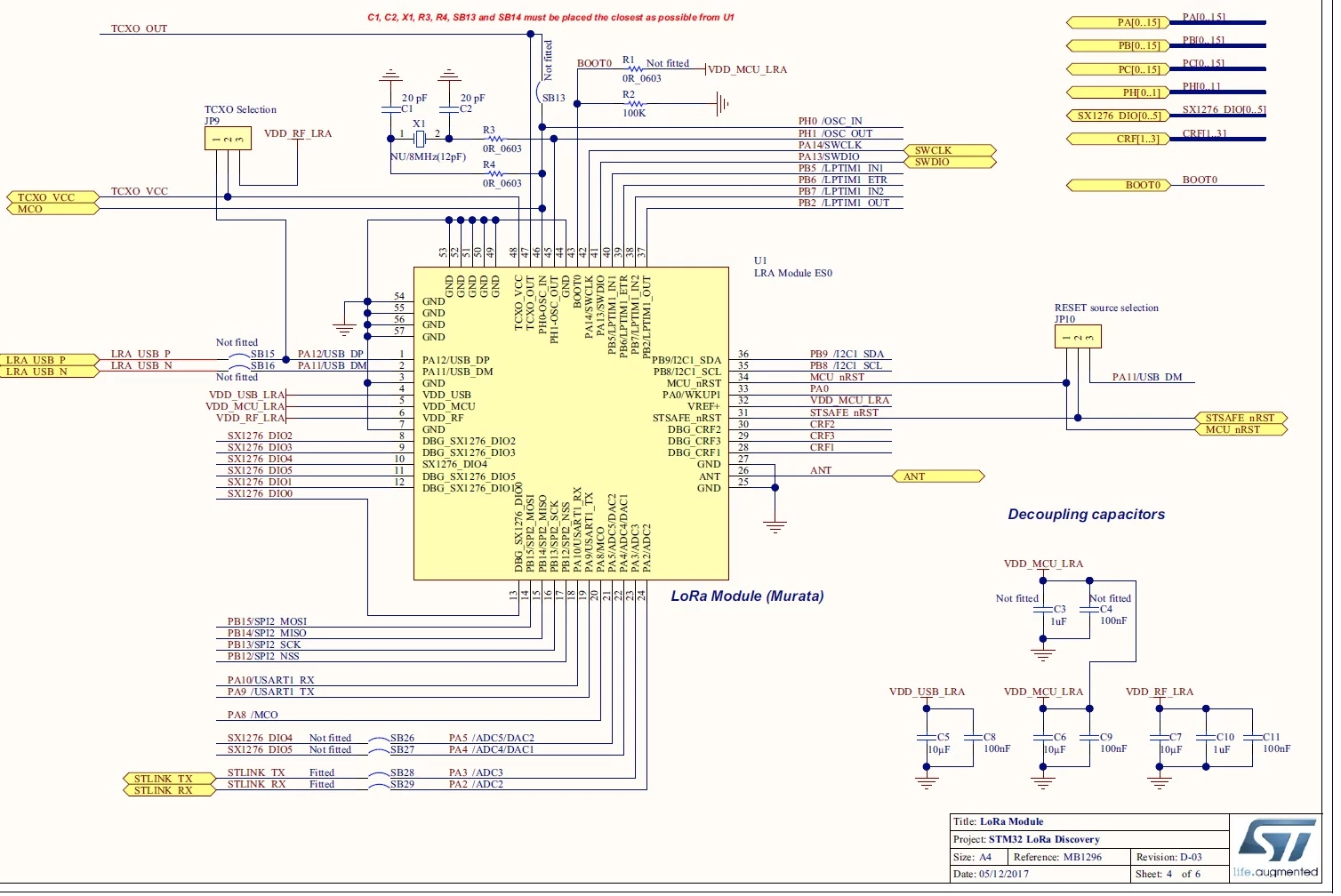

Cant power B-L072Z-LRWAN1 with battery
We recently received our B-L072Z-LRWAN1 but are not able to run the program while batteries are plugged in. In the datasheet it says that we need to remove SB37 to accomplish this. But then I cant program it anymore? How can I use the board with battery only and still be able to program it?

I solved it. I removed the bridge at SB37 and inserted a jumper. So when the jumper is off it can be charged by the batteries but you cant debug it. When the jumper is inserted it is working as normal.

Oct 30, 2018 11:49 AM UTC
there is no external pull up on the nRst line in the schematic,
there must be an internal pullup..
MCU_nRst is a pull down button, requiring a pullup somewhere...
could you add a resistor to JP10 pin 1 ? to pull up the MCU_nRst line...

Ok I figured it out.
Even though I thought I had removed sb37 it was still making contact. :flushed_face: Although in the doc it seems to imply that the bridge removal is more to save battery power. But it apears that with the bridge in place, only link usb power or vin will work.
Thanks for the help
Andrew Neil
Oct 30, 2018 12:45 PM UTC
The doc does say that the reason for removing SB37 - ie, for disconnecting the RESET line from the on-board ST-Link - is because the ST-Link doesn't get powered from the battery.
Therefore, with the link in place, the un-powered ST-Link will be holding the RESET line.
