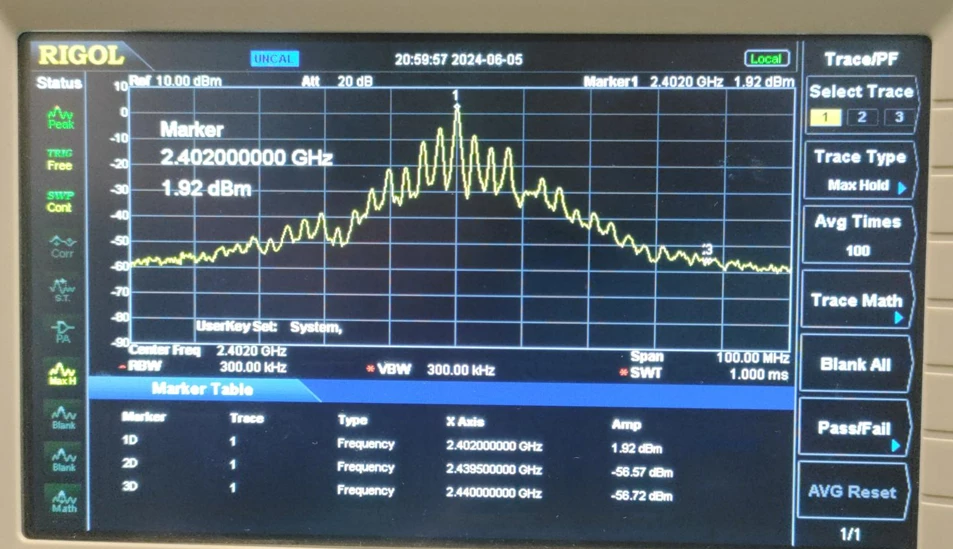

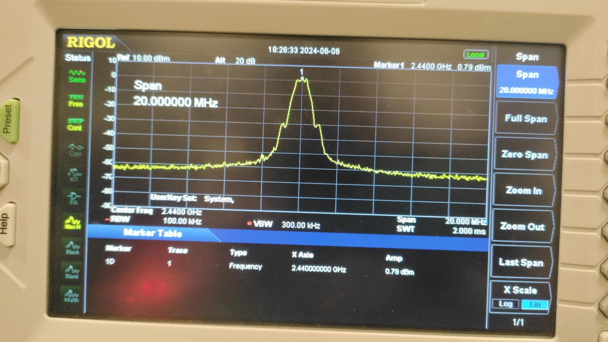

Using custom firmware on an Inhouse designed board, the BLE output seems unmodulated as shown in the picture attached. But using the Transparent mode firmware on a Nucleo-Board (controlled via the Cube monitorRF) the modulation seems good (also attached)

1. Is there any option to tune the modulation further other than default ?

This picture shows the sidebands when tx is ON on the 1st channel.
This picture shows there are no sidebands on the Nucleo Board which are coming in the above pic.

Using SW setting you can tune HSE frequency and TX output power, but then it's matter of filtering, antenna and antenna matching on your custom board.

The porting of the code was tried but we cannot control it via the CUBEMonitorRF app.
We used the same code and generated the TX signal manually at a fixed frequency of 2402MHz, but we could still see the sidelobes in the spectrum analyzer whereas it does not appear on the Nucleo-Dev kit.

But the root cause here is different - as you were able to see using the fixed frequency signal you generated - you need to fit your RF filtering and matching to your HW board, no SW modification will fix it.

Well if you see in that way, we are testing at the RF pin of the controller with no further connections. If at that point we observe the side lobes, impedance matching circuit is not gonna help neither a filter.
Now if we use a Nucleo Dev board (MB1355C), we do not see any sidelobes if we probe at the RF pin of the controller.

HSE frequency stability at room temperature is tested for accuracy. Its a +10ppm part. Have tried to tune in the HSEGMC down and up. It only shifts the center frequency and does not helps with the Side lobes coming.
