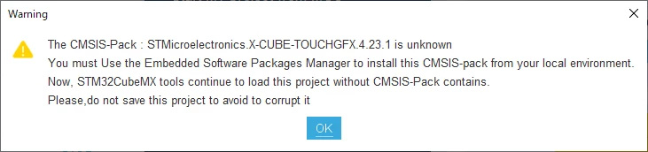

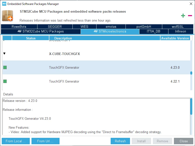

I have one problem on TOUCH GFX 4.23.1 and Cube.MX 6.10.0.
I created a STM32F746G_DISCO project with GFX, and generate codes without any modifying.
Next, open STM32F746G_DISCO.ioc with Cube.MX, found following warning.
I searched new X-CUBE-TOUCHGFX package, but latest version in Cube.MX is 4.23.0.
How can I clear this waring?
EmbDev
Senior
Mar 4, 2024 7:18 AM UTC
Here the exact same problem. Downloaded the latest version of CubeMx (6.10) and cannot find TouchGFX 4.23.1
How can this be solved?

Graduate II
Mar 4, 2024 5:54 PM UTC
Hello
Check the initial message of this thread:
Attention : If X-CUBE-TOUCHGFX 4.23.1 is not available in STM32CubeMX software yet, please navigate to "Help > Manage embedded software packages > STMicroelectronics > X-CUBE-TOUCHGFX". Then click on "From Local ..." and navigate to the x-cube-touchgfx-4-23-1.zip file to install the new pack inside STM32CubeMX.
So you must manually install the latest TouchGFX version to the CubeMX. Also here discussed about same problem
https://community.st.com/t5/stm32-mcus-touchgfx-and-gui/can-t-open-ioc-the-cmsis-pack/td-p/635622
hope this helps.

Explorer
Mar 5, 2024 1:45 AM UTC
Hi JTP,
Thank you for your reply.
I tried your suggestion, and installed GFX 4.23.1 to Cube.MX successfully.
Thanks!!
