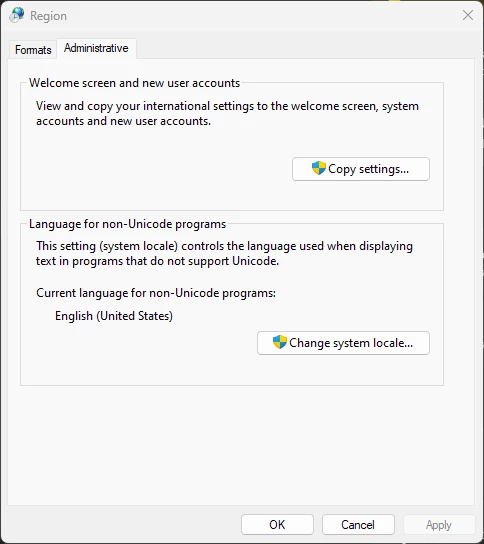

NSeba
Jun 20, 2023 2:04 AM UTC
I installed using the mentioned steps.
Mine is a clean installation after uninstalling all previous versions.
I tried to load a demo application directly from TouchGFX into my STM32H747I-DISCO and it shows error like this.

Osman SOYKURT
Jun 20, 2023 11:44 AM UTC
Hello @NSeba ,
Does your app work on previous versions of Designer?
Your issue looks a lot like this one. As I can see there's a conversion error from UTF-16LE to IBM437 characters. Is your computer in an other language than English? If it's the case, trying the solution suggested in the thread could be a help until we find a solution which doesn't require much user side.
/Osman
NSeba
Jun 20, 2023 12:59 PM UTC
My applications were working perfectly in version 4.21.1.
This issue started after I upgraded to 4.21.4. The issue persisted after I downgraded back to 4.21.1
Then I installed 4.22.0 from ST website and it also doesn't work.
My system language is English only. Do I need to make any changes in locale ?
I cannot reinstall windows as there are other licensed software.

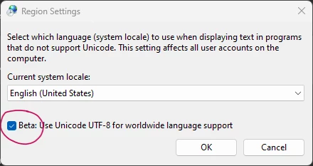

NSeba
Jun 20, 2023 3:31 PM UTC
Update: Mine started working after I made UTF-8 system wide.
I don't know what trouble it is going to make with other applications
Osman SOYKURT
Jun 21, 2023 9:01 AM UTC
@NSeba good to hear you have a solution to your issue, thank you for sharing. We'll see what we can do for this issue.

Hi @Osman SOYKURT
I recently updated to TouchGFX 4.22.0. When I try to update/run my project I get the"Failed to load native freetype library" error. I am still able to run the project on the previous version 4.21.4 I am running TouchGFX in the Windows 10 Virtual Machine setting. Is there any fix for this? Do we know why it's happening? Please help!

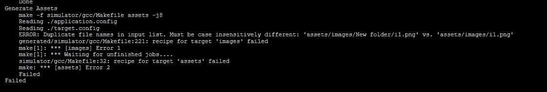

Have I found another bug?
Cant create animated images. It says I have duplicate name images. But I dont.

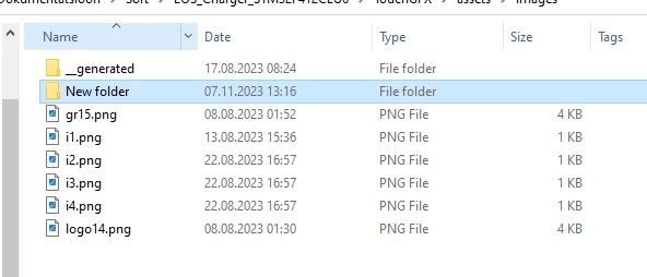

Source folder:
It is not even possible to have two same name images in same directory.
HRidd.2
Nov 10, 2023 12:21 AM UTC
Hey @tarmogr , this actually isn't a bug! TouchGFX doesn't like it when you have two images named the same, even if they're in different directories. If you look at the output it's complaining you have an identically named image "i1.png" in "assets/images" and "assets/images/New Folder"
Nov 10, 2023 7:56 AM UTC
Hey. No as you can see from the screenshots, the images are all in same directory and have different names. It is the touchgfx UI that does not update the paths and names correctly. I messed with it long time deleting and relocating and renaming files. Finally got it working. I had to delete some files in order to make touchgfx update the paths.
However I cant reproduce the error anymore. Maybe I just had to restart the program.
