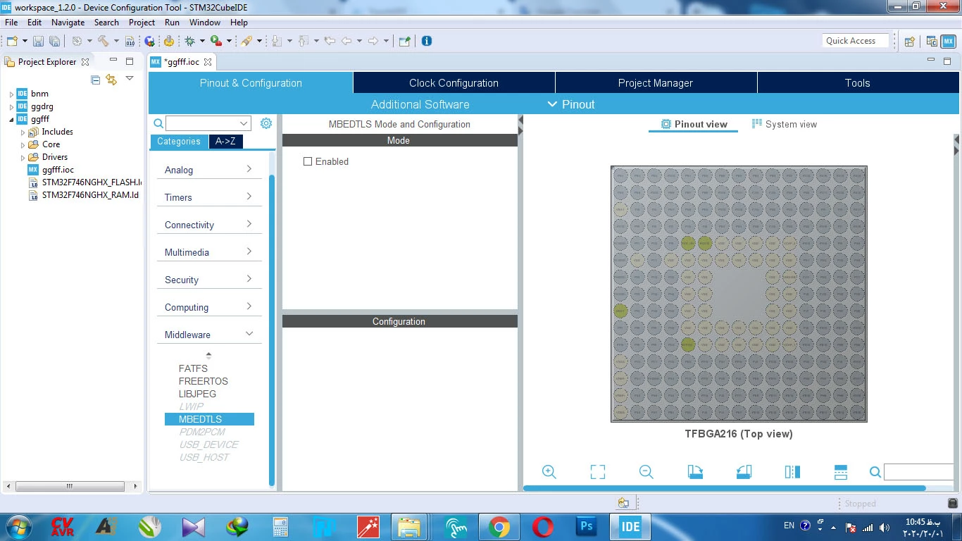

Where's the TouchGFX settings in the new version of STMcubeMX5.5.0?
Getting started with STMcubeIDE version 1.2 I had problems with not having access to the graphics settings to configure TouchGFX.
In this way I upgraded STMcubeMX to version 5.5.0. And I also installed the X-Cube-TouchGFX on it.
But on both STMcubeMX and STMcubeIDE I still have trouble accessing graphics settings in Middle ware.

You might want to take a look at the sticky in the top of the forums:
https://community.st.com/s/question/0D50X0000BwjU6pSQE/official-release-xcubetouchgfx-v4130
The TouchGFX have been made an additional software - X-Cube now. There's a nice guide on how to install an configure it now

Thanks for your response
