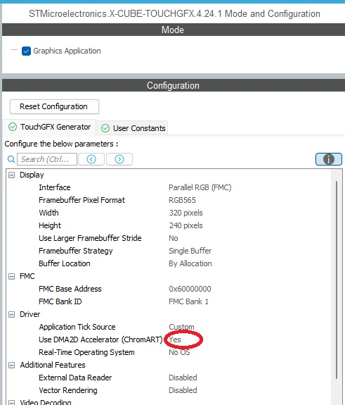

That is odd. I'm back to some sort of buffering issue. TouchGFX can use DMA2D to fetch the bitmap in extflash and copy it to the framebuffer. I can see you have that turned off in your TouchGFX configuration. What happens if you turn that on?

Are you referring to changing this parameter?

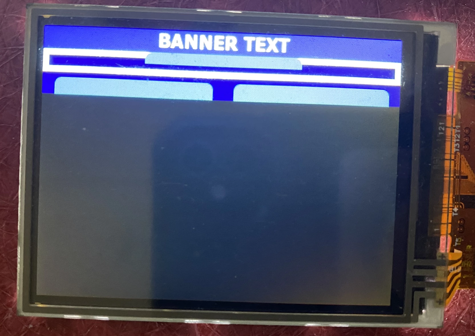

Without changing anything else, this happens:
I hadn't seen this issue before, but the reason I had been keeping that setting off was because when I turned it on, I was getting this: Trying to setup DMA2D with TouchGFX and an FMC con... - STMicroelectronics Community
Jan 31, 2025 2:02 PM UTC
Yes, that is the setting I was referring to. You should ensure that DMA2D is enabled in your initialization code. The settings don't matter, TouchGFX will take care of this, as well as setting up transfers to the frame buffer.
You should not reconfigure DMA2D. If you want to use DMA to transfer data to the FMC, you should use plain DMA.

Ah, yes that fixed the issue with the screen only partially drawing. I'll get normal DMA setup for my FMC transfers. No artifacts either, for the moment.

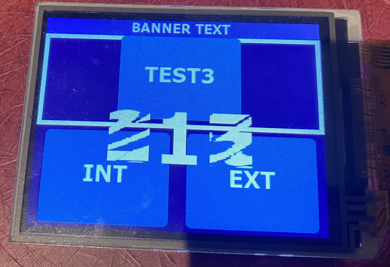

Well, I should have tested the larger font size (Size 80, Verdana Bold) because that still has the problem I mentioned before:
When I disable ChromArt under the TouchGFX settings these weird character distortions go away.
Feb 3, 2025 9:24 AM UTC
Is that a static text or a number that increments? Are the artifacts consistent; in this case the 1 is correct, are all 1s correct? Are all 2s broken in exactly the same way?
Be aware that for normal DMA you may run into an issue with the number of blocks that can be transferred in one go. I so not recall if the DMA on L4 supports this, but some DMAs have a linked list mode to handle this, otherwise you can handle that manually in a callback.
Another option is to try to switch frame buffer strategy to partial frame buffer. This transfers a number of blocks of a predefined size to update the memory in the display. You can manually set the size and number of blocks, so you can limit the size to what you can handle in one transfer. At the same time, you will save some RAM since the normal framebuffer is replaced by the blocks.
The project for STM32U575 with RVA35 display module that ships with the TouchGFX designer is set up in this manner and uses DMA for FMC transfers, if you would like some inspiration.

The text is dynamic - I was updating it with every tick, mainly to force invalidations for those buttons and "stress test" the system. I just changed my code to increment the counter manually so that I could go through each digit manually.
void ArtifactTestScreenView::vfYesButton() { // Lower Left button
	textPrompt.invalidate();
void ArtifactTestScreenView::vfNoButton() {	// Lower right button
	counter++;
	Unicode::snprintf(textPromptBuffer, TEXTPROMPT_SIZE, "%d", counter);
The following digits are scrambled (and always in the same way as far as I can tell): 2, 3, 5, 6, 7, 9. The rest of the numbers seem to be ok (0, 1, 4, 8). I've included a video so that you can see it happen as I press the buttons (sorry the video is turned sideways)
What is interesting is that as it repaints the portion of the digit for the button depressed image, it seems to do it correctly, but as soon as I release the button, it goes back to garbage.
In regard to using normal DMA, it seems to be working ok - I'm doing the transfer in two equal blocks for the whole screen, as at the moment I'm just transferring the entire screen, which seems to be working, the previous complaint non-withstanding:

You could use a transfer complete interrupt on the DMA to increase performance by moving the update code to a dedicated screen transfer function that can take a variable to control which half of the pixels to transfer. That would free up some CPU cycles. But I guess that is not the problem here.
I have two things I would like to investigate.
Try to modify your code from above to this:
	counter--;
	//invalidate();
	counter++;
	//invalidate();
First, it would be interesting to see if the scrambled letters are the same when counting up and counting down, I'm wondering whether it's the number being drawn incorrectly, or if there is somehow a part of the previous number remaining.
The lines with comments just invalidate the entire display, i wonder if that shows the entire number correctly.
