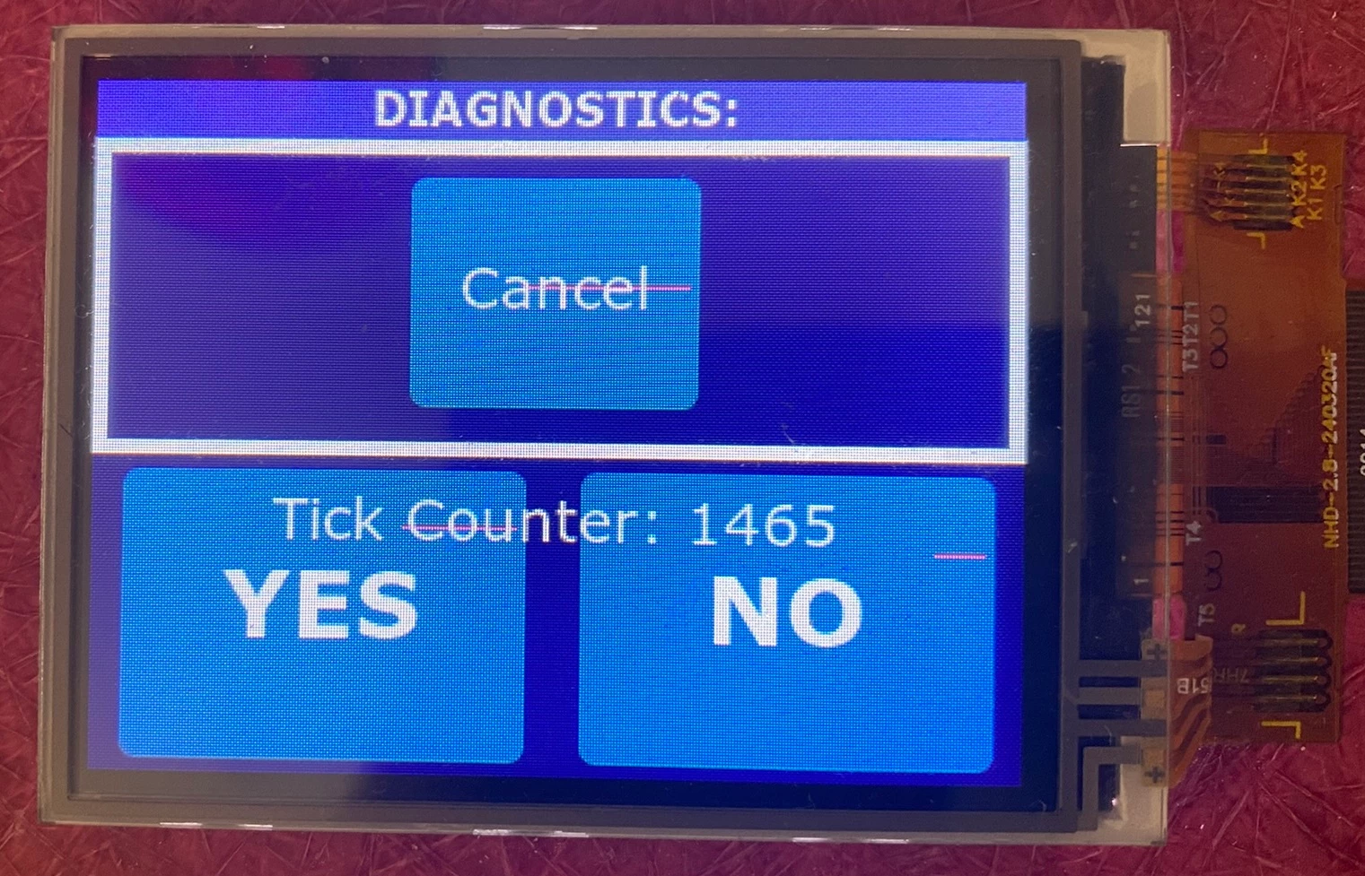

Hi Folks and Happy New Year!
I've been trying to track down a problem I'm having with my project for several months now. Essentially I'm getting these red-ish lines through portions of my buttons, but only when (I presume) they are drawn or redrawn - namely when the screen first loads, when they are pressed, or when as in this example, they have text drawn over them that updates.
In the case of the above picture, I've been able to get the lines to appear more consistently by layering some text over top of some of the buttons and then updating that text with each tick where it says "Tick Counter: xxxx". I managed to luck out and have it appear on the "Cancel" of the cancel button this time, though it probably only happens about 1 out of 10 times when the screen loads.
These lines have been appearing pretty consistently throughout my development on the project, and they seem (though I'm still not completely sure) to be happening regardless of my application code. The reason I say this is that I've commented out large portions of my application code and had them still appear. Frustratingly, they are not consistent. I can do a build, have them appear, and then insert a trivial line of code (even a NOP), and then they will disappear, only to reappear again after I add a few more lines.
This really seems to point to some sort of issue where I'm writing off the edge of an array or something (it seems that parts of my frame buffer are getting inadvertently overwritten? But then why just buttons? And why does it still happen when I essentially remove my application code?)

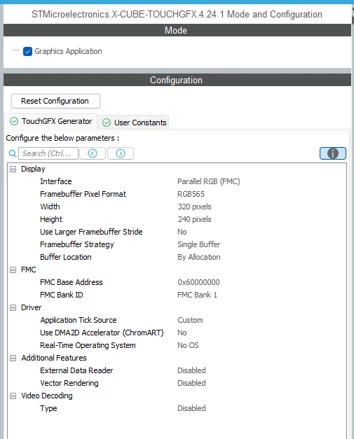

Details on my project:
MCU: STM32L496VGTN
Display: NHD-2.8-240320AF-CSXP-FT (ST7789 Controller) connected via FMC 16-bit parallel
External Flash: MT25QL128A using quad-spi with a custom loader
Firmware details: No RTOS (Bare Metal/super-loop)
Touch GFX Configuration:

  • My display has no TE line, so I'm updating it manually using a timer at 10Hz by calling Oswrappers::signalVSync(). I had this called in the timer callback function, but recently moved it into the main loop and the problem actually seemed to happen more consistently if anything.
  • I've confirmed that these artifacts are actually contained in the framebuffer, so its not some sort of electrical noise that's corrupting pixels as they're transmitted to the display.
Any tips, tricks, or advice towards debugging this issue would be greatly appreciated. You might say figuring this out has become my new year's resolution!

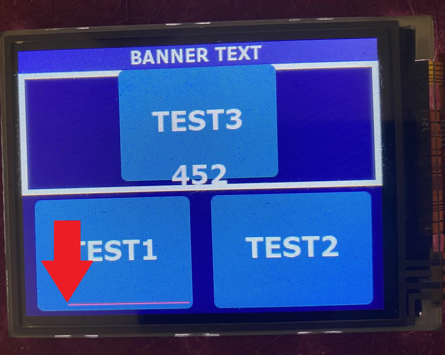

On additional thing I just noticed - if I set the button's alpha value to 254 or less, instead of 255, I don't seem to get the artifacts. I don't know how this factors into the problem, but figured I would mention it.

@JTP1 The bars do go away when I force everything onto the internal flash - unfortunately this doesn't mean much at the moment, as even small changes in unrelated code causes these lines to come and go from build to build. I certainly am open to examining my quadspi code further, though I'm not sure what I would be looking for.

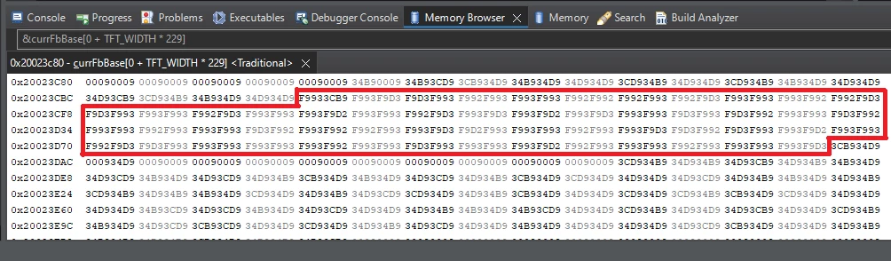

@mathiasmarkussen - I verified that the errant pixels were in the frame buffer by putting a breakpoint at the end of my transfer-framebuffer-to-display routine and then stepping the code until I saw one of the errors, and then reading out the frame buffer using the memory browser at the location that I see the artifact at:
For example:
Which I was able to determine with a little guessing to be at line 229 in my display, so in the memory browser it looks like:
0xF992 is a magenta color the same color I'm seeing on my display (and checking the rest of the colors before and after, they are also consistent with what I'm seeing on the display as well):

But what is interesting (or perhaps obvious) is that no matter what I use, I still get the artifacts, which further reinforces your point that the problem is occurring before we transfer the image, and that the transfer code isn't the issue. So then the next question I suppose would be what do I look at next? TouchGFX manages everything from a rendering perspective, so how would I be messing that up? Memory buffer overrun? Blowing my stack? These both seem unlikely since I've managed to comment out nearly all of my application code and still get the artifacts.
I did also try:
 for (int32_t i = 0; i < TFT_WIDTH*TFT_HEIGHT; i++) {
 	LCD_IO_WriteData(currFbBase[i]);
 	__DSB();
But that had seemingly no effect. Was that how I was supposed to use the __DSB() statement? (Thank you for your continued support on this!)
January 29, 2025
That was indeed what I meant regarding the __DSB() statement.
Looking at the picture in your original post, it seems that the errors span the text in the cancel button, but the error is not present in the pixels that belong to the text. To me, that indicates that the error is in the bitmap that is loaded from flash, and not the rendering.
That leaves DMA2D and the flash itself.
Do you have room in internal flash for one of you buttons? You could use the L8 format or RGB compression if needed. You could try that and see if you still get errors in the other buttons, but not the one in internal flash - that would indicate that the problem is with your external flash. I would guess it is a signal integrity issue rather than an error in your code.
You could also try to decrease the clock speed of the flash significantly and see if the errors still appear at a similar rate.

Thanks for that observation. I'm definitely getting artifacts over the buttons in where I invalidate that centrally located text area, but your absolutely right, the one I picked to show what I was seeing didn't have any text over it, although the whole purpose of the text area drawing over the buttons was to force invalidation and try and make the artifacts show up more consistently so that they could be easily detected when they happen.
Per your suggestion (as well as @JTP1's), I commented out the linker assignments that push all the graphical assets to the external flash:
 /*ExtFlashSection :
 	*(ExtFlashSection ExtFlashSection.*)
 	*(.gnu.linkonce.r.*)
 	. = ALIGN(0x4);
 } >QUADSPI
 FontFlashSection :
 	*(FontFlashSection FontFlashSection.*)
 	. = ALIGN(0x4);
 } >QUADSPI
 TextFlashSection :
 	*(TextFlashSection TextFlashSection.*)
 	. = ALIGN(0x4);
 } >QUADSPI*/
and the artifacts do go away.
