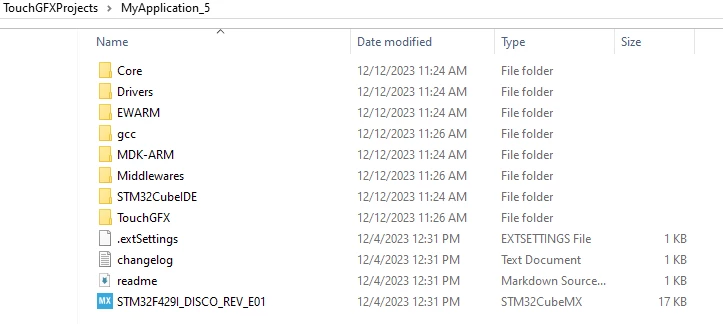

CubeIDE project through TouchGFX

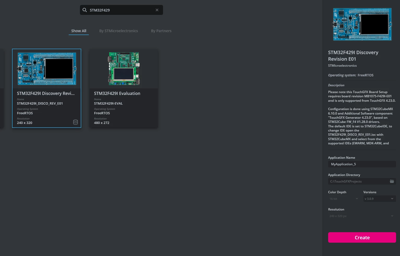

When creating a TouchGFX project with the STM32F429I-DISC1 board, I get the following:

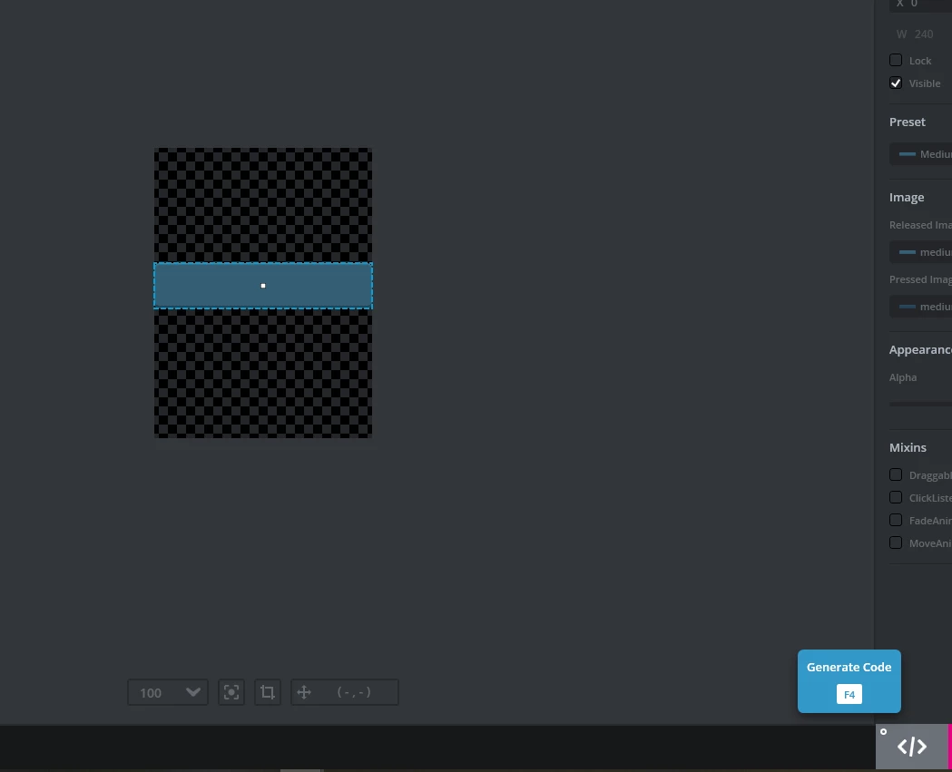

Adding a button and generating the code yields the following project docs:
Opening the generated cproject file imports the following project:
Notice that the IOC(MX) file has a different naming convention. The project seems to be the a older board revision.

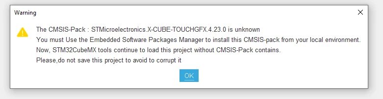

Note: I have seen and tried some online tutorials for adding the IOC file into the project, but this leaves the user needing to set up the .IOC file and I get the following message:
Not to mention several build errors.

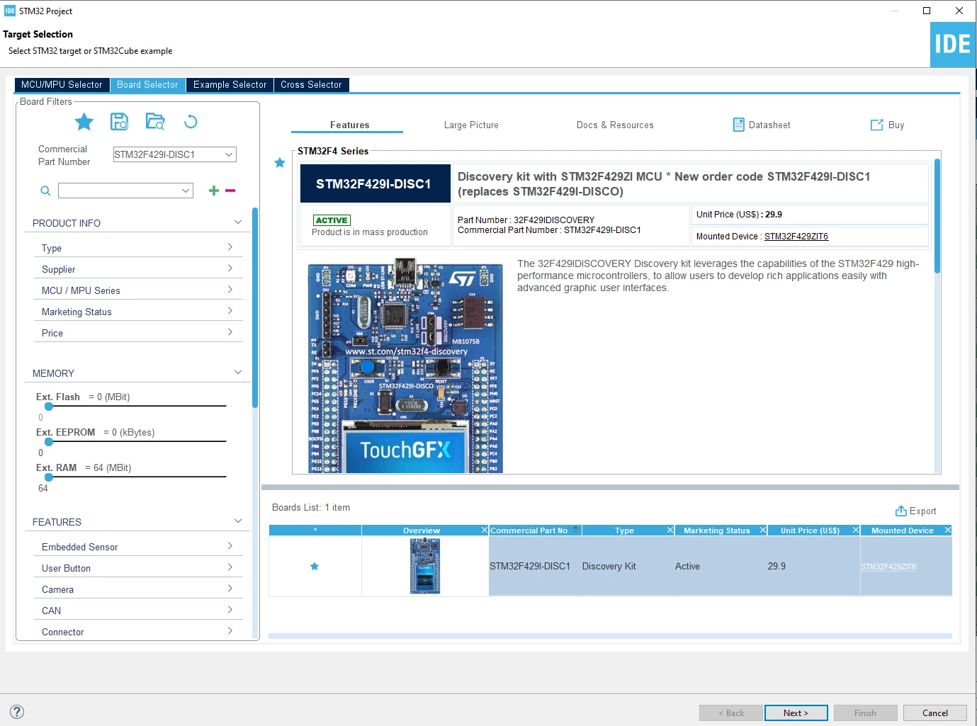

TouchGFX project through a CubeIDE project
Next I tried the other route: Generating GFX files via cubeIDE like so:

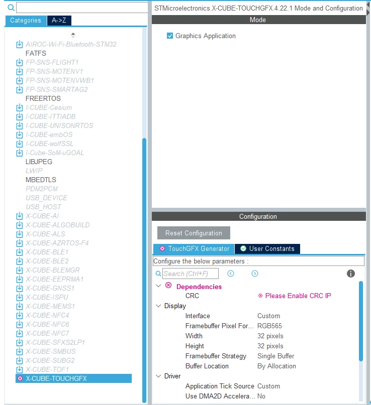

Generating the project and selecting no for default pin values, I find myself at the IOC file where I need to select the TouchGFX middleware layer manually.

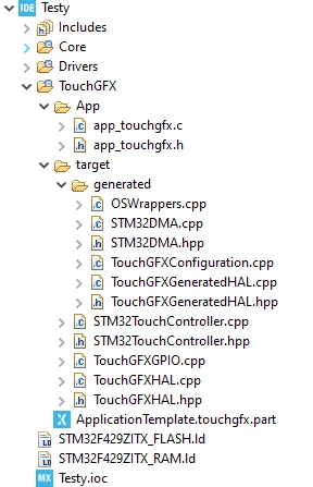

I would expect the IOC to know the dev kits screen size and configurations for buffers, ext RAM, etc. Nevertheless, after fixing the CRC enable issue, and screen size, and generating code, I get the following project:

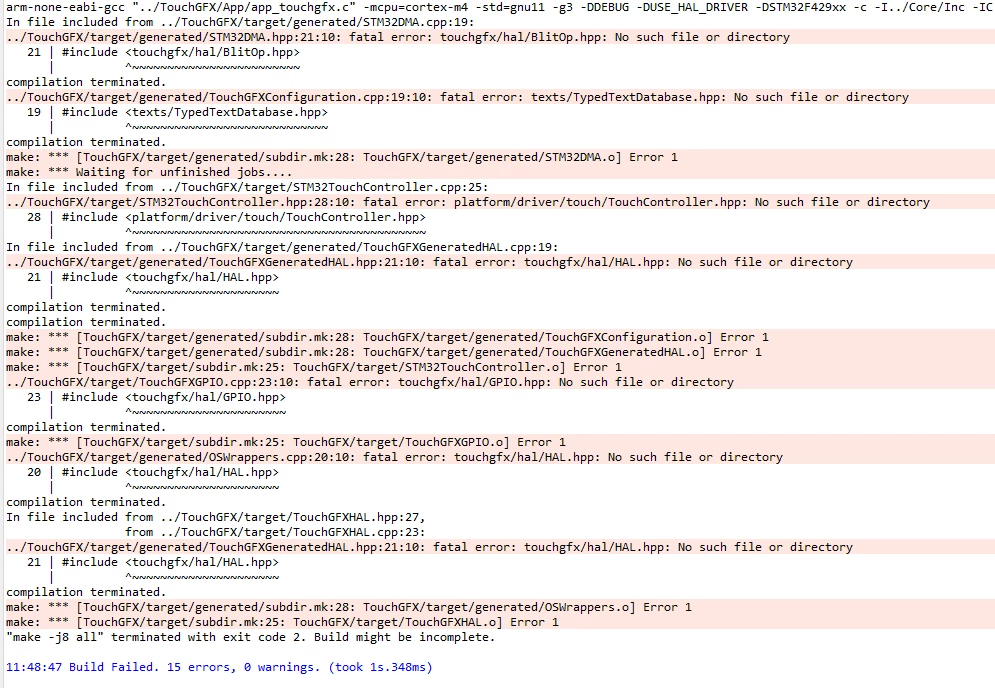

I select the "ApplicationTemplate.touchgfx.part" to open the TouchGFX app, select a blankUI canvas, add a button and click generate code withini TouchGFX.
Refreshing the code in the CubeIDE and building project yields errors right out of the gate:

I will start talking about the first approach which is the easiest one (Creating project through TouchGFX). TouchGFX board projects are made to make the creation of a GUI as simple as possible, so, all the configurations related to the board and the MCU are already done. This is not the case when you create a project through STM32CubeMX.
I can see that CubeMX has failed to download the X-CUBE-TOUCHGFX 4.23.0, please follow the instruction on this post to install it : https://community.st.com/t5/stm32-mcus-touch-gfx-and-gui/x-cube-touchgfx-4-23-0-is-out/td-p/616481

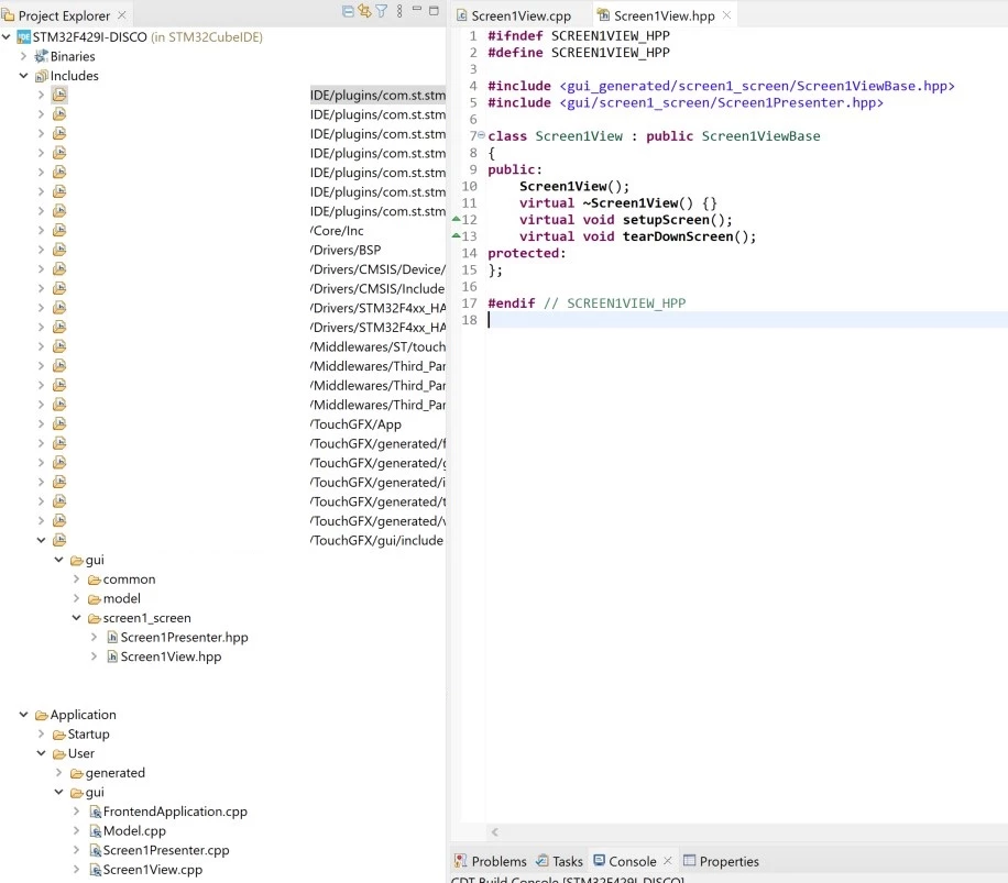

For creating a project, I suggest you to start your project from the TouchGFX Designer by choosing the board you are working on. Then, design your application and generate code. After that, navigate through the STM32CubeIDE and open the .cproject file. In the IDE, implement you logic behavior (code, functions,..) under Includes -> gui/Include -> gui -> "YourScreen" -> "YourScreen".hpp and Application -> User -> gui -> "YourScreen".cpp
CubeIDECubeIDE
Then, you can either go back to TouchGFX and press the "Program and Run Target", or build the project in STM32CubeIDE and then program your board using the built file (.hex file under Debug or Release folder) and STM32CubeProgrammer.

IHarg.1
IHarg.1Author
Dec 14, 2023 2:04 PM UTC

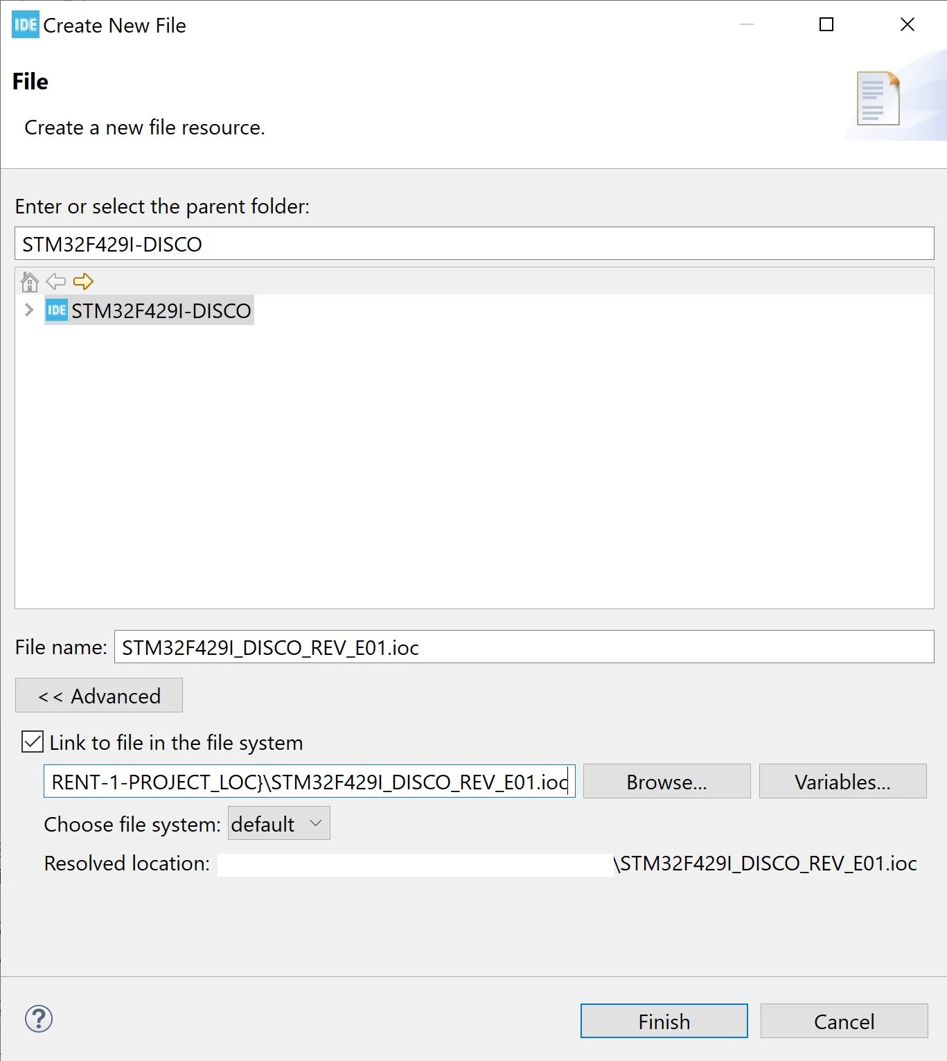

Thank for the response. It was quite helpful. I have updated to X-CUBE-TOUCHGFX 4.23.0. Moving forward with the dev kit, I will definitely heed your advice on workflow. In your screenshot, I noticed your project does not include the .IOC or MX file from the project directory. How would you go about importing that into the project?
Dec 15, 2023 11:03 AM UTC
I'm glad to hear you are on a good start.
To link the CubeMX project to your CubeIDE one, you can right click on the project, select New -> File and then in the opened window, click on the Advanced button. Check the option "Link to file in the file system" and in the search section you can write:
${PARENT-1-PROJECT_LOC}\STM32F429I_DISCO_REV_E01.ioc
Linking file to CubeIDE projectLinking file to CubeIDE project
