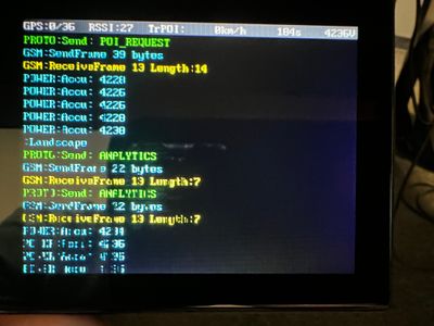

I've updated my project from TouchGFX 4.20 to the newest one and I experienced a serious problem with text rendering. The issue is mostly visible on a specific screen which is a kind of debug console. It refreshes several text objects once in a couple seconds, sometimes frequently. From time to time texts flickers and become unreadable. After next refresh things come back to normal. See a screen shot below:Image.jpeg
Have you got any idea why it happens?
Regards,
Piotr
Senior
Dec 7, 2023 9:18 AM UTC
No problem with TouchGFX.
It is very difficult for me to answer you with a picture.
Have you used the MPV model? If so, the problem is with the display driver.
Why not just refresh the variable values without their labels. and only when changing the values?!
