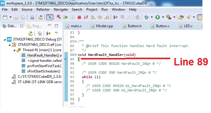

I am working on below setup:
Software Tool Chain:
STM32CubeMX 5.6.0
STM32CubeIDE 1.3.0
TouchGFX 4.13.0 Designer
Application Template STM32F746G Discovery Kit v3.0.1

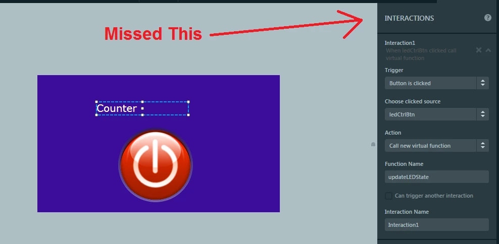

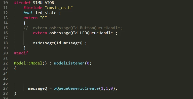

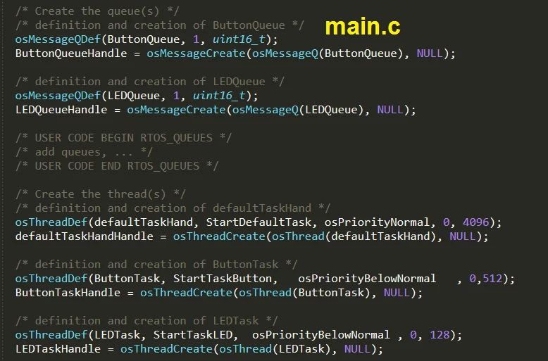

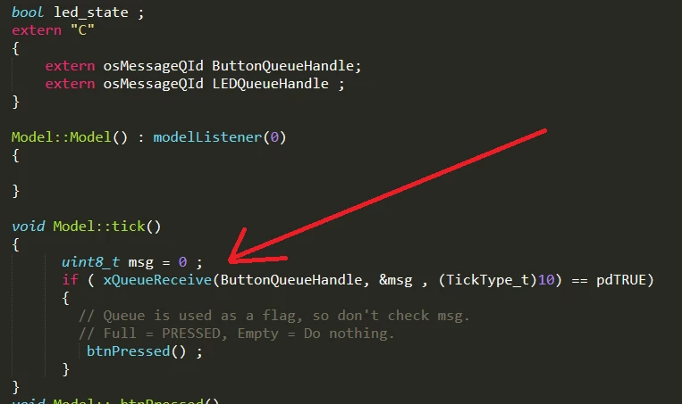

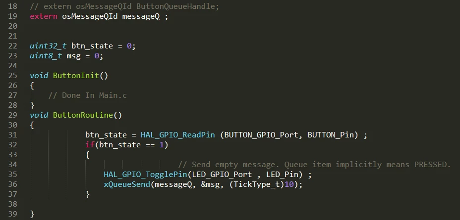

I am trying to do send/receive messages with Message Queues.

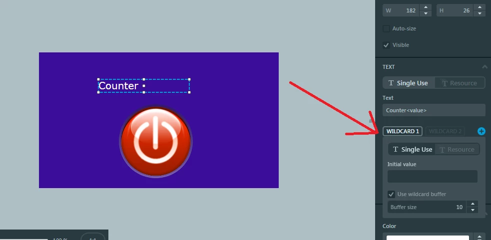

1) From TouchGFX Toggle Button to LED.
2) From Hardware Button to Text Area
as per below thread.
Program Successfully Build . But Still not succeeded to Work on Actual Hardware.
LED is not OFF/ON with TouchGFX Toggle Button
2) From Hardware Button to Text Area Update
HardFault and/or MemManage_Handler
Because I have changed priorities and Heap .
Can anybody look attachment ? Guide me What needs to be correct ?
To solve the problem .
