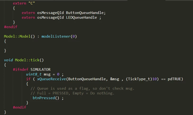

TouchGFX : FreeRTOS Queues for controlling LED from TouchGFX Button and Hardware Button to TouchGFX Text Area Update:
I am working on below setup:
Software Tool Chain:
STM32CubeMX 5.6.0
STM32CubeIDE 1.3.0
TouchGFX 4.13.0 Designer
Application Template STM32F746G Discovery Kit v3.0.1
I am trying to do send/receive messages with Message Queues.
1) From TouchGFX Toggle Button to LED.
2) From Hardware Button to Text Area
as per below thread.
https://community.st.com/s/question/0D50X0000AU4zodSQB/interfacing-with-hardware-in-touchgfx-applications
Program Successfully Build . But Still not succeeded to Work on Actual Hardware.
LED is not OFF/ON with TouchGFX Toggle Button
2) From Hardware Button to Text Area Update
HardFault and/or MemManage_Handler
Because I have changed priorities and Heap .
 Can anybody look attachment ? Guide me What needs to be correct ?
To solve the problem .
Karan

I think there is an error in your model.cpp
I'm referring to my own example in this video: https://www.youtube.com/watch?v=majcfxr3u2E
The model looks something like this:
extern "C"
	xQueueHandle messageQ;
Model::Model() : modelListener(0)
	messageQ = xQueueGenericCreate(1,1,0);
So I can see two things different in your setup:
  1. you have a osMessageQId instead of a xQueueHandle. I have no idea if they are actually the same type.
  2. in modelListener I create a queue and assign the handle to it. You don't have that call and that could be why the hardfault occurs?
Lastly you wait 10 ticks for your messages. I don't think that it is needed or it helps anything. I can't recall if the waiting is a blocking call or not. If it is you have reduced your framerate a bit.

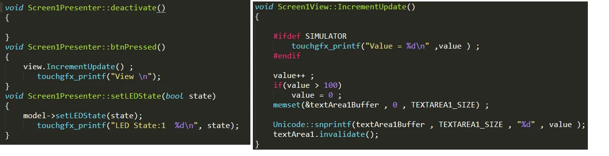

Here are Code snapshots..
Please check updated One
The I did also use xQueueReceive(LEDQueueHandle , &led_msg , 0) worked well on Hardware LED in same (this) application ..
My ADC , UART code working fine with Semaphore (without Queue).
I will check your code suggestion tomorrow.
