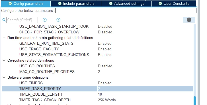

Hello.
I'm using STM32H747XI with touchgfx designer 4.24.2 and Free RTOS 10.3.1.
In this RTOS I setup some threads(with osPriorityNormal 24) and a Periodic Timer at 400ms.
I notice that when I start this thread

Timer will not trigger.
Is the reason that I have no osDelay ? Or a priority question ?
Thankyou in advance.

https://freertos.org/Documentation/02-Kernel/02-Kernel-features/05-Software-timers/03-Timer-daemon-configuration
See documentation of FreeRTOS software timers. The parameter in the ioc.-File is shown in the screenshot:
Increasing this parameter to a higher value than osPriorityNormal should work.
Give it a try and get back to me if it works.

I use Software timer (Freertos), PREEMPTION is Enabled.
I don't know the Timer priority: is there a parameter to set it ?
