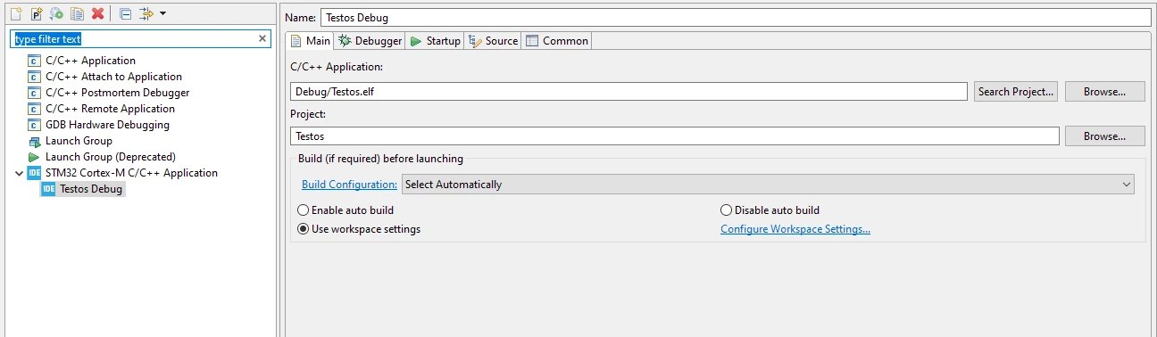

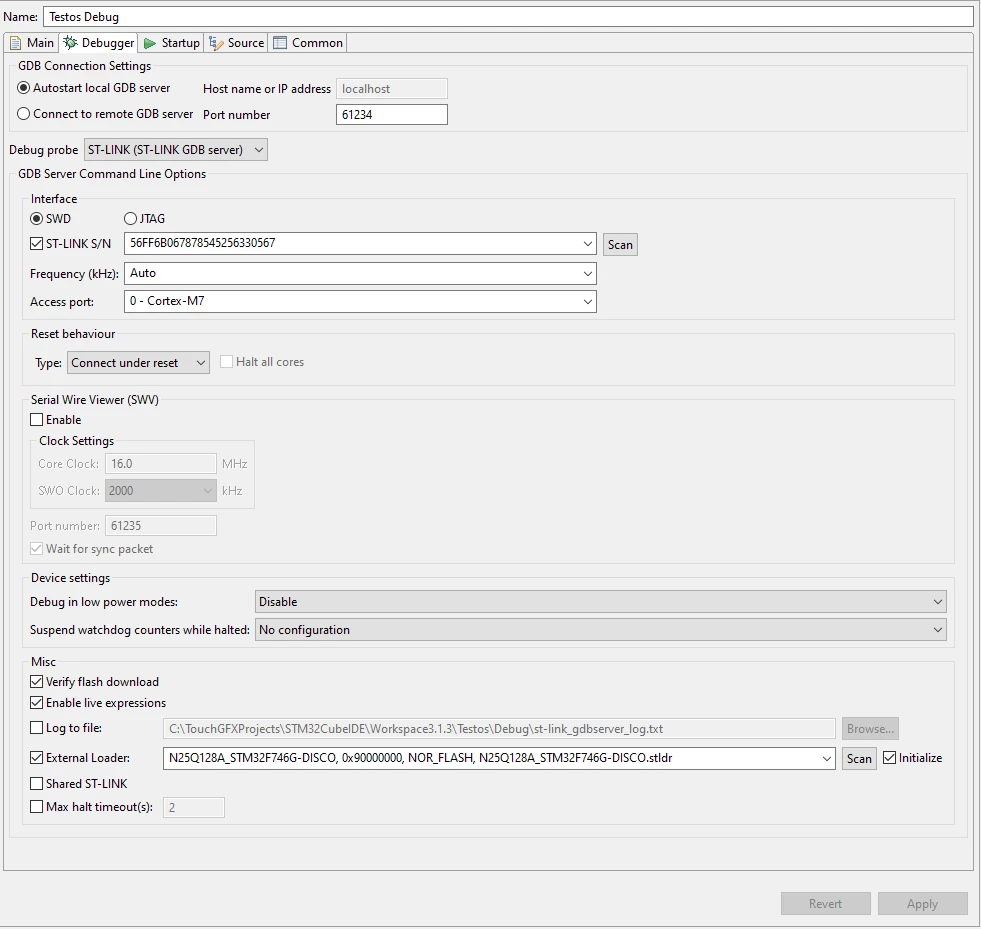

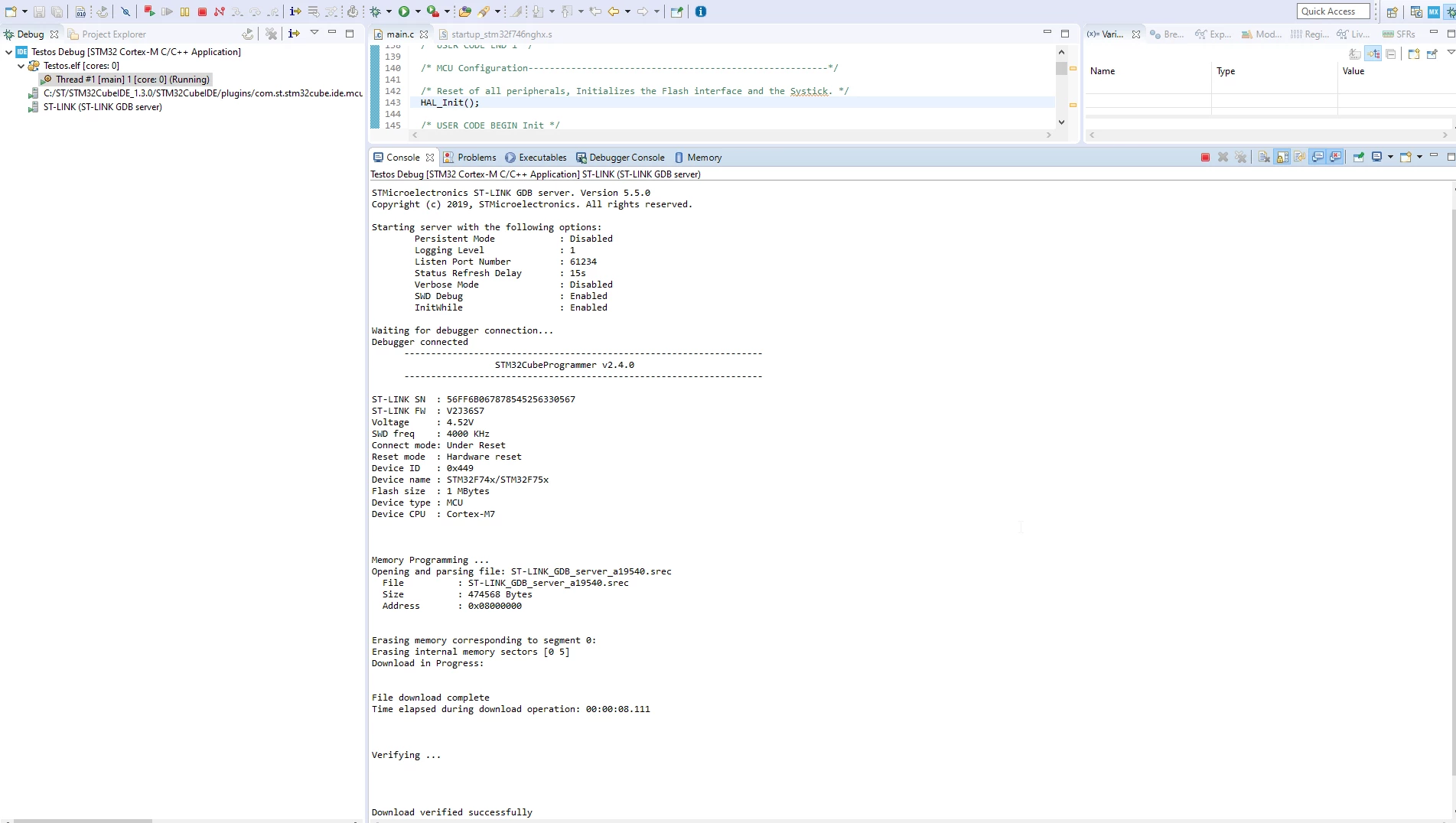

Good afternoon,
I was trying to find a step by step tutorial on how to import a Project using TouchGFX Designer with a given template (e.g. STM32F746G Discovery Kit), using some matching UI Template, generate code and afterwards import the project into STM32CubeIDE.
Finally build the project inside STM32CubeIDE and debug / flash it via ST Link V2 onto my board.
Unfortunately I end up with a Black screen + some Background light.
No Errors during the build, connect to ST Link V2 Debugger and flash.
Is there such a tutorial I might have failed to find?
Or does it have to be the other way around.
  1. Create STM32 Project in CubeIDE, select suiting Board
  2. Open TouchGFX Designer within the Project inside CubeIDE
  3. Create GUI
STM32CubeIde 1.3
TouchGFX Designer 4.13
ST-Link V2 V2J36S7
Appreciating any help or links!
/Rafael
