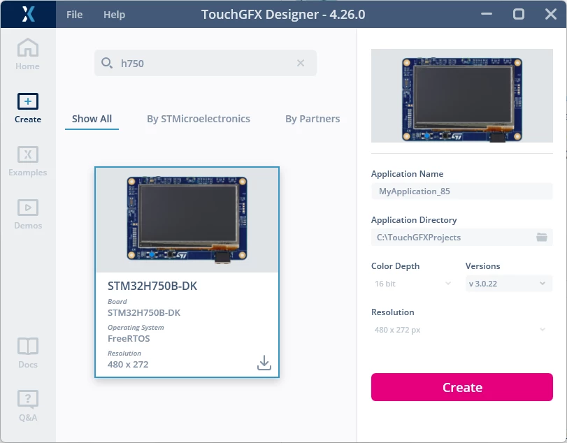

Hello @total_and_STM32.
Could you please elaborate on what your question is?
If you are looking for examples on how to integrate a larger display with the STM32H750B-DK, I would recommend you to first of all have a look at the TouchGFX Board Setup (TBS) available in TouchGFX Designer for the STM32H750B-DK. Assuming the larger display also uses a parallel RGB interface, it should be fairly straightforward to configure it by modifying the LTDC settings in STM32CubeMX.
Best regards,

Dec 11, 2025 12:03 PM UTC
I do not think you can use that documentation link in your current state. The procedure described there is for later, when your board setup is running and you want to e.g. distribute it or base multiple GUI projects on the same hardware setup.
What I am referring to are the TBSs that are available in TouchGFX Designer under the "Create" tab.
These are complete TouchGFX board setups for some of the graphics-relevant evaluation boards. They are open source and can be used as a reference when developing board setups for custom hardware.
Best regards,
Johan

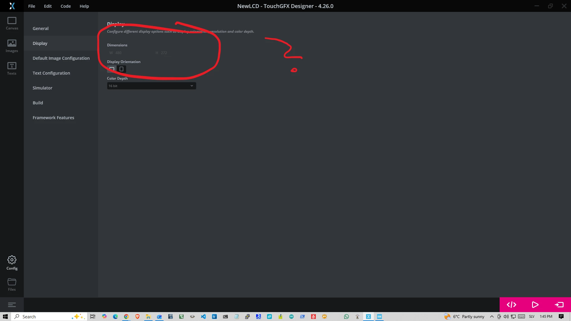

So, when "the project" is created in the TouchGFX designer for the STM32H750b-dk, how can it then be opened in the CUBE IDE, or CUBE MX, where the LTDC is set up for the custom LCD?
Is this the idea, or is the resolution, etc. of the display defined within the TouchGFX Designer?
So far, I cannot define the dimension nor the color depth while the display orientation can be determined, see below.
Best.
Dec 12, 2025 10:47 AM UTC

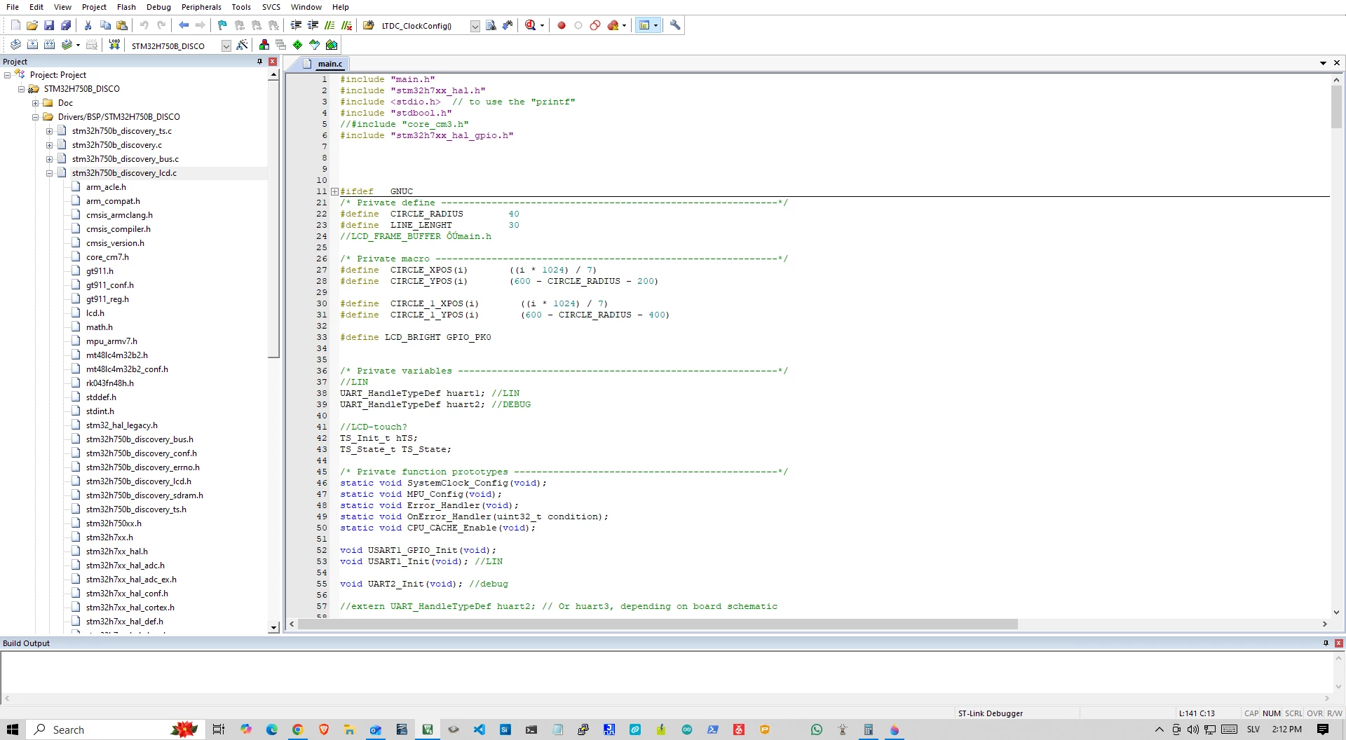

Managed to open the relevant file from the Touch GFX project folder, opened the *.ioc, set the setting in the MX, as well opened the Designer to check about the settings... it looks like that is it, however, the preview on the display is not normal, either with the cache CPU ICache and DChache enabled / disabled,
Anyway, I am wondering why I cannot sort out the general preview via TouchGFX and LTDC settings. For example, a basic setup to test the working of the LCD was achieved with the following code and little program in the uVision, before hand ExtBootloader was used..., so,  the connections, namely GPIOs ,  LTDC is working properly. It seems this driver is used: "stm32h750b_discovery_lcd.c", for example it can be found here:
Attaching the code, maybe we can use some information to help us out with regard to the Touch GFX?
