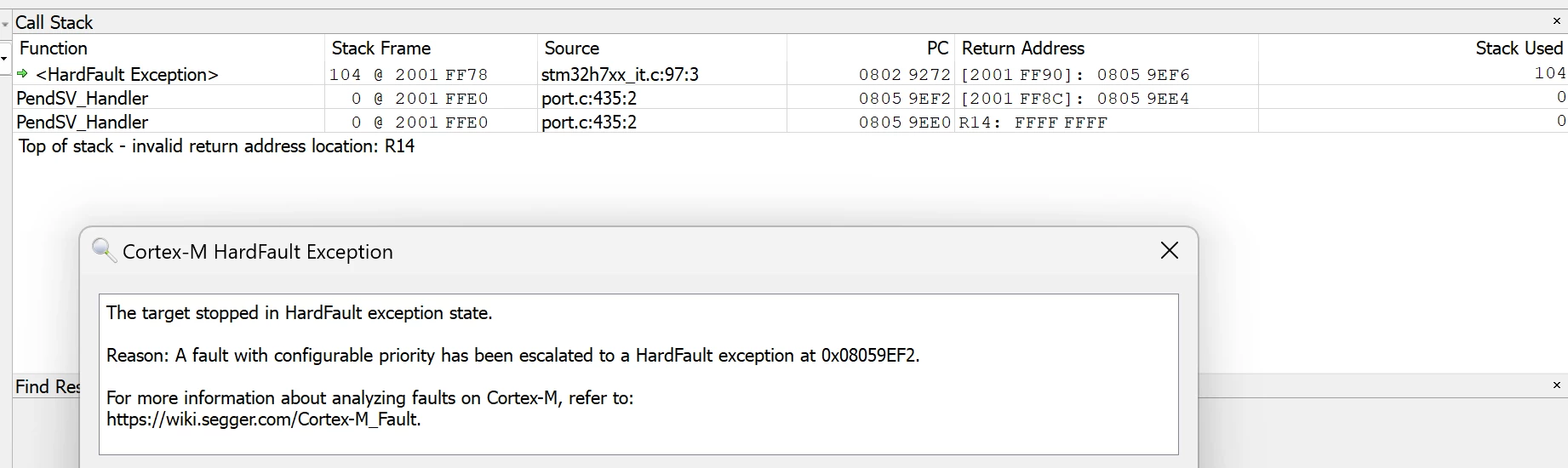

TouchGFX Crash with multiple text boxes
I have a custom board project which I have been running for over a year and im looking to add some features to the layout. The screen is a 240x320 layout and the MCU is a STM32H757. I am running touch GFX 4.20 and it will be difficult for me to upgrade from this due to the ties within the cubide and code base.

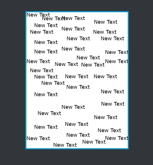

Im looking to add a page with multiple test boxes,as i need to update sensor readings to the screen. Originally i built this in custom containers as i would normally, but it kept crashing on creating on the new page. So i have worked back making the page more and more simple untill i found a threashold of it occuring when i have 38 default text boxes on the screen (see pic), the text boxes have no buffers allocated to them and this is on a fresh screen so no functions or code running.
if i lower the number of text boxes to 34 its fine.
is this a limitation of 4.20 ?

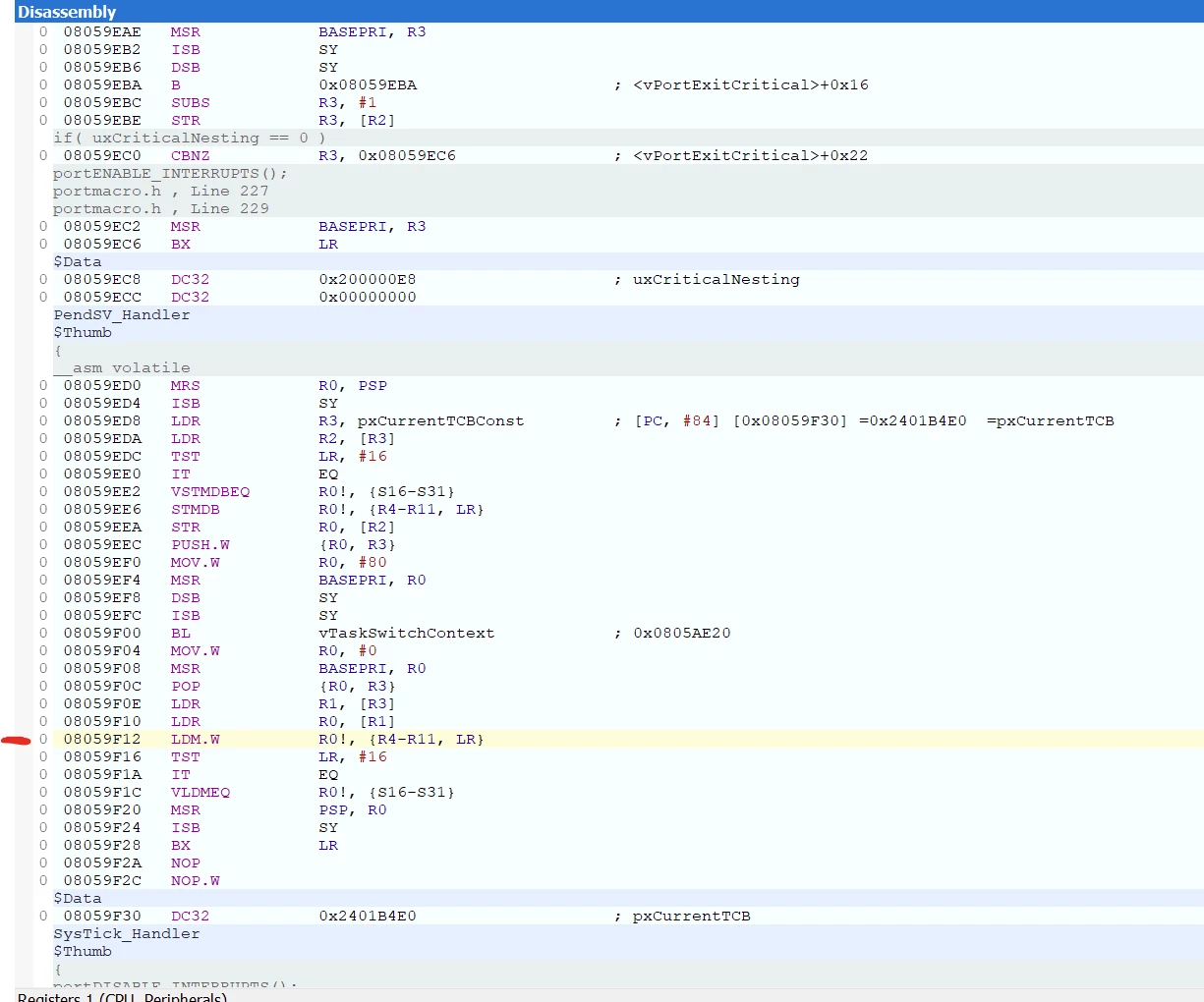

I've tried increasing the canvas buffer and rtos heap and task memory but nothing resolves this crash (HardFault exception), i've attached the memory address in the diassembler.

Hi @justin11 , what does function call stack say ?
justin11
justin11Author
Senior
Oct 25, 2024 9:20 PM UTC
This is the call stack at the point it crashed
ferro
Lead
Oct 25, 2024 9:38 PM UTC
Thanks. This does not look familiar sorry. So is this the only screen you,ve got ? are you adding TextAreas in GfxDesigner so they are in Base class ? You mantioned heap so probably not.

72 == sizeof ( touchgfx::TextArea )
72*34 = 2448 bytes
So you are creating them on heap. Does this happen if you add them from an array of lets say 50 TextArea ?

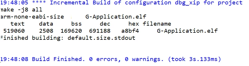

When you link you app what does console say about ROM/RAM usage
justin11
justin11AuthorBest answer
Senior
Oct 28, 2024 9:50 PM UTC
Im running an STM32H757 so i should have pleanty of RAM
I think i have managed to resolve this. I changed the following task buffer size. this was originally 1024. no changing it to 2048 i've not seen the crashes.
// frertos.c
uint32_t guiBuffer[2048]; // Increase buffer size for gui task
// Update thread definition for gui
osThreadStaticDef(gui, Gui_Task, osPriorityNormal, 0, 2048, guiBuffer, &guiControlBlock);
ferro
Lead
Oct 29, 2024 9:15 AM UTC
Interesting that is happend with this specific screen - cannot see obvious reason for that as memory for screen objects is(should be) already alocated elsewhere, not on thread stack. Good to know.
There are some config options for freeRTOS to see how much/maximum of stack usage
configRECORD_STACK_HIGH_ADDRESS
configCHECK_FOR_STACK_OVERFLOW
uxTaskGetStackHighWaterMark
