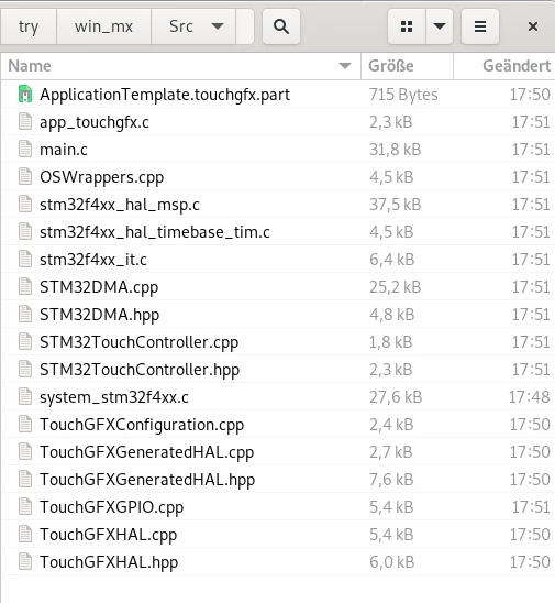

Hello, i am unable to compile a touchgfx project.
Try #1:
Starting from CubeMX, Version 6.10.0 i click on Generate Code. It ends with "The Code is successfully generated under:".  When i click on Src/ApplicationTemplate.touchgfx.part, it opens TouchGFX Designer Version 4.23.1.
I start with a "Blank UI" and klick on Import.Then i define there a Box and a Button.
Then i click on "Generate Code" it fails with: Generate Code | Failed.
Unsupported toolchain: Makefile
Here the CubeMX is running on a linux box while TouchGFX Designer is running on a Windows 10 computer.

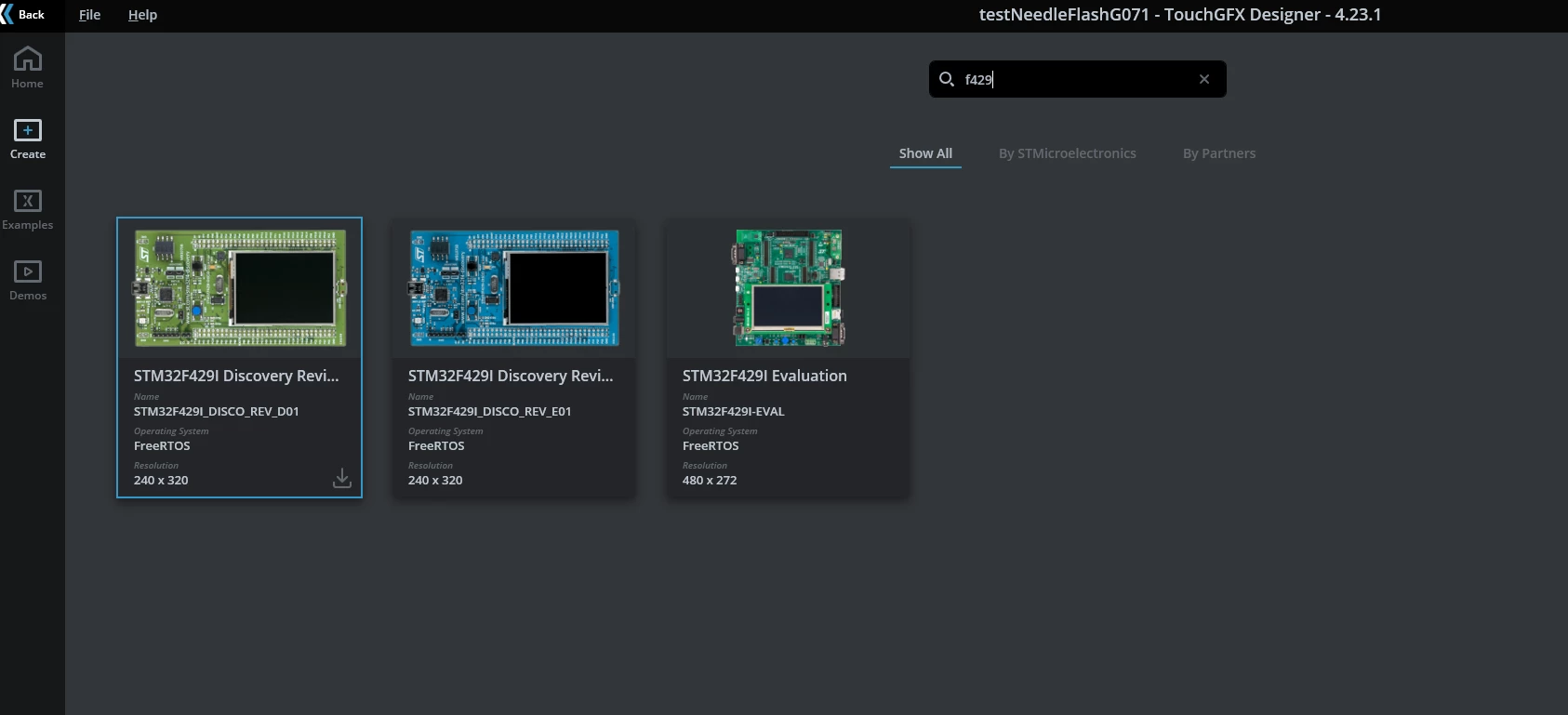

yes, in the meantime i found a solution.
I created a project with designer with the F429-DISCO board.
There was a wonderful makefile. It compiled successfully.
Then i used this makefile with my custom board, code generaded by CubeMX from IOC-File.
Unfortunately the file hierarchy strcucture is totally different so the makefile from Designer
did not work here. So i had to adjust the folders and it workd.

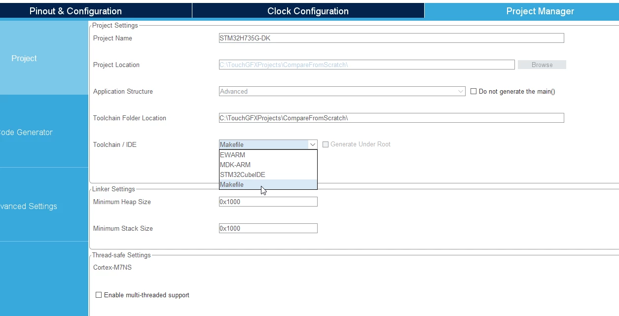

Hello @sk-st ,
From your previous posts I guess you are using a custom board for your project.
Have you had the opportunity to look at the board bring up guide : board bring up guide ?
From the png I can read "unsuppoprted toolchain : makefile".
It looks like you select the makefile toolchain in STM32CubeMX when generating code such as below :
If you want to flash your board from Designer, you have to select STM32CubeIDE.
Regards,
Gaetan GodartSoftware engineer at ST (TouchGFX)

Although X-CUBE-TOUCHGFX is selected in CubeMX in Middleware,
the Makefile generated with CubeMX Code generation (2) does only
contain one file regarding touchgfx:
Src/app_touchgfx.c
In the beginning of this file is:
This file was created by TouchGFX Generator 4.23.0.
The file does not contain real code, only prototypes and definitions.
Makefile renamed to Makefile.txt due to forum software restrictions.

Have you had a loot at the TBS generated when creating a new F429 project from Designer, that could inspire you for your own TBS, maybe you can see some similarities and some differences :
Regards,

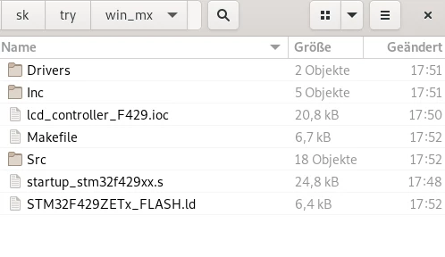

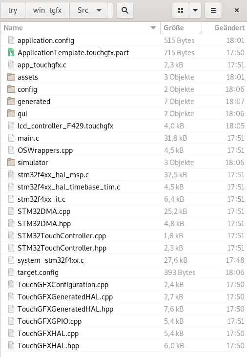

Mar 5, 2024 5:50 PM UTC
Hello Gaetan,
thank you for your effort.
Meanwhile i have installed CubeMX on the win 10 PC, as well.
When i click on the lcd_controller_F429.ioc file, it opens CubeMX, then i
press the generate code button and get the following files:
Under Src is:
After opening TouchGFX by clicking on ApplicationTemplate.touchgfx.part,
i add some screens and buttons. The generate code fails again with
As described in the first post.
But there are files created:
The lcd_controller_F429.touchgfx you mentioned is also created.
On the windows PC is only STM32CubeMX and TouchGFX Designer installed,
no Toolchain. You generated the code with CubeMX? The file structure looks
a bit different.
