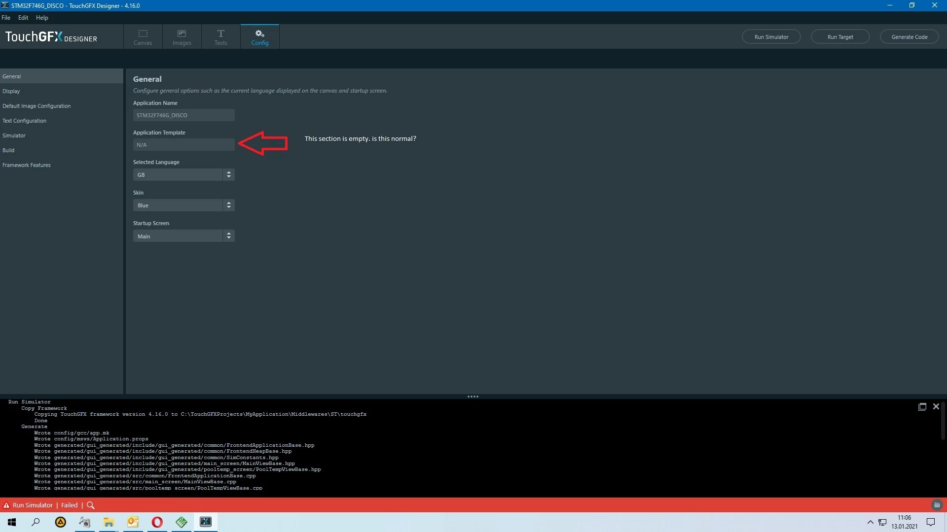

Hi @Mon2​ ,
I made your suggests. I select and import "Pool Demo". gave below error ;
Run Simulator
  Copy Framework
    Copying TouchGFX framework version 4.16.0 to C:\TouchGFXProjects\MyApplication\Middlewares\ST\touchgfx
    Done
  Generate
    Wrote config/gcc/app.mk
    Wrote config/msvs/Application.props
    Wrote generated/gui_generated/include/gui_generated/common/FrontendApplicationBase.hpp
    Wrote generated/gui_generated/include/gui_generated/common/FrontendHeapBase.hpp
    Wrote generated/gui_generated/include/gui_generated/common/SimConstants.hpp
    Wrote generated/gui_generated/include/gui_generated/main_screen/MainViewBase.hpp
    Wrote generated/gui_generated/include/gui_generated/pooltemp_screen/PoolTempViewBase.hpp
    Wrote generated/gui_generated/src/common/FrontendApplicationBase.cpp
    Wrote generated/gui_generated/src/main_screen/MainViewBase.cpp
    Wrote generated/gui_generated/src/pooltemp_screen/PoolTempViewBase.cpp
    Wrote generated/simulator/gcc/Makefile
    Wrote generated/simulator/include/simulator/mainBase.hpp
    Wrote generated/simulator/msvs/touchgfx.props
    Wrote generated/simulator/msvs/touchgfx_prebuild.targets
    Wrote generated/simulator/msvs/touchgfx_sdl2.props
    Wrote generated/simulator/src/mainBase.cpp
    Wrote generated/simulator/touchgfx.ico
    Wrote generated/simulator/touchgfx.rc
    Wrote generated/simulator/touchgfx.res
    Wrote simulator/gcc/Makefile
    Wrote simulator/main.cpp
    Wrote simulator/msvs/Application.sln
    Wrote simulator/msvs/Application.vcxproj
    Wrote simulator/msvs/Application.vcxproj.filters
    Done
  Generate Assets
    make -f simulator/gcc/Makefile assets -j8
    Sistem belirtilen yolu bulamiyor.
    Failed
  Failed
Mon2
Senior III
Jan 13, 2021 8:34 AM UTC
Ok. I think something is wrong with your tool installation. Please start again and install the latest touch gfx again and be sure your ST Cube ide is the latest version and install again if necessary.
Also recommend to download the latest STM programmer tool.
With only the Pool Lights gui, it has to work. Do not add any widgets. Just import the gui example for these tests.
Please post your results.

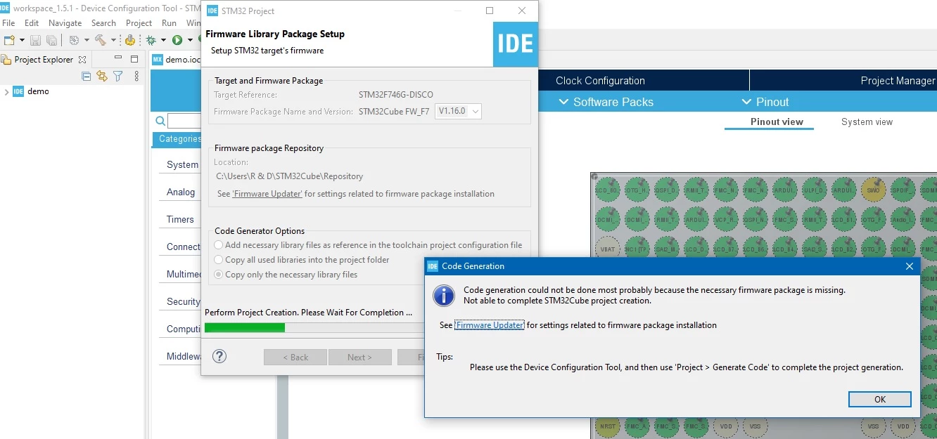

hello @Mon2​ ,
My board is STM32F746G Discovery Kit. but this is not important now. because i can not run project with simulator :)
should i install stm32cubeide with touchgfx? i install cubeide but i can not install toolchain. gave me error attached picture.
also i uninstall all programs, reinstall. but results are same .

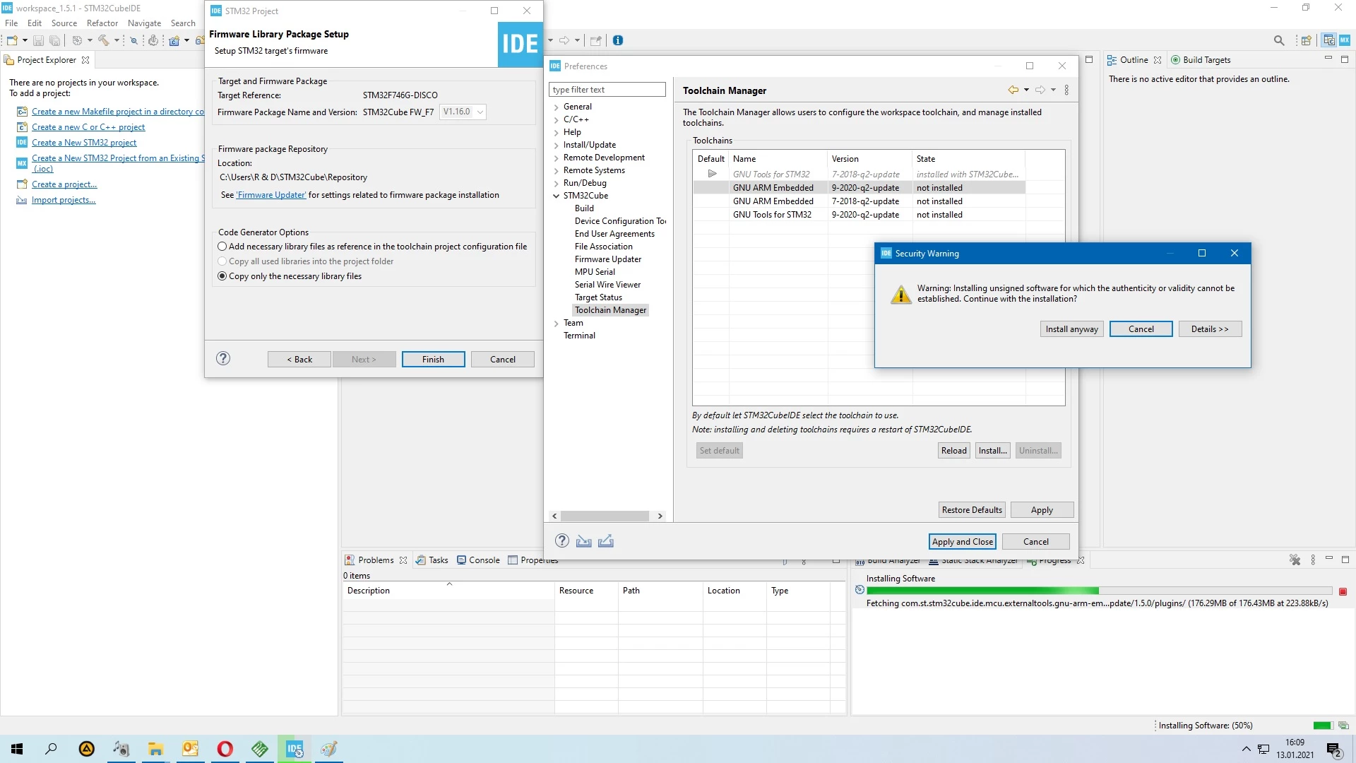

now i am installing toolchain from toolchain manager as you can see in picture. i gave that error.
Mon2
Senior III
Jan 13, 2021 1:16 PM UTC
Select Install anyways.

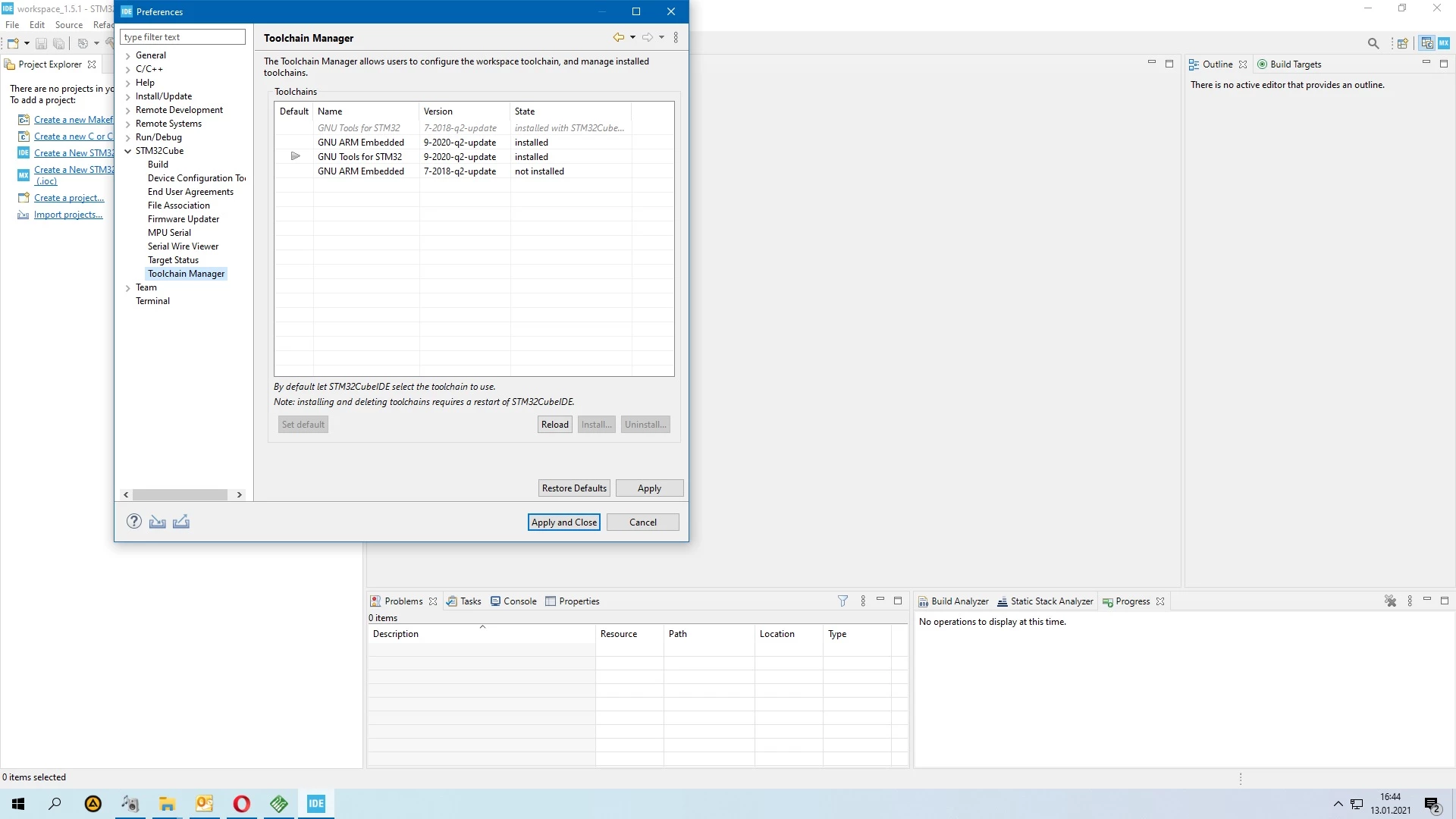

MedBoy
Visitor II
Jan 13, 2021 1:45 PM UTC
i installed 2 segment . but i bought same error. should i change another settings?
Mon2
Senior III
Jan 13, 2021 2:06 PM UTC
It should be ok to "APPLY & CLOSE" this screen.
Continue the installation process to it is completed.
Then test again with:
1) Launch the STM32 IDE -> start a new project -> Board Selector -> locate the same kit you own -> proceed to allow the toolchain to build an empty skeleton of the project.
2) If anything is missing for this target kit, the tools will auto-install for you.
3) Then Project -> Build all. Does this compile ok for you under the STM32 IDE ? If yes, close this toolchain and run the TouchGFX toolchain and attempt your Pool Lights GUI demo again using only the SIMULATOR. Does it build ok now?
Need to get ready for the office. If you are still facing issues, we can try to join with TeamViewer. Will be in about 90 minutes from now = 10:30 AM EST (Canada).
I think you are really really really close to getting this working. Root cause is your toolchain not being properly installed.

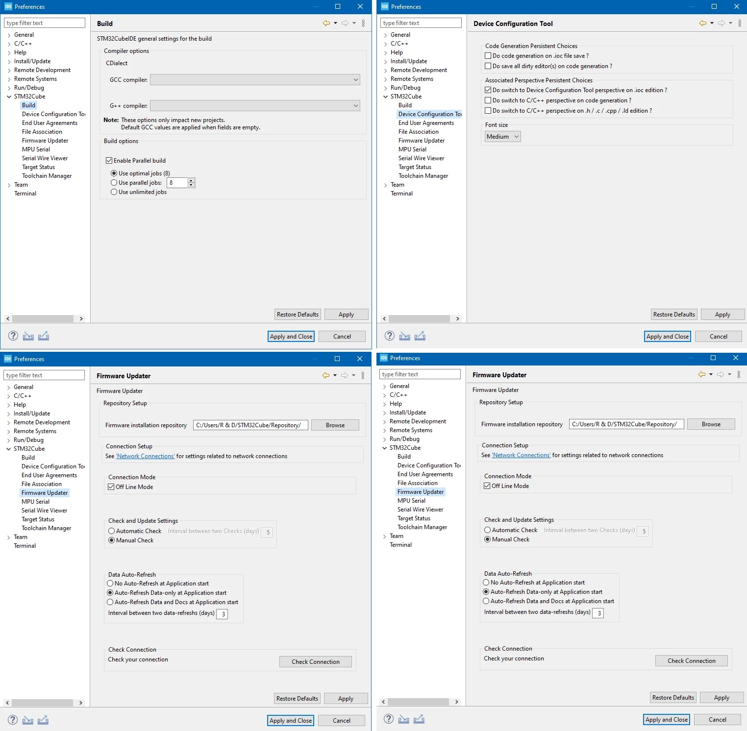

this is my settings
