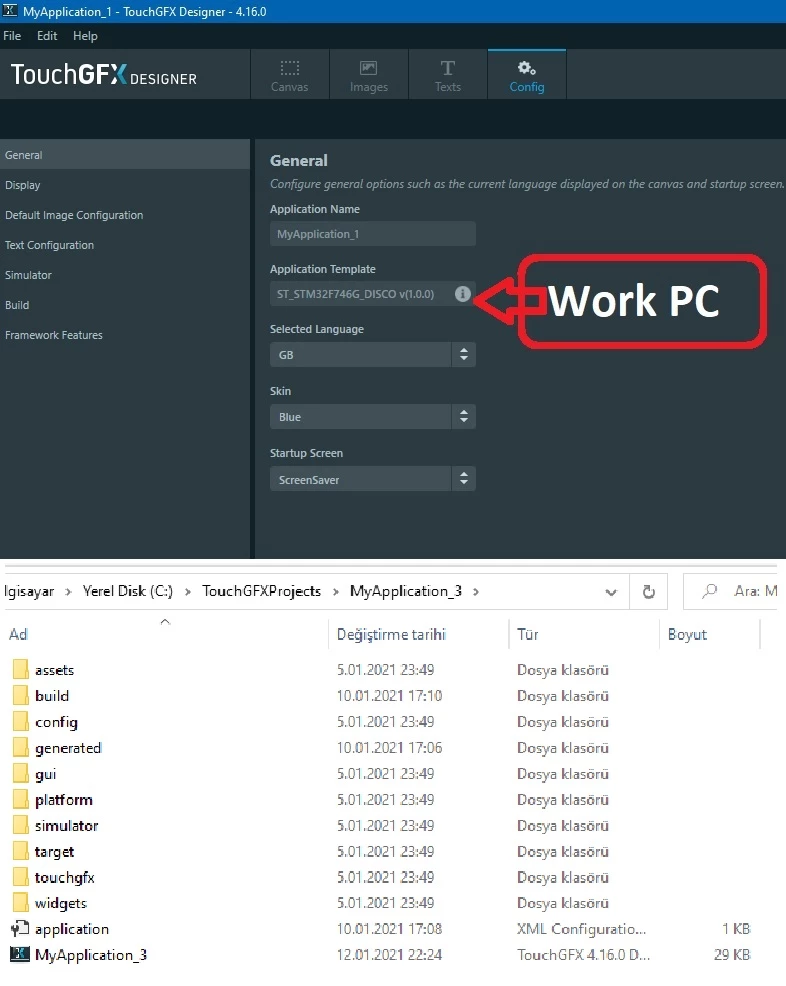

Jan 12, 2021 7:44 PM UTC
Hi again @Martin KJELDSEN​ ,
I understood how i can do environment and makefiles commands. but unfortunetly it was unsuccessfull.
I found some problems my project file. I added 2 files ; my home pc and my work pc screenshots. there is no some files such as build folders in my home pc. so i think touchgfx could not do compile and simulator. what do you think about that problem?

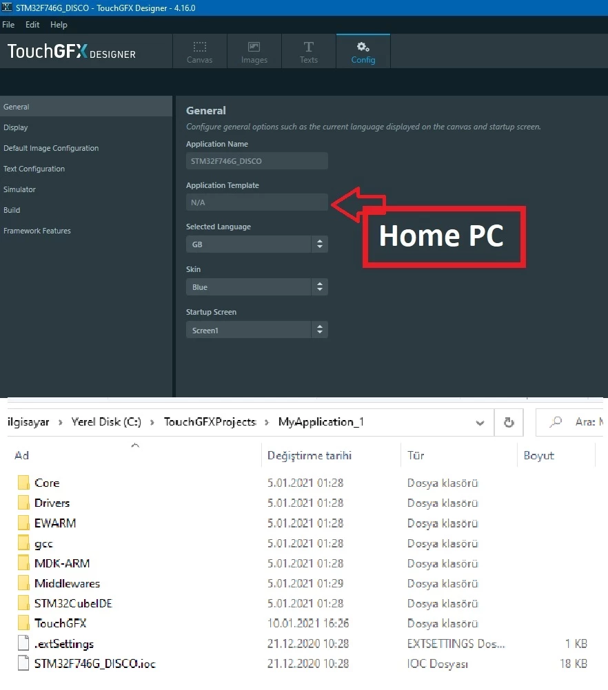

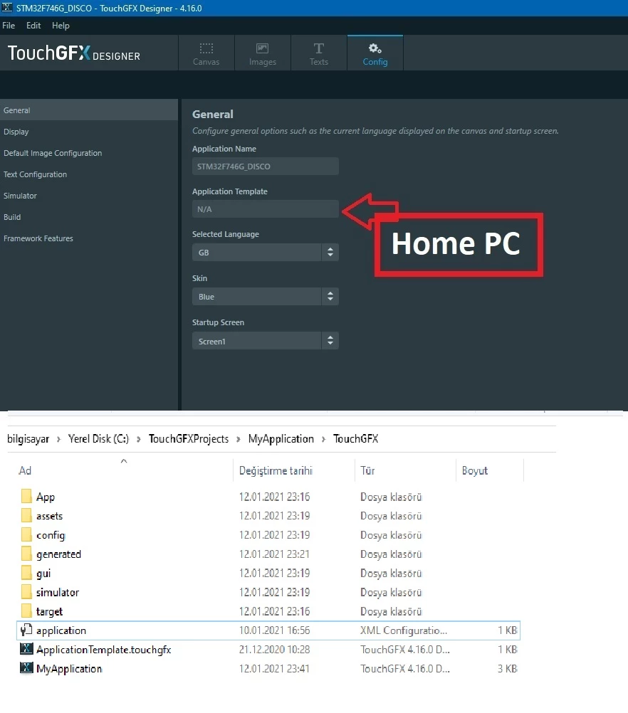

MedBoy
Visitor II
this is my home pc screenshot's.
MedBoy
Visitor II
Jan 12, 2021 8:56 PM UTC
sorry. this is my home pc screenshot.
