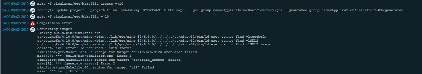

Hi @Martin KJELDSEN​ - may be facing the same issue in trying to assist another developer using the STM32F469i-DISCOVERY kit. Posted on another thread.
Can you advise on what may be the root cause of the following? Any idea to fix this? Thanks.

Hi @Mon2​,
Looks like linker fails on locating three libraries. Can you check your application for the presence of these? (Inside Middlewares/ST/TouchGFX/lib). If they're present there the Makefile is probably pointing to the wrong location.
