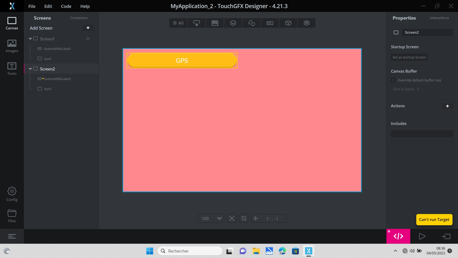

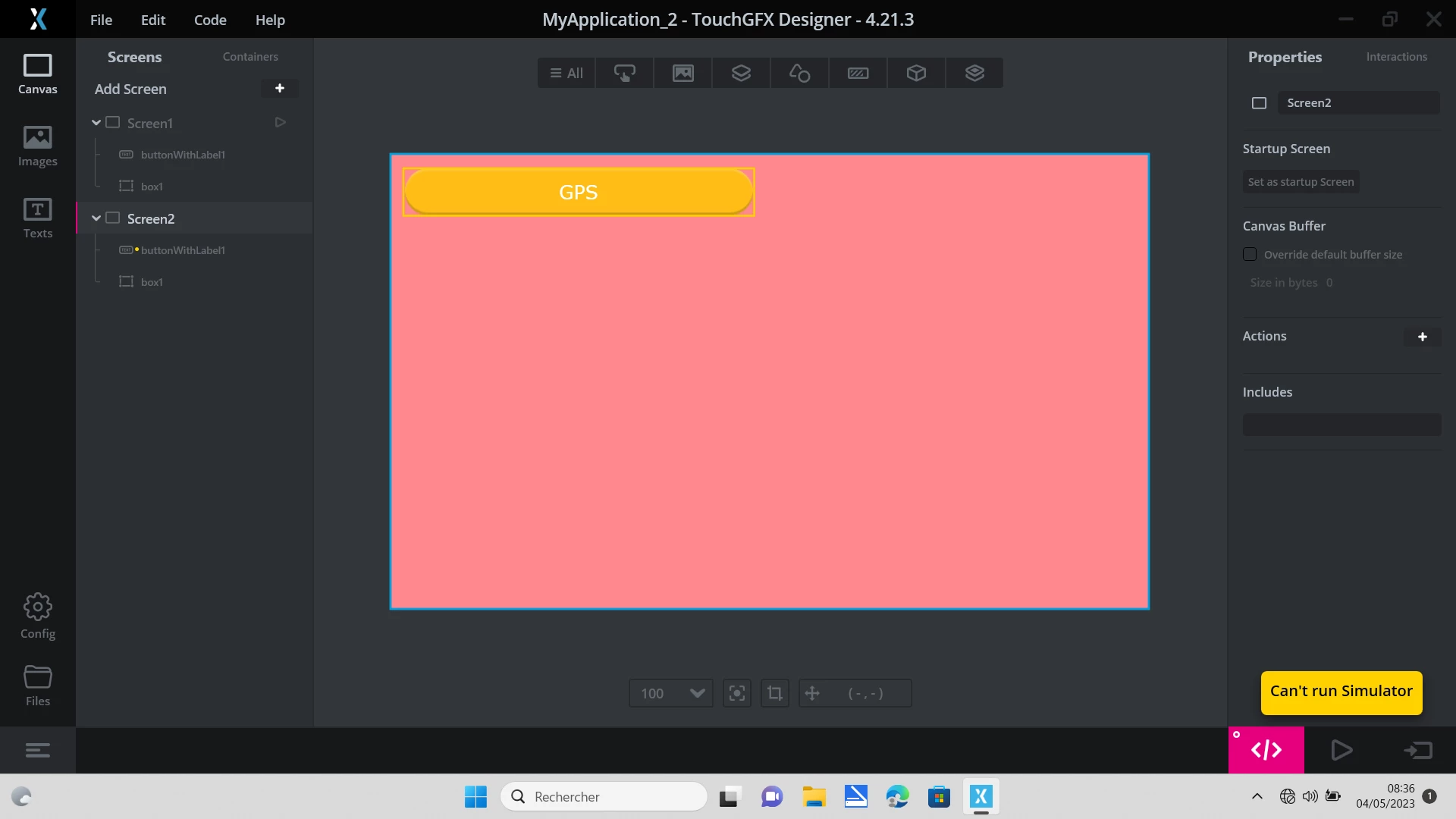

I use ToucheGFXDesigner 4.21.3 for the first time.
I have no problem to design the application for the 2 buttoms Run Simulator and Run Target are not Highlitghted. When, I point these buttoms, it's written : Can't run Simulator and Can't run target. Samething in the menu Code
I probably miss something but what?
If somebody coul help ?
Best Regards
Robert
11 replies
Graduate II
May 4, 2023
Hello. I think you have some error in screen 2 buttonWithLabel because it has yellow tab. Fix that first.
BRobe.3
BRobe.3Author
May 4, 2023
Thanks for answer. You are right, I have not understood, there was a mistake.
Now, Simulator and run target buttoms work well
