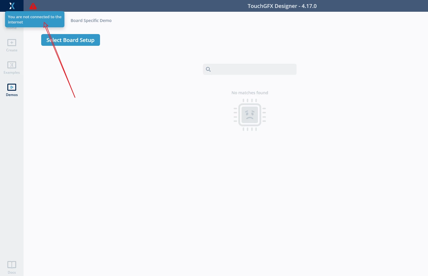

TouchGFX 4.17.0 ,"you are not connected to internet" error is showing
when TouchGFX 4.17.0 is opened I'm getting an error stating no internet connectivity even though my laptop is connected to internet . also in the selection of boards I'm not getting any board option .

i also have same problem..
my connection internet no have problem.. no use proxy.. and i think good connection..
already instal and uninstal.. even redownload the software on website.. but still same..
try instal version 4.17.0 and 4.16.1 same problem..0693W00000D0Xi3QAF.jpganyone can help.. pls.

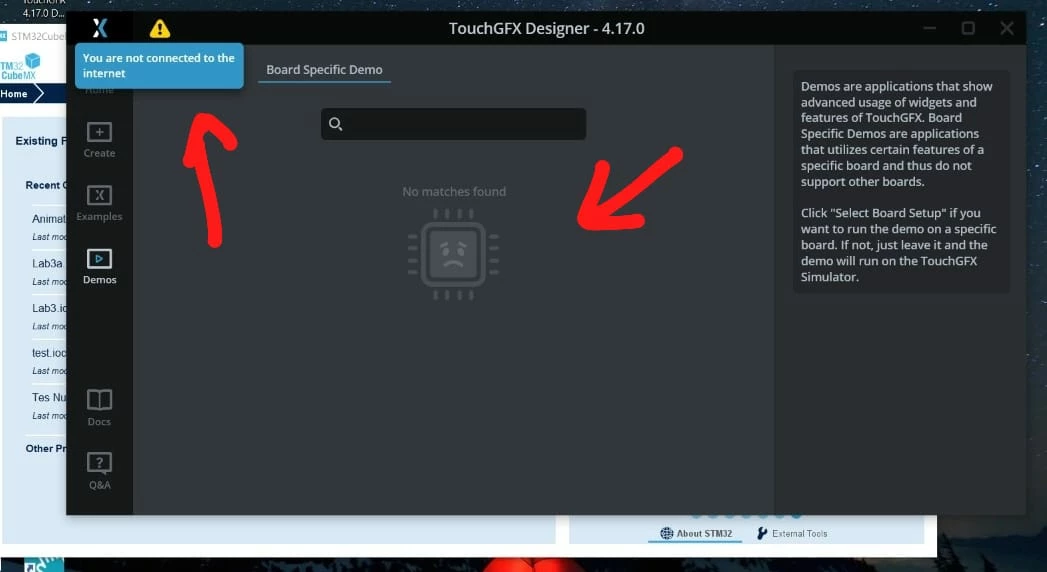

I have the same issue, version 4.17 " You are not connected to internet and no demo or examples are available.

I am having the same problems. No Internet connection, no demos, no examples, no boards to select...
Due to other problems I also just set up a completely new Windows system and newly installed all the latest STM Software with default settings. Still doesnt work...
