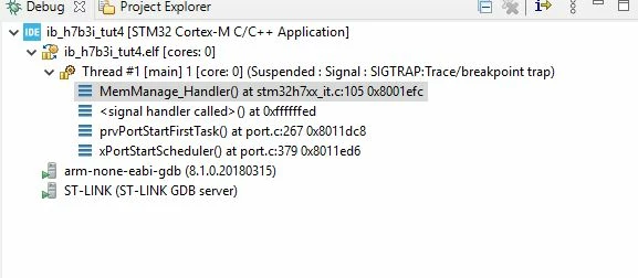

IB.1
IB.1Author
January 18, 2021
Hi Alexandre,
Thank you for your replay. I did try step debug., and crash happen when executing
 osKernelStart(); Please see screenshot bellow.
Please advise what else we can try.
Than you,
I
Alexandre RENOUX
Visitor II
January 20, 2021
Hello IB.1,
I finally got my hands on a H7B3-DK board and I don't see any issue with the graph.
Here is what I did :
  • Open TouchGFX Designer 4.16, select H7B3-DK and the Dynamic Graph UI example
  • Generate code
  • Run target -> works perfectly
  • Then open project with CubeIDE 1.5.0, build, download and debug -> works also perfectly
Please try these steps with your board to see if it works. Also I suggest you to compare this project with yours and see what differs and why.
/Alexandre

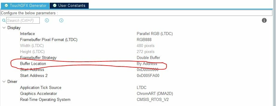

When compare Touch GFX code to mine we noticed fundamental difference:
in CubeMX -> TouchGFX configuration, see screenshot bellow for the reference
in application generated by touchGFX "buffer location" is selected "By Allocation"
What we are doing: selecting "By address", also address setting what we are using are in screenshot.
we have configure SDRAM following this tutorial:
https://www.youtube.com/watch?v=XnSg3UJfSFc
if (in our code) switch in cubeMX TouchGFX Configuration buffer location to "by allocation" we can see the graph;
but if we use "by address" application crashed.
Please advise,
Thank you,
I
Alexandre RENOUX
Visitor II
January 21, 2021
Hello IB.1,
The difference between your project and the one generated by TouchGFX is that the Application Template uses the internal RAM for the framebuffers.
Usually
  • If you use internal RAM for framebuffers -> By allocation (the linker will put the framebuffers wherever he wants following the rules you set in the linker file)
  • If you use external RAM for framebuffers -> By address (you arbitrarily specify the location of the framebuffers)
But if I understand correctly you are using the external RAM so by address should be fine. But maybe when you select by Allocation it allocates the framebuffers in Internal RAM which makes it work with a graph. Could you enclose your linker file ?
If by using the external RAM, By address does not work, I suspect your RAM config to be a bit off. Graph is using a canvas buffer that is allocated in the RAM. Maybe there's some conflict but that's just a guess.
/Alexandre
