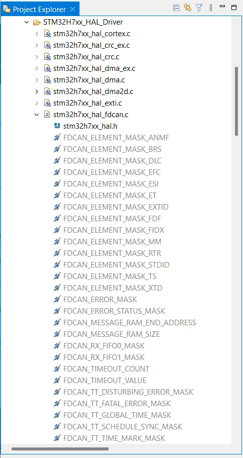

I am doing a project related to using FDCAN to transfer data. The project is based on stm32h745 dual-core. First, I created a project on TouchGFX and then imported the project on stm32CubeIDE. I set the FDCAN1 (video: 00:01) on the Pinout&Configuration.
I need to manually include ' stm32h7xx_hal_fdcan.h ' (video: 00:07) on main.c file, otherwise the fdcan functions on main.c will be undefinded.
Also, the project does not automatically generate the ' stm32h7xx_hal_fdcan.c ' file. So, I add the source file manually to the 'STM32H7XX_HAL_Driver' folder (video: 00:15). But it seen like the file does not link to the folder.
Does anyone have an idea? Please give me some advice, thank you!0693W00000QKckcQAD.png

Hi @TLin.6​ ,
I recommend that you use the STM32CubeMx to create the TouchGFX project.
For that, I advise you to take a look at this MOOC.
Then, you can configure the FDCAN1.
 Maybe this discussion can help you.
