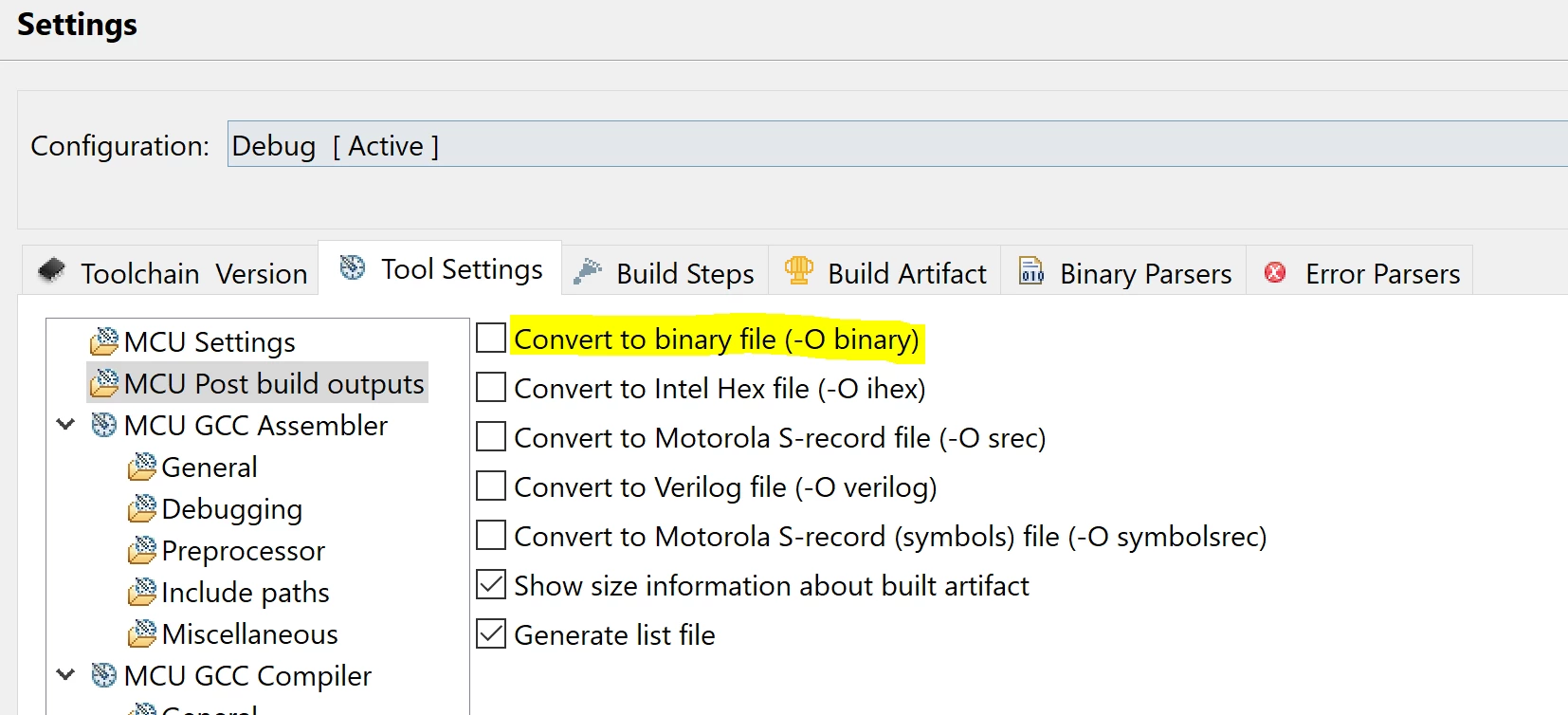

I am struggling Struggling with TouchGFX Generated Code Building on STM32Cube IDE.

When I am trying to Open In STM32CubeIDE 1.3.0 and Import as per below:
C:\TouchGFXProjects\TestHardware\STM32CubeIDE
Binary File Created in Too Large ..
1) STM32F746G_DISCO.bin        2.12 GB
STM32F746G_DISCO.elf         239 KB
STM32F746G_DISCO.hex         99 KB
2) STM32CubeIDE Debugger Error !!
(Read) Failed determine breakpoint type
Error ! Failed to read target status
Debugger connection lost.
Shutting down . . .
3) STM32CubeProgrammer 2.4.0 also have Error while programming .But The TouchGFX Generated File works Well.
4) Changing the STM32F746NGHx_FLASH.ld (from Repository Demo of specific board ) reduce the file size to 35KB . But Code did not work on target either Debug Mode receive error at mention 2) nor the STM32CubeProgrammer/ST-Link.
Is this is Bug or I am using something wrong. ? Please advice me ..
Thanks in advance
Karan
Best answer by Alexandre RENOUX
No it's not a bug. It's normal. You shouldn't use the .bin file.
The only interesting files are .elf file and .hex file to download you project into your board.
You can remove the generation of the .bin file by unchecking the option in the project settings.
/Alexandre

You have to debug the *.elf, not the *.bin... There´s also the possibility to switch off the building of the *.bin files, if they´re not needed. (can´t take a closer look, where exactly to do so :( my laptop is not within reach right now... It was somewhere in Properties, c/c++ build...)
For now it should work to go to your debug configuration and choose the correct file (the *.elf) :)

You simply need the stm32f746*.s file in your CubeIDE project. It's missing from the AT. I fixed it but forgot to upload the AT - I'll rectify this asap. Until then, just include the .s file - it's because Eclipse based ides define weak symbols for parts of the .s file including reset_handler
