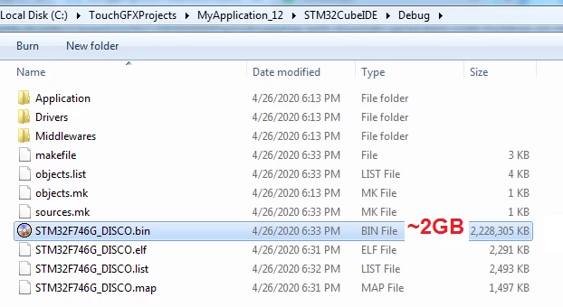

When I am trying to Open In STM32CubeIDE 1.3.0 and Import as per below:
C:\TouchGFXProjects\TestHardware\STM32CubeIDE
Binary File Created in Too Large ..
1) STM32F746G_DISCO.bin        2.12 GB
STM32F746G_DISCO.elf         239 KB
STM32F746G_DISCO.hex         99 KB
2) STM32CubeIDE Debugger Error !!
(Read) Failed determine breakpoint type
Error ! Failed to read target status
Debugger connection lost.
Shutting down . . .
3) STM32CubeProgrammer 2.4.0 also have Error while programming .But The TouchGFX Generated File works Well.
4) Changing the STM32F746NGHx_FLASH.ld (from Repository Demo of specific board ) reduce the file size to 35KB . But Code did not work on target either Debug Mode receive error at mention 2) nor the STM32CubeProgrammer/ST-Link.

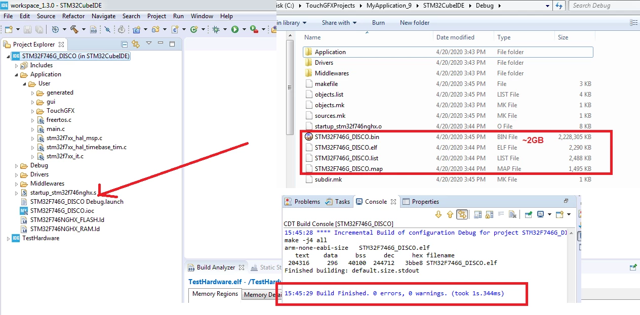

Can you let me know where should I copy startup_stm32f746nghx.s from ?
As for now .. I have just copied
 from
C:\TouchGFXProjects\MyApplication_9\gcc
to
C:\TouchGFXProjects\MyApplication_9\STM32CubeIDE

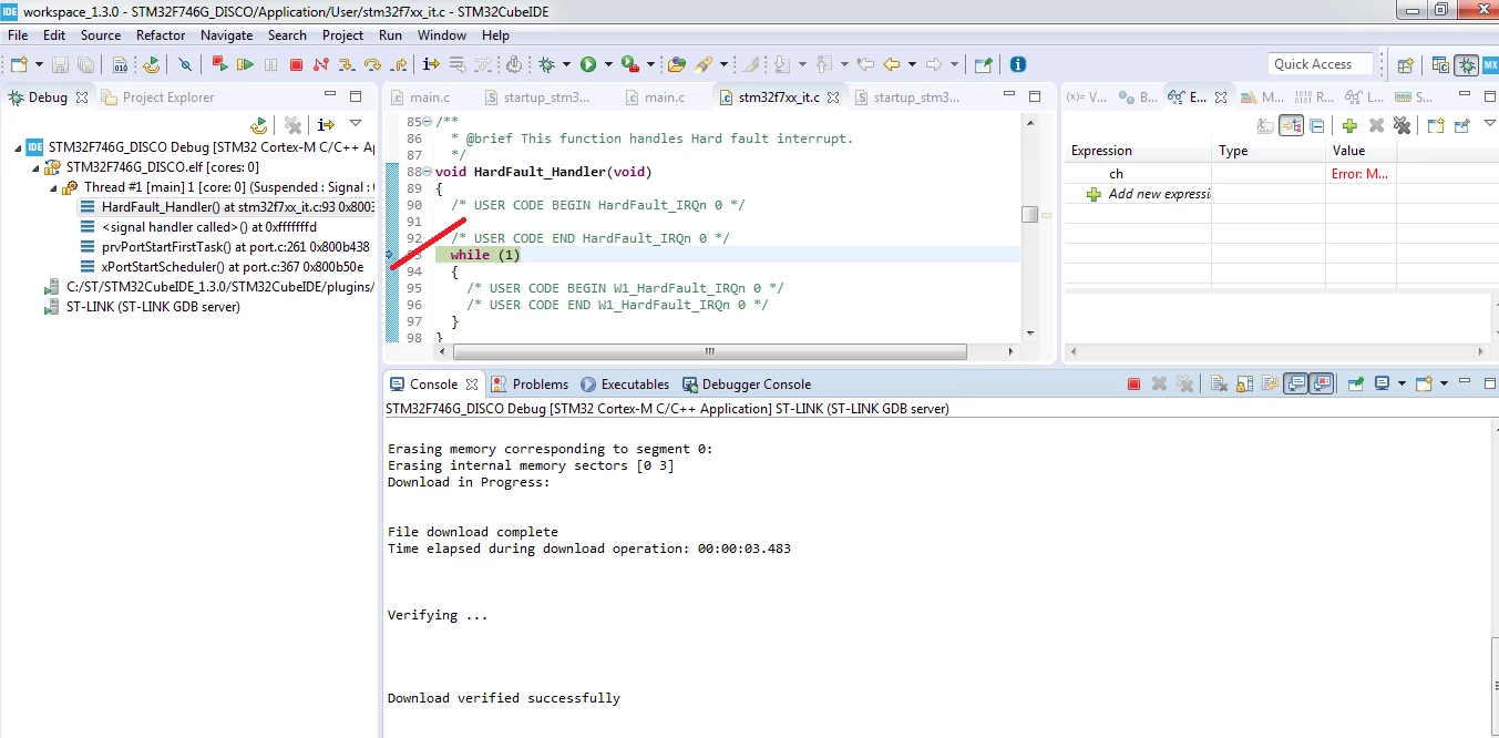

Debugger Start .. Now .. But Reached on HardFault..
Seen Old Complied Project on Screen
Thanks for your concern ..

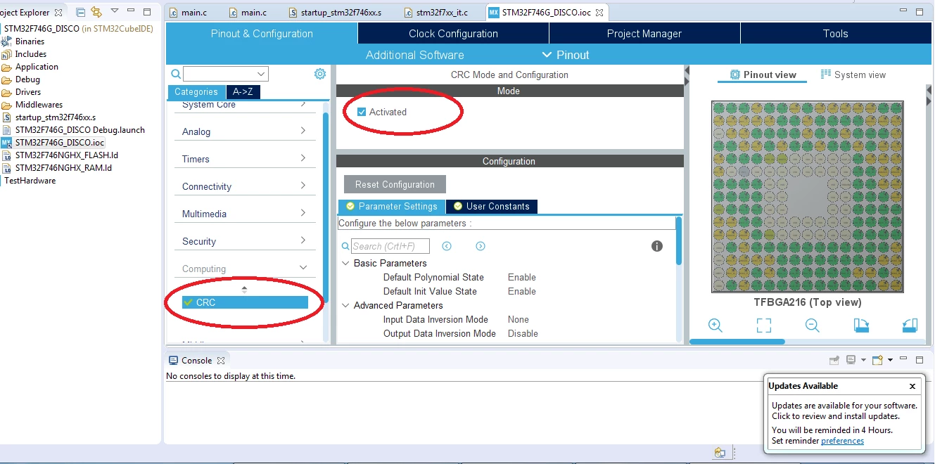

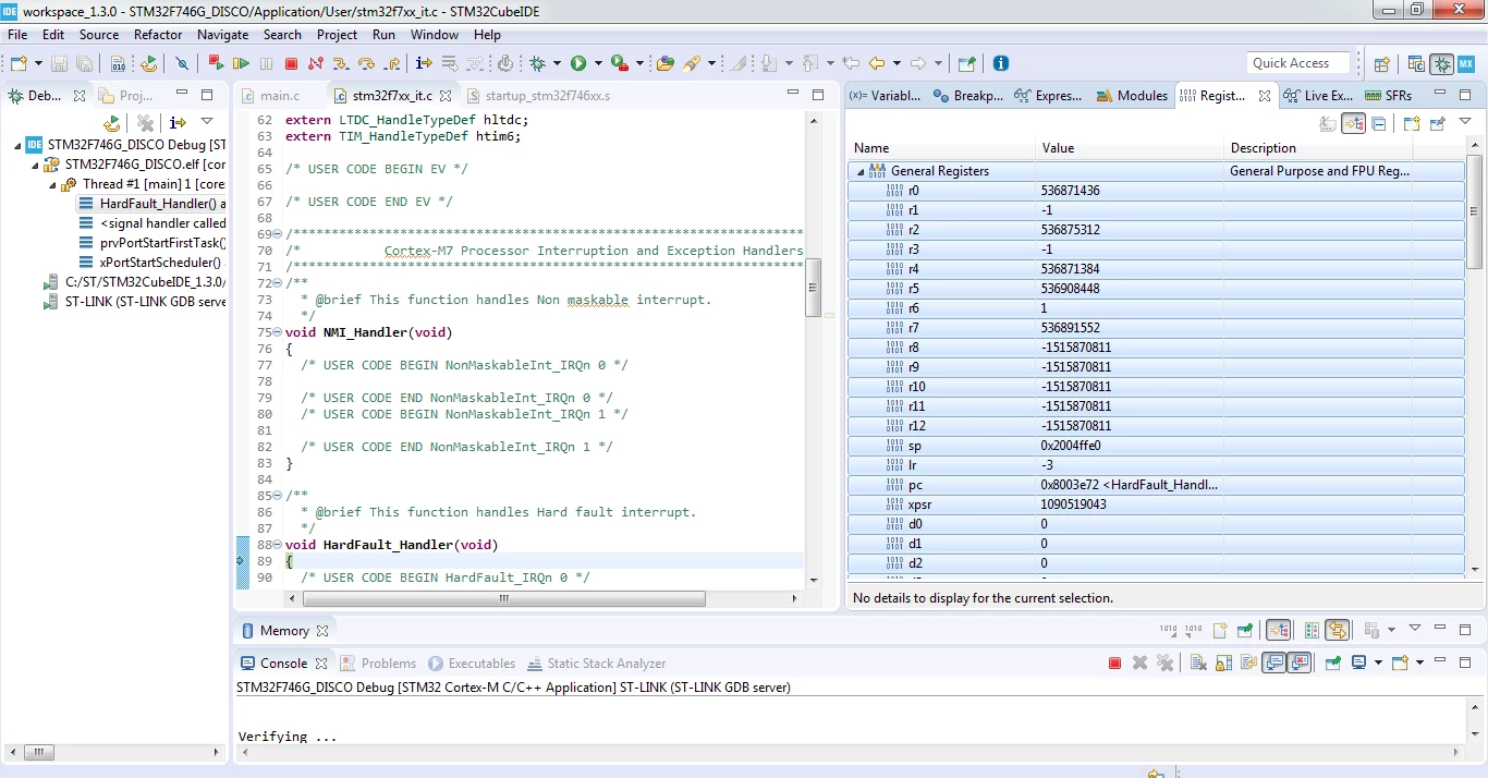

Just get it from a CubeMX generated F746 project. Or from Cube FW packs.
It's not 100% clear to me how you created this project. Check that CRC is enabled in CubeMX - otherwise it will hardfault.

Yes .. CRC is Already Enabled ..
Still Having HardFault ..

Also Please more attention on the size of .bin in screenshot..
Karan
Martin KJELDSEN
Principal III
April 20, 2020
.bin files will be huge because they're covering memory area all the way up to external flash 0x90000000. That's a lot of 0s !

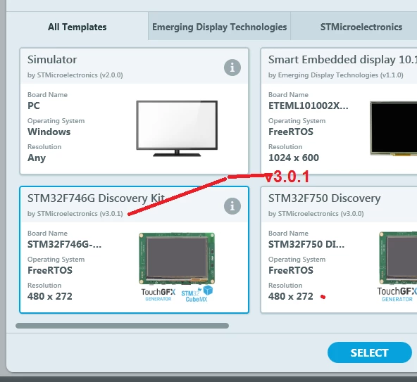

Hi
Alexandre RENOUX (ST Employee) @Martin KJELDSEN (ST Employee)
Shutting down . . .
Problem Solves with Select Application Template STM32F746G Discovery Kit v3.0.1
But .bin Still Nearly GB .
Why So ?
Karan
Alexandre RENOUX
Visitor II
April 27, 2020
As Martin KJELDSEN already explained previously : ".bin files will be huge because they're covering memory area all the way up to external flash 0x90000000. That's a lot of 0s !"

What is your current status ?
Same .. Approximately 2GB.
Is It Bug or What ? Is there any need to resolve that or not?
Karan
Alexandre RENOUX
Alexandre RENOUXBest answer
Visitor II
April 27, 2020
No it's not a bug. It's normal. You shouldn't use the .bin file.
The only interesting files are .elf file and .hex file to download you project into your board.
You can remove the generation of the .bin file by unchecking the option in the project settings.

Thanks for your time .. and New Application Template STM32F746G Discovery Kit v3.0.1
