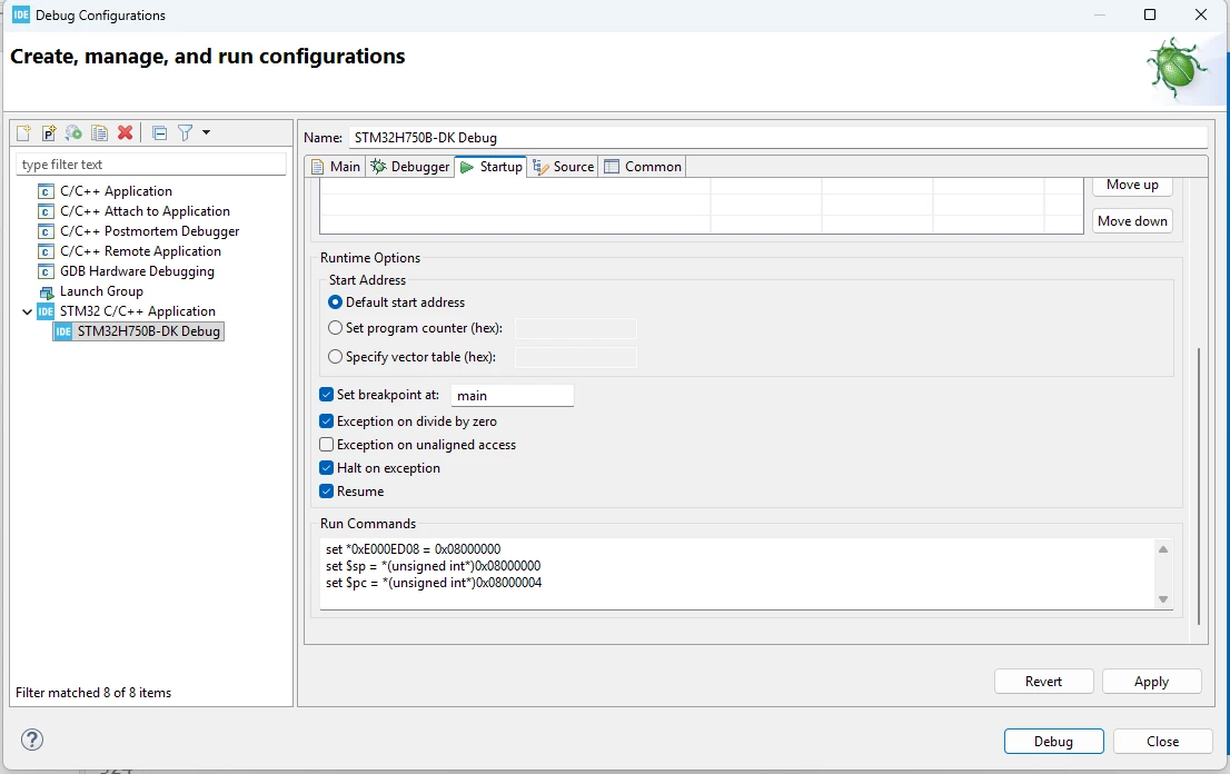

Problem Description:

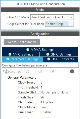

I created a new TouchGFX project for the STM32H750B-DK board. The project builds successfully (0 errors, 1 warning), but I cannot debug it. When starting a debug session, I get the error: "Cannot access memory at address 0x90000000".
The project is configured to use external QSPI flash (0x90000000) for code execution (XIP) since the code size (424KB) exceeds the H750's internal flash (128KB).
What Works:
  • Project builds successfully
  • Simple non-TouchGFX blinky projects debug successfully

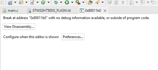

What Fails:
  • Debug session fails with memory access errors at 0x90000000
  • Attempts to set SP/PC from external flash vector table fail

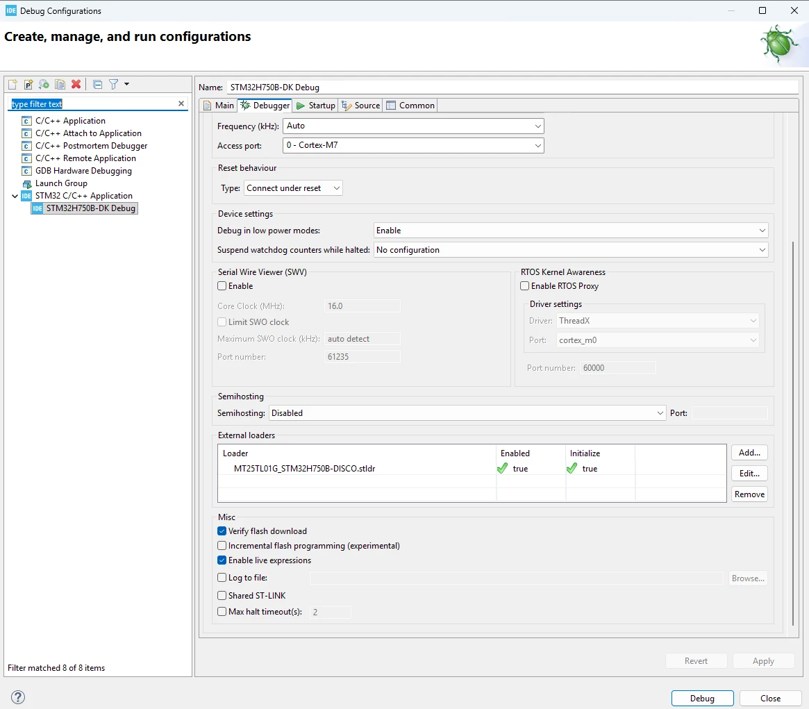

As found
STMicroelectronics ST-LINK GDB server. Version 7.12.0
Copyright (c) 2025, STMicroelectronics. All rights reserved.
Starting server with the following options:
Persistent Mode : Disabled
Logging Level : 1
Listen Port Number : 61234
Status Refresh Delay : 15s
Verbose Mode : Disabled
SWD Debug : Enabled
InitWhile : Enabled
Waiting for debugger connection...
Debugger connected
Debugger connected
STM32CubeProgrammer v2.21.0
Log output file: C:\Users\asus\AppData\Local\Temp\STM32CubeProgrammer_a20920.log
ST-LINK SN : 004D00213137510C33333639
ST-LINK FW : V3J16M9
Board : STM32H750B-DK
Voltage : 3.28V
SWD freq : 8000 KHz
Connect mode: Under Reset
Reset mode : Hardware reset
Device ID : 0x450
Revision ID : Rev V
Device name : STM32H7xx
Flash size : 128 KBytes
Device type : MCU
Device CPU : Cortex-M7
BL Version : 0x90
Opening and parsing file: ST-LINK_GDB_server_a20920.srec
Memory Programming ...
File : ST-LINK_GDB_server_a20920.srec
Address : 0x90000000
Erasing external memory sectors [0 1]
Erasing memory corresponding to segment 1:
Erasing external memory sectors [16 17]
Download in Progress:
File download complete
Time elapsed during download operation: 00:00:02.260
Verifying...
Time elapsed during verifying operation: 00:00:01.786
Download verified successfully

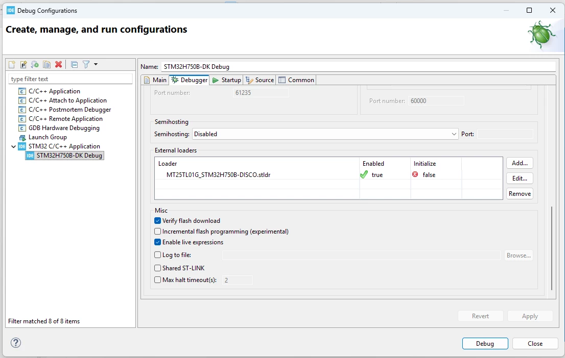

Any guidance on proper debug configuration for external flash execution would be greatly appreciated!
NOTE: Shouldn'e external loader be found, where?

 * @brief QUADSPI Initialization Function
 * @PAram None
 * @retval None
static void MX_QUADSPI_Init(void)
 /* USER CODE BEGIN QUADSPI_Init 0 */
 BSP_QSPI_Init_t qspi_initParams ;
 /* USER CODE END QUADSPI_Init 0 */
 /* USER CODE BEGIN QUADSPI_Init 1 */
 /* USER CODE END QUADSPI_Init 1 */
 /* QUADSPI parameter configuration*/
 hqspi.Instance = QUADSPI;
 hqspi.Init.ClockPrescaler = 3;
 hqspi.Init.FifoThreshold = 1;
 hqspi.Init.SampleShifting = QSPI_SAMPLE_SHIFTING_NONE;
 hqspi.Init.FlashSize = 26;
 hqspi.Init.ChipSelectHighTime = QSPI_CS_HIGH_TIME_4_CYCLE;
 hqspi.Init.ClockMode = QSPI_CLOCK_MODE_0;
 hqspi.Init.DualFlash = QSPI_DUALFLASH_ENABLE;
 if (HAL_QSPI_Init(&hqspi) != HAL_OK)
 Error_Handler();
 /* USER CODE BEGIN QUADSPI_Init 2 */
 qspi_initParams.InterfaceMode = MT25TL01G_QPI_MODE;
 qspi_initParams.TransferRate = MT25TL01G_DTR_TRANSFER ;
 qspi_initParams.DualFlashMode = MT25TL01G_DUALFLASH_ENABLE;
 BSP_QSPI_DeInit(0);
 if (BSP_QSPI_Init(0, &qspi_initParams) != BSP_ERROR_NONE)
 Error_Handler( );
 if(BSP_QSPI_EnableMemoryMappedMode(0) != BSP_ERROR_NONE)
 Error_Handler( );
 /* USER CODE END QUADSPI_Init 2 */

are getting any TouchGFX  GUI content on  display without debug?
are you selected correct Externer Loader in the CubeIDE?
Dose QuadSPI BSP initialized correctly?

STM32H750B-DK Lockup After External Flash Programming - Seeking Recovery Advice:    I've been trying to run code from the external QSPI flash (MT25TL01G) and have gone through an extensive debugging process that ended with a hard lockup. Below is a detailed log of my steps.
1. Initial Setup & Goal
  • Board: STM32H750B-DK (MB1381-H750XB-B01, Product ID DK32H750B$AT1)
  • Tools: STM32CubeIDE, STM32CubeMX (FW_H7 V1.12.1), STM32CubeProgrammer.
  • Goal: Configure and debug an application to run from external QSPI flash at 0x90000000.
2. Step-by-Step Troubleshooting & Results
A. CubeMX & Project Configuration
  • Created project via Board Selector (not MCU selector).
  • Verified QUADSPI configured in Memory-Mapped mode (Clock Prescaler=2, CS High Time=2, Flash Size=26).
  • Linker Script: Manually confirmed .ld file defines FLASH region at ORIGIN = 0x90000000.
  • Issue: The CubeMX "Application runs from" / "Application Entry Point" setting was greyed out/unavailable in the Project Manager, preventing automatic VTOR configuration.
B. Programming & External Loader
  • STM32CubeProgrammer: Successfully programmed my .hex file to 0x90000000 (log confirms full erase, download, and verify).
  • External Loader: MT25TL01G_STM32H750B-DISCO.stldr is selected with both Enabled and Initialize checked in the IDE debug configuration.
C. Debugging Attempts & Failures
  • Default debug launch always halted at 0x80011b0 (internal flash), ignoring external flash.
  • Attempt 1 (VTOR): Added SCB->VTOR = 0x90000000; early in main() and also tried setting it via GDB Run Commands (set *((unsigned int *)0xE000ED08) = 0x90000000).
  • Result: The debugger seemed to jump but immediately hit a HardFault or Lockup state. The processor appears to crash as soon as it tries to fetch instructions from external flash.
  • Attempt 2 (Run from CubeProgrammer): Used CubeProgrammer's "Run after programming" feature. The board enters a locked state (no functional code execution, debugger reports "ARM M in lockup state").
3. Current Status & Questions
The board is now unresponsive in normal operation. The core seems to be in a lockup, likely because it is trying to boot from/branch to an uninitialized or incorrectly accessed QSPI memory region.
My specific questions for the community are:
  1. Recovery: What is the most reliable way to recover from this lockup on the STM32H750B-DK? I understand I may need to force boot from internal memory, but the board lacks a standard BOOT0 jumper. Should I bridge a specific resistor pad (e.g., R100)? Or is a full chip erase via STM32CubeProgrammer under reset sufficient?
  2. Root Cause: Given that the flash programs and verifies correctly, what step am I missing to ensure the QSPI is initialized for memory-mapped mode before the CPU attempts to execute from 0x90000000? Does the SystemInit() function need modification for this board?
  3. Configuration: Has anyone successfully automated this process with this specific board? What is the correct sequence in CubeMX/IDE to ensure the application is built and debugged for external flash from the start?
I have included as much detail as possible. Thank you in advance for any guidance you can provide.
