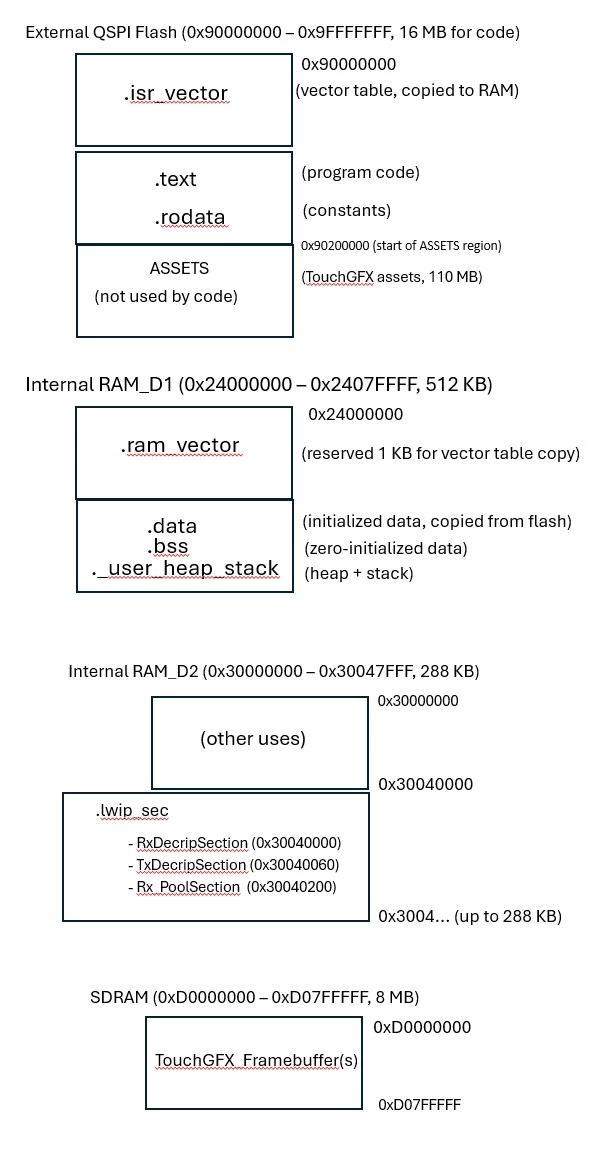

    Pavel A.
    Mar 12, 2026 11:30 PM UTC
    > Linker script places code and read‑only data in EXT_FLASH at 0x90000000, vector table at the start.system_stm32h7xx.c has USER_VECT_TAB_ADDRESS defined and VECT_TAB_BASE_ADDRESS = 0x90000000.
    For best results, copy the vectors table into internal SRAM. Short quick interrupt handlers such as timer tick update can be also relocated to internal RAM.
    ksale.1
    ksale.1Author
    Senior II
    Mar 13, 2026 7:08 PM UTC
    Based on your advise, please note this diagram of various memory regions usage to be adoptedMemory_regions_usage.jpg
    please advise
