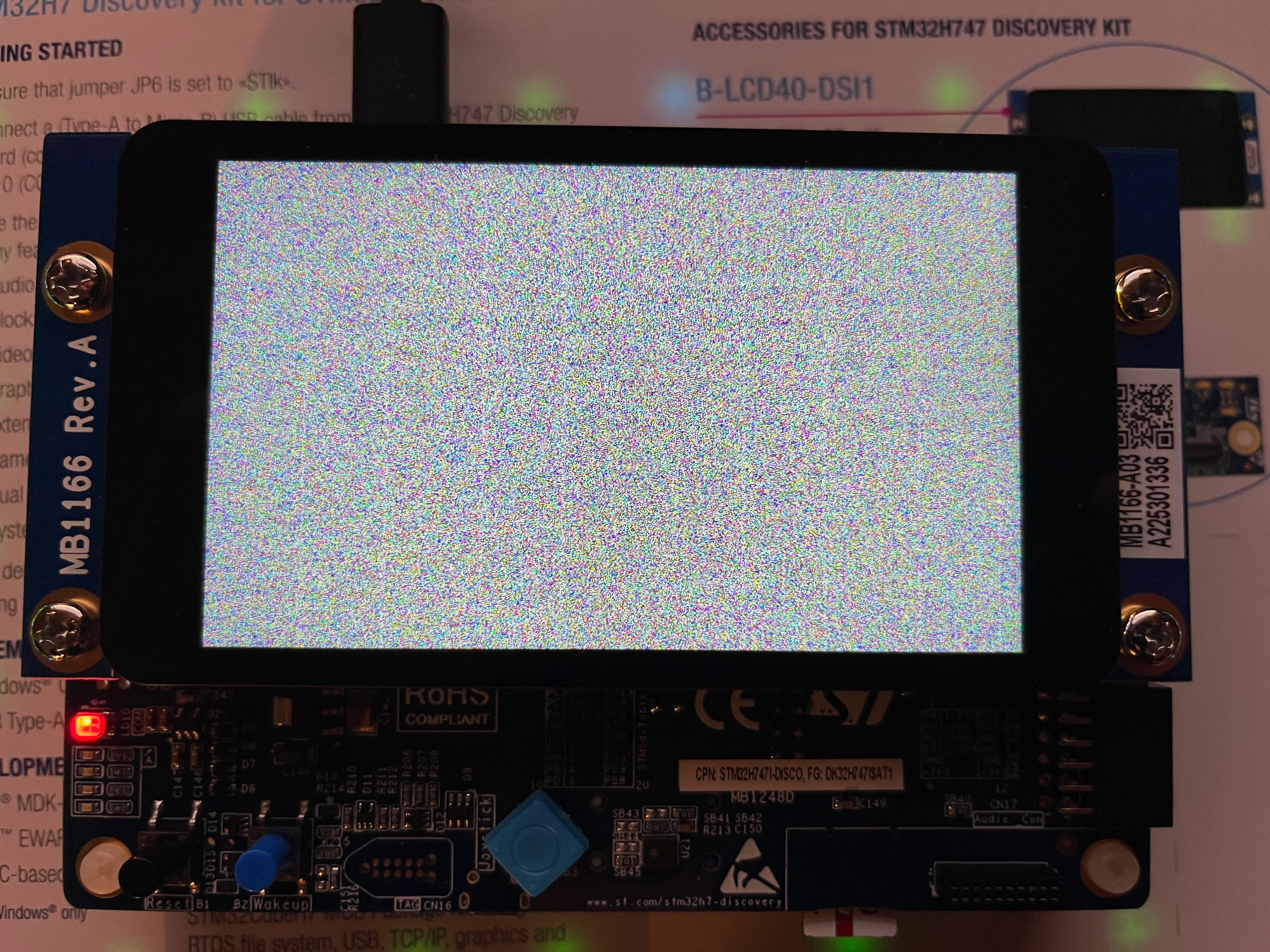

When I flash some .bin the LCD doesen't work. It just display the a noise picture. With similar examples does work and with more advanced examples like the EmbeddedWizard it works too.
When does not work, every time display the same static image:

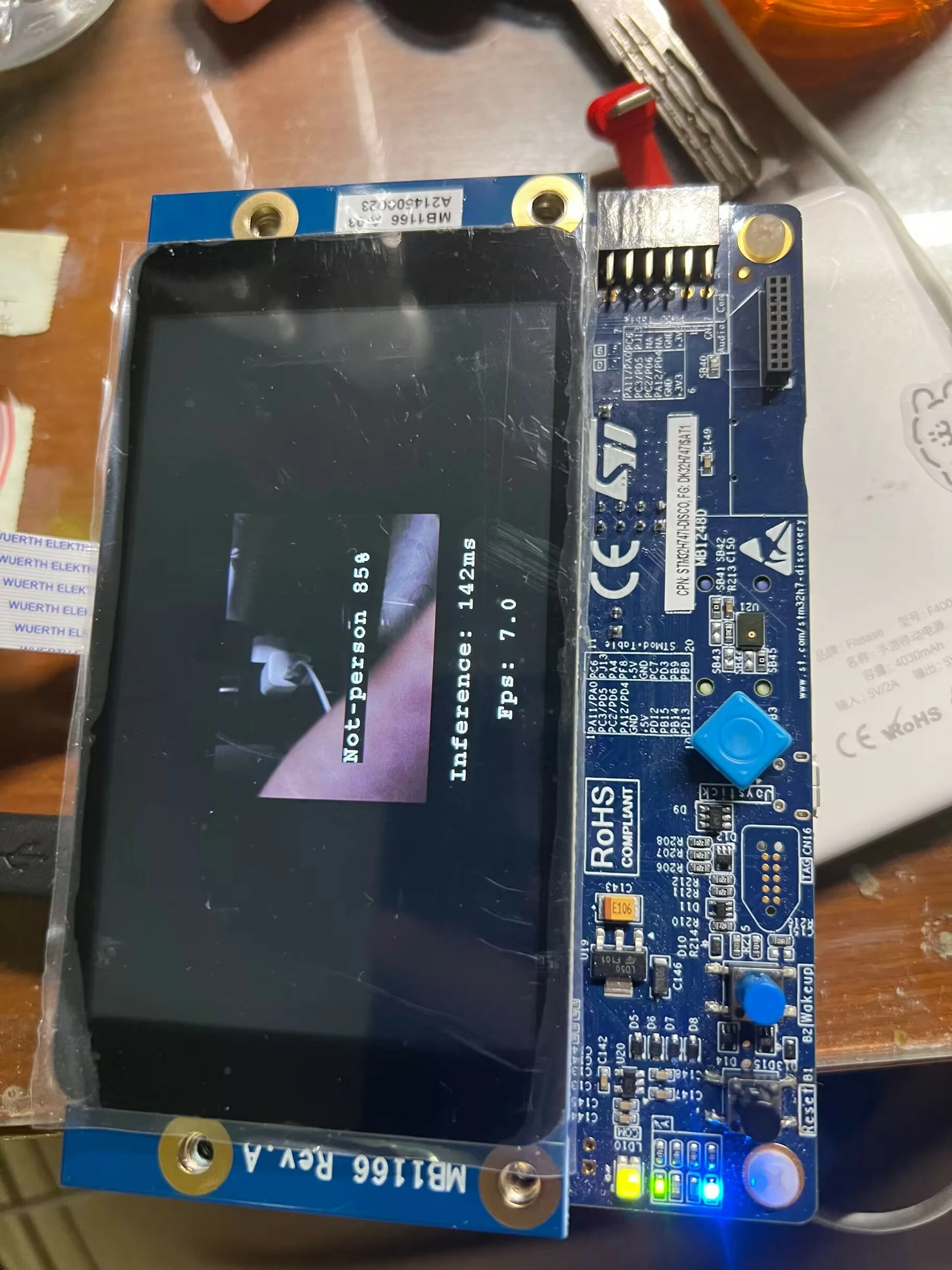

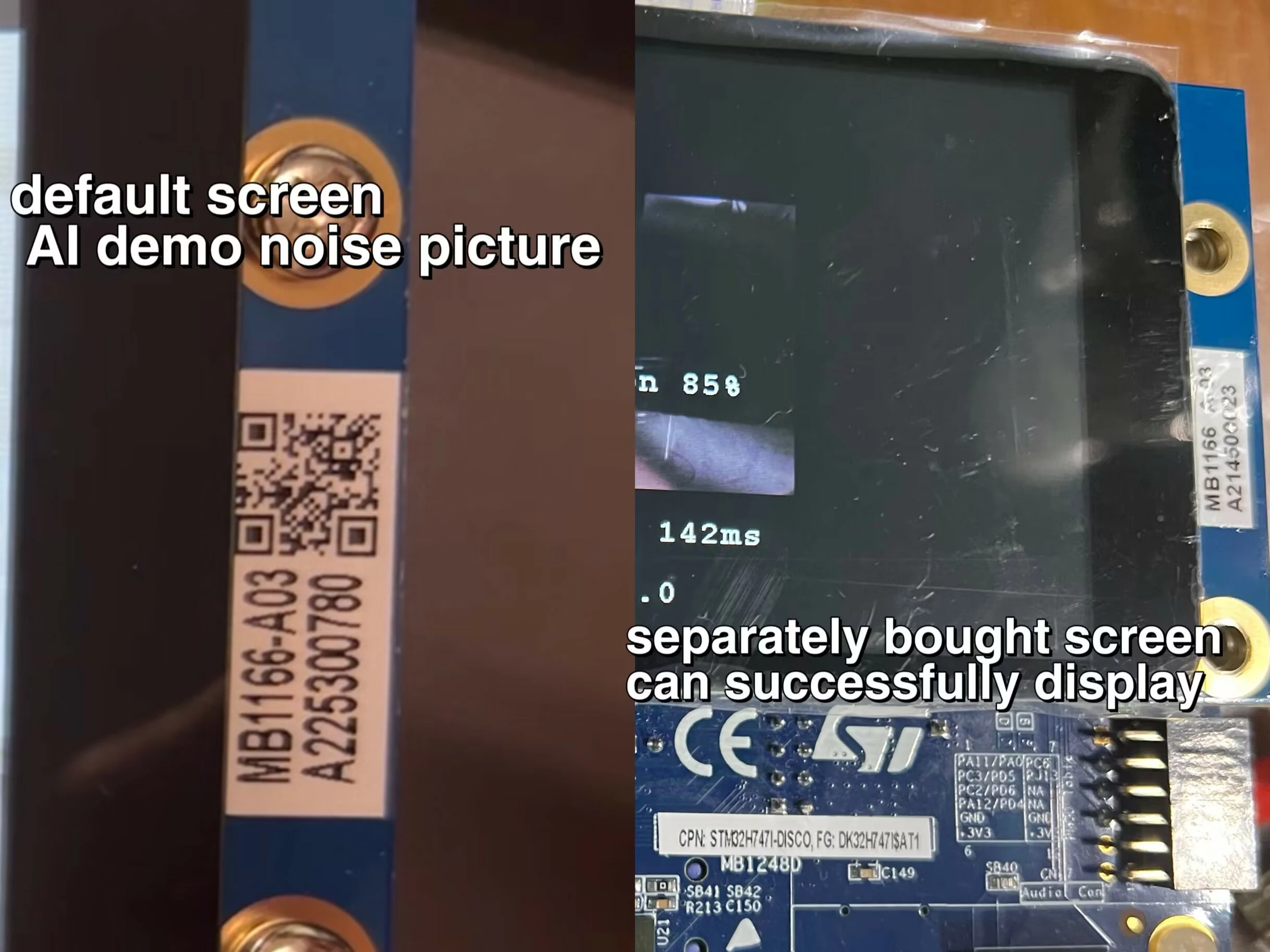

Hey Guys, GOOD NEWS!

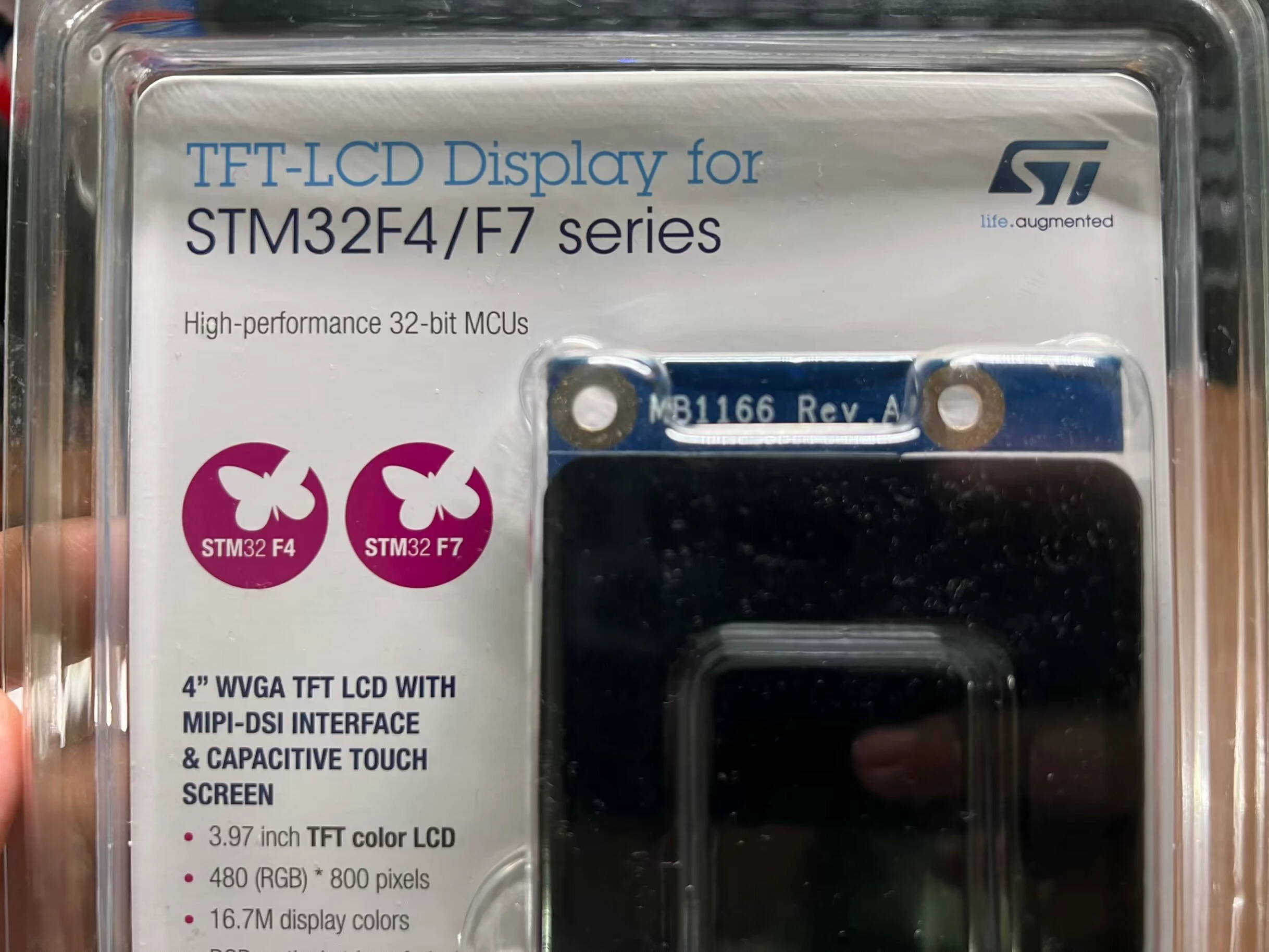

​It's the screen hardware problem, I bought a separate screen (B-LCD40-DSI1 4" WVGA TFT LCD) from mouser, which is same type but can normally display.
↓ difference between default screen and separate screen
_legacyfs_online_stmicro_images_0693W00000bjBnLQAU.png↓ package of screen module
_legacyfs_online_stmicro_images_0693W00000bjBq1QAE.png↓ FP-AI-VISION demo:person detect

The problem is that I use demonstration codes for the STM32H747 that have to display something on the LCD screen. I think that the problem is in the initialization of the screen.

Both codes are made for the for the same DISCOVERY. I have 2 of them and it doesen't work on any of them. I have tried to upload .bin files and it does the same.
I can't find the solution anywhere so I think that it happens because ST changed someting on the board maybe.

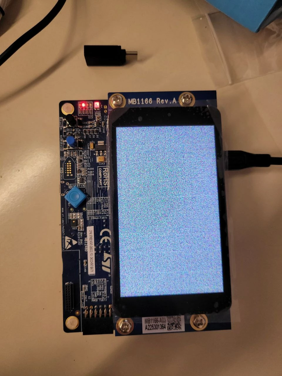

Hi Sarra, I think myself and BTUrc.2 have the same version looking at his image.
I have attached a higher res image where you can see the stickers.

Yes, I have the same board. The only difference that I see is in the sticker with the QR code. In mine is A225301364
