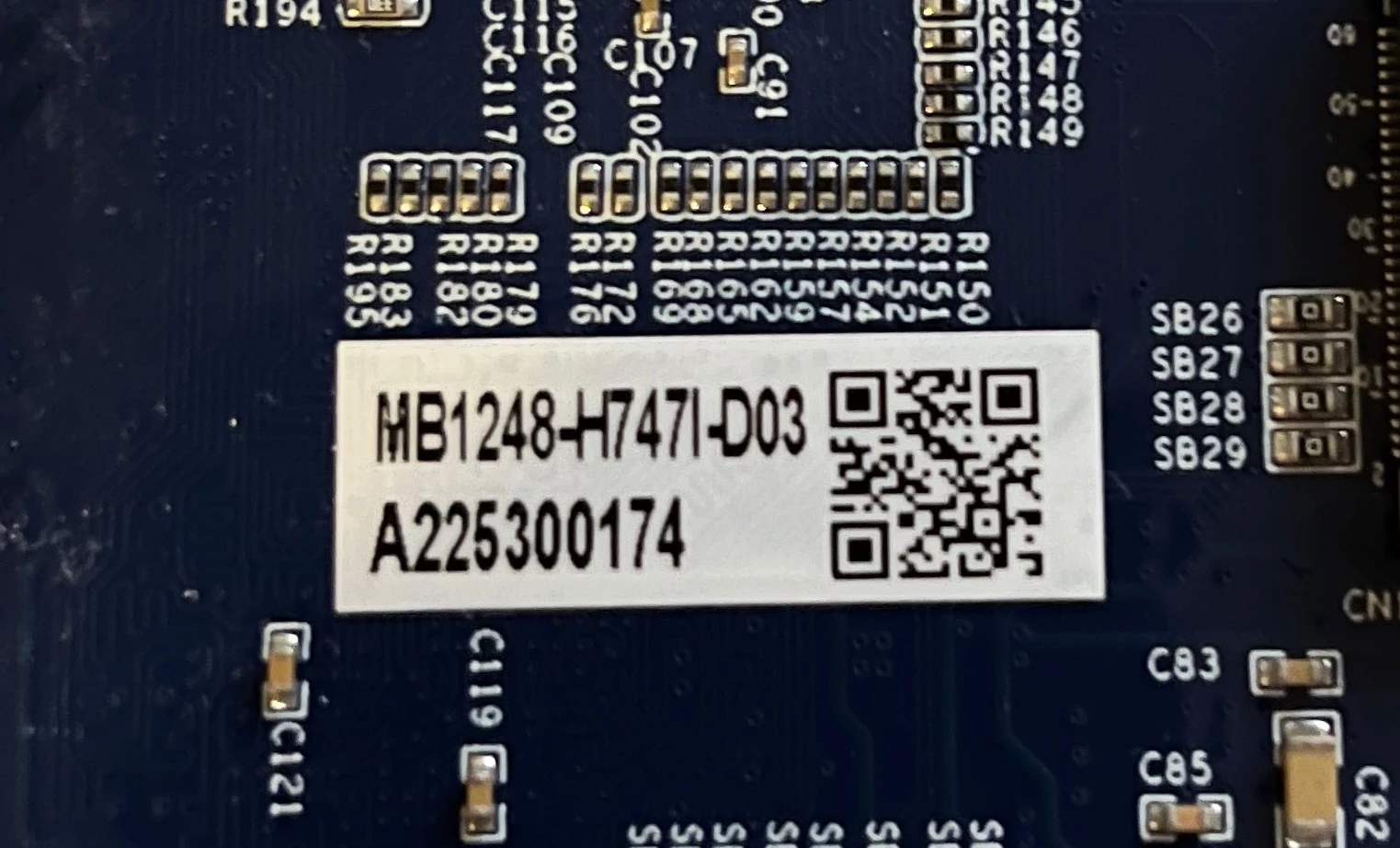

Hello @ACapo.1​
I also tested BSP with LCD rev A03 and board D01
EDIT: LCD_DSI example tested with board RevD01 and RevD03
Could you please check the board revision (Under LCD)

ACapo.1
Mar 10, 2023 5:30 PM UTC
D03 here​

ACapo.1
Mar 10, 2023 5:38 PM UTC
DO3 here.
0693W00000aIhCtQAK.jpg​
Board was from Mouser, there is also another guy having issues which may be related, also from mouser: https://community.st.com/s/question/0D53W00002ASl3lSAD/stm32h747-discovery-blank
Could you please attach your BSP example elf here and I will flash it so we can double check it isn't a software tool problem.

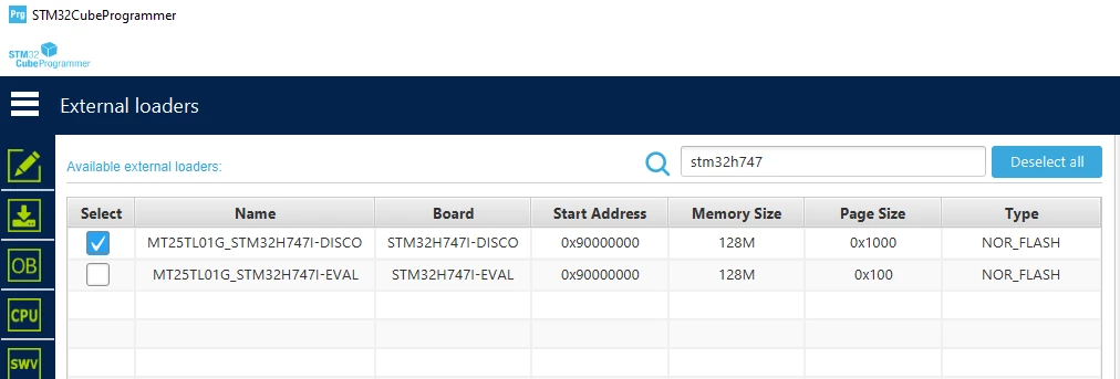

I don't see any mention of selecting an external loader?
If a reply has proven helpful, click on Accept as Solution so that it'll show at top of the post.CAN Jammer an open source CAN bus hacking toolCANableV3 Open Source
Karl Yamashita
Principal
Mar 11, 2023 2:37 AM UTC
If you're using Cube Programmer to program the bin, then try selecting a memory device
ACapo.1
Mar 11, 2023 6:20 AM UTC
Thanks. I have been using the correct External Loaded, it doesn't make a difference.

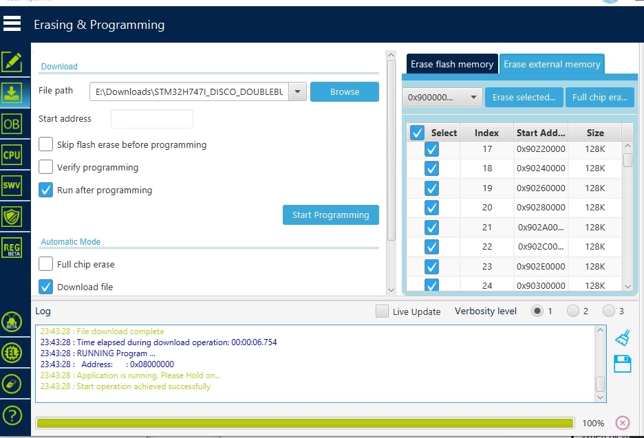

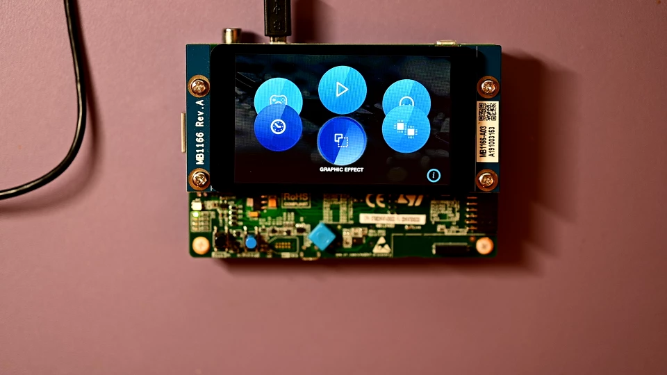

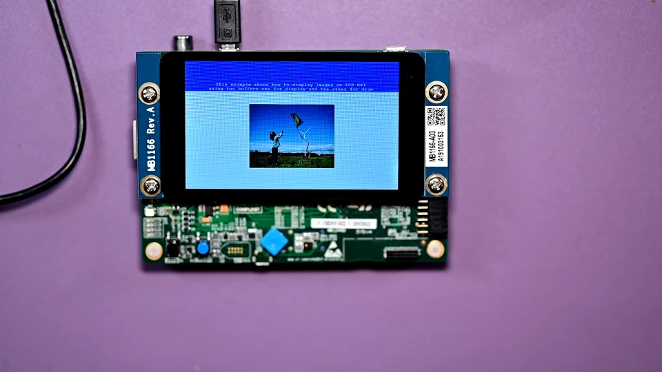

Karl Yamashita
Principal
Mar 11, 2023 8:05 AM UTC
I tried programming @Community member​ file that he posted and on the first try i was able to get it working.
i programmed it with a simple TouchGFX project to overwrite what was in memory. Then I tried subsequent times to program the hex file and all i could get to show was the Blue bar with white space, so without the image of the girl flying the kite and the white text..
I then followed the link to this post ttps://community.st.com/s/question/0D53W00002ASl3lSAD/stm32h747-discovery-blank
and tried to program the demo but nothing was showing, just a black screen.
Then I checked all boxes for the Erase External Memory before i started programming. It took a long time to erase the external memory but it ended up programming and I got the demo to work.
So i tried both Tesla's file and the demo hex file going back and forth. They both are consistently programming and displaying correctly.
