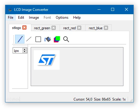

STM32F429i_Discovery with LCD load logo or image
Posted on September 15, 2016 at 10:10
Hello
everyone, I hope you are well.
I have a small
problem I would like to display a logo of my my university on board
but I sometimes displaying the logo ST.
I use LCD
image converter
but it does not work well to create my table to integrate it into the code.
I do not know
if ST used another converter. You can point me please.
I use BSP_LCD_DrawBitmap(...);
Thank you very much.

Hm...
Try swap position of red and blue color parts in color matrix (Operations 2 and 3 on screenshot
https://my.st.com/public/STe2ecommunities/mcu/Lists/STM32Discovery/Attachments/16888/2016-09-16_21-41-png
from previous post).
Also try convert 3 images filled with one color: only red, only green, only blue.
I have STM32F429I-Disco, but I don't have working application with BSP to check my assumptions.

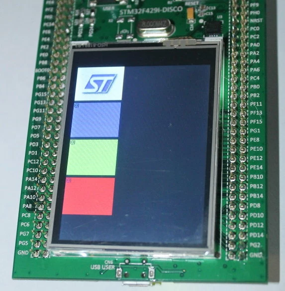

ibrahim
ibrahimAuthor
Sep 18, 2016 11:02 AM UTC
ibrahim
ibrahimAuthor
Sep 18, 2016 11:19 AM UTC
Posted on September 18, 2016 at 13:19
When I reversed the green and red, now I have that going the blue to purple and green to blue.

Ok, I have completed project with BSP and checking settings!
See attachments here.
BSP_LCD_Init();
BSP_LCD_LayerDefaultInit(1, LCD_FRAME_BUFFER);
BSP_LCD_SelectLayer(1);
BSP_LCD_SetBackColor(LCD_COLOR_WHITE);
BSP_LCD_Clear(LCD_COLOR_BLACK);
BSP_LCD_DrawBitmap(0, 0,
reinterpret_cast
<uint8_t *>(&stlogo));
BSP_LCD_DrawBitmap(0, 70,
reinterpret_cast
<uint8_t *>(&rect_blue));
BSP_LCD_DrawBitmap(0, 70 * 2,
reinterpret_cast
<uint8_t *>(&rect_green));
BSP_LCD_DrawBitmap(0, 70 * 3,
reinterpret_cast
<uint8_t *>(&rect_red));
I have described this in article
http://www.riuson.com/blog/post/generate-image-for-stm32-discovery-bsp
________________

Posted on September 19, 2016 at 03:44
In ''C'' you can use
BSP_LCD_DrawBitmap(0, 0, (uint8_t *)&stlogo);
I'm not used LCD on STM32F4 before. So I'm not familiar with BSP, DMA2D and other features. On STM32F1 I'm using FSMC + DMA + external display controllers.
XML is using as internal storage format of this utility. You can edit image, save it to XML file, open later and continue editing.
