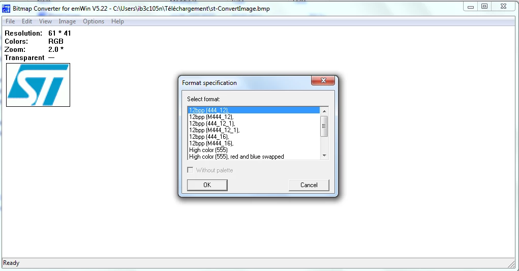

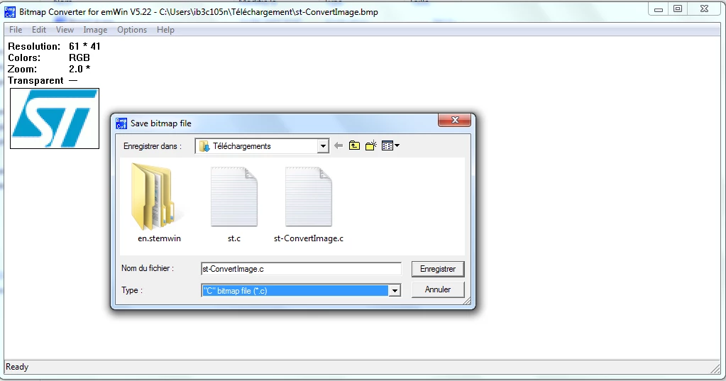

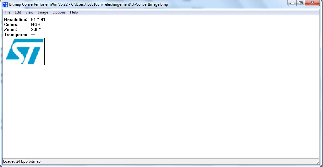

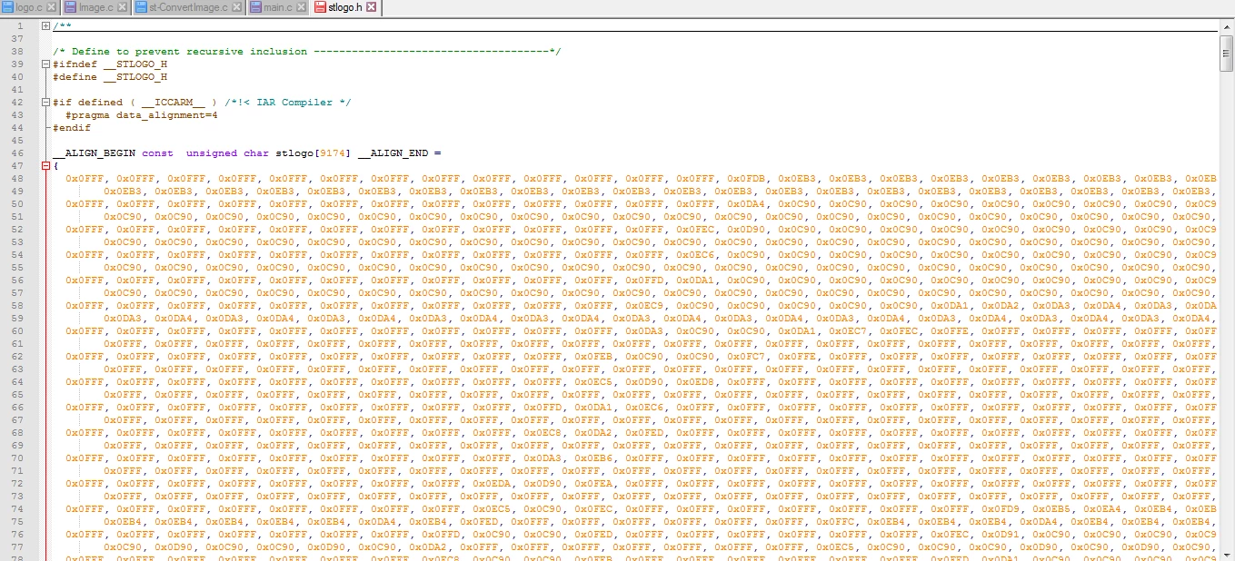

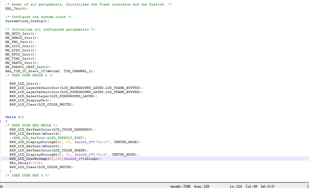

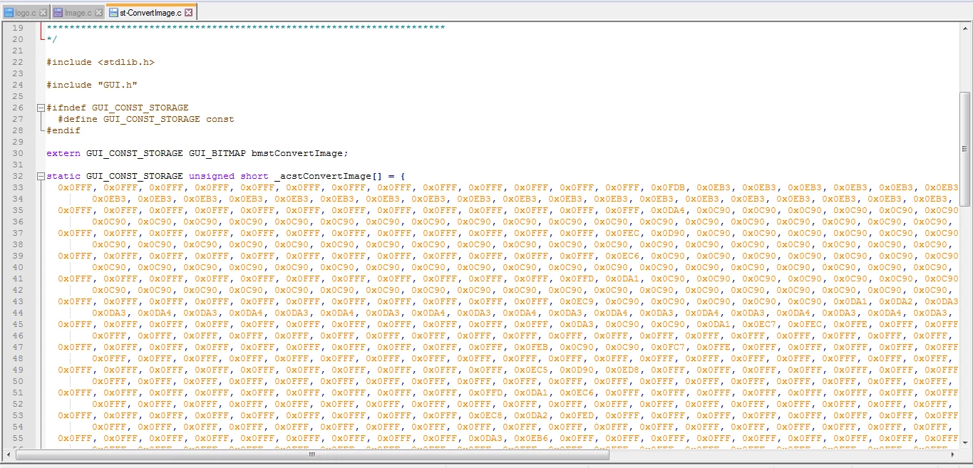

ibrahim
ibrahimAuthor
Sep 16, 2016 12:18 PM UTC
Posted on September 16, 2016 at 14:18
Hello
, here are the
steps
for
how I
try to do the same as
the example of
STM
1st step: I generate my
in table .c
with
BmpCVt.exe so I'll have my table soon after they are on 8bit 0xFF
and
soon
both
16bit
0xFFFF.
2nd step:
I open
my
file
stlogo.h
I brought
to STM
sample file
in STM32F4xx_DFP/2.9.0
/Projects
STM32F429I
-Discovery
/Examples /BSP/Inc
With
their
table
it works fine I displays the ST logo. but if I want to put my table and I create with BmpCVt.exe clears their table and I put my table. it gives me nothing and the display will give me any results
