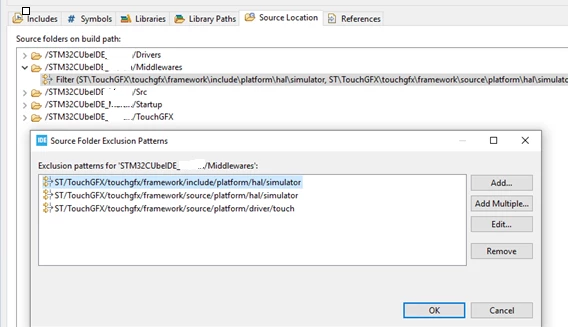

Thank you Martin for your 1080p video. I tried to follow it but I have the same problem as last time. When I try to build the project many paths of .hpp files are wrong. The .hpp files exist but the paths are wrong. For example, I get the following error : C:/STM32CubeProject/GenerateurPulse/TouchGFX/gui/include/gui/common/FrontendHeap.hpp:4:10: fatal error: gui_generated/common/FrontendHeapBase.hpp: No such file or directory
So I started add all the paths of the .hpp in "Includes " (Path and symbol window). However it take too much time. Do you think I have a problem with the general properties of CubeIDE ?
Valentin
eng23
Senior
Jun 5, 2019 4:23 PM UTC
Hi @Valentin Gros​ ,
I have a problem every time when I generate code in CubeMX, it erases the path configurations and I need to add manually.
Please check your path and symbol window, it needs to be like this (pay attention in excluded paths too):
Regards,
Anderson

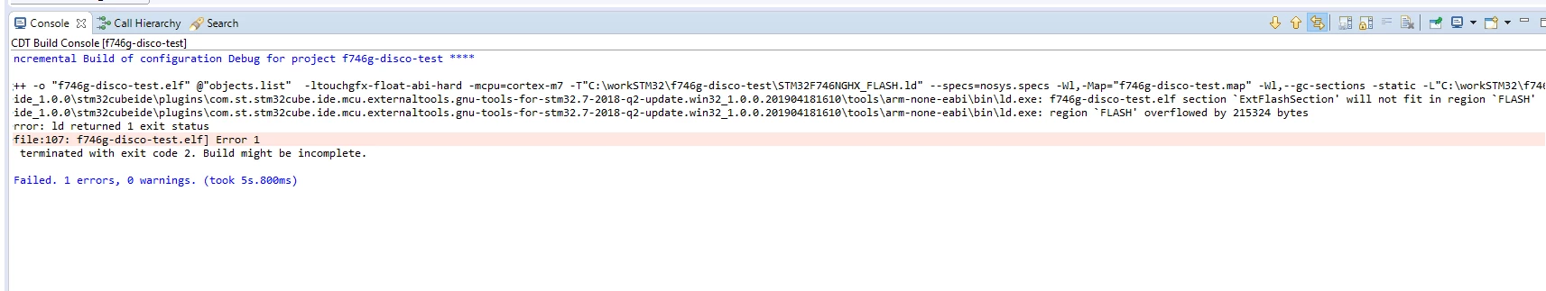

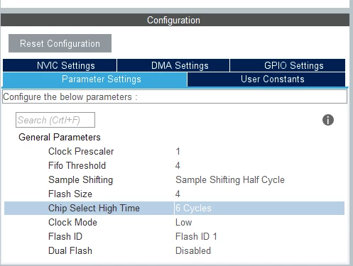

Hi @Martin KJELDSEN​
Firstly, thanks a lot for this guide, very helpful.
However I have an issue when I want to integrate somes images.

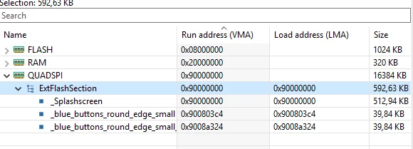

I started from your working project and then added somes images, but then I get this error:
'ExtFlashSection will not fit in region 'FLASH'
I guess it's because the linker needs to be updated to support the QSPI Flash, but could you provide some help about this ?
The article here: https://touchgfx.zendesk.com/hc/en-us/articles/360019884752-Configuring-STM32F746G-DISCO
Only state about the EWARM\stm32f746xx_flash.icf, but the linker file for STM32CubeIDE is totally different, I guess I have to modify STM32F746NGHX_FLASH.ld, but not really sure what to do there.
Also, In your video you seems to let the default configuration for the QSPI, but in the article stated above, the configuration seems a bit different:
When I configure the QSPI like this and generate again, and after I exlude everything related to the simulator, I get a lot of compilation errors:
any ideas ?
Thanks,
Thomas.

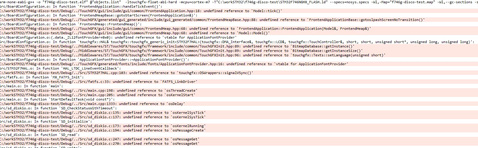

Martin KJELDSEN
Principal III
Jun 12, 2019 9:19 PM UTC
Hi Thomas,
I have some ideas. It's getting late so i'll come up with a reply tomorrow. One hint: When you generate code again, CubeMX will actually delete your OSWrapper_cmsis.cpp source file, causing linker errors. You can reinstate that. Also, yes, i did a quick "initialize peripherals in default mode" and did not do any optimizations as per our written guide just to get a working CubeIDE project. Maybe i should have stated that - Thanks for the tip.
/Martin
Thomas Laurenson
Jun 13, 2019 9:31 AM UTC
Hi Martin,
You were right OSWrapper_cmsis.cpp was deleted by CubeMX, i had to copy it from a saved project, and also add some paths to the source paths (Middleware and TouchGFX were missing) and managed to get a compiling project again.
Also, i modified the linker script like this:
added:
QUADSPI (r) : ORIGIN = 0x90000000, LENGTH = 16M
ExtFlashSection :
*(ExtFlashSection ExtFlashSection.*)
*(.gnu.linkonce.r.*)
    . = ALIGN(0x4);
} >QUADSPI
Now the images go into the ExtFlashSection correctly:
But when i run a session the screen just show rubbish pixels.
not sure if the images are loaded into the external flash, or if the program can work with the external flash correctly.
Thomas.

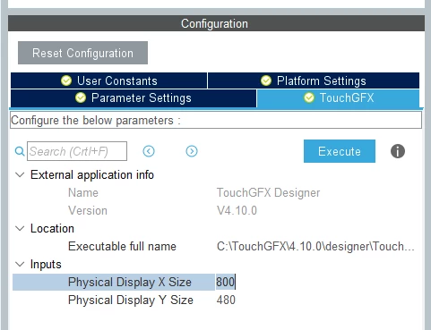

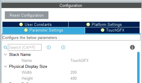

Senior III
Aug 22, 2019 1:45 PM UTC
I recently went through the same process for the STM32F769-Discovery kit and had a similar result. No compile errors and when debugging to the kit, the screen was black. I have not been able to get it to work, but I was able to change the size. I could edit the X and Y sizes in CubeMX's Middleware > Graphics > Configuration TouchGFX section. Are you trying to edit the size in the TouchGFX section or the "Parameter Settings" section?
In my case I could edit the sizes in the TouchGFX section but not the "Parameter Settings" section which showed a size of 200x480:
But like I said, I still couldn't get anything on the Discovery kit's screen (it does work if I create a project in TouchGFX and use it's "Run Target" button).

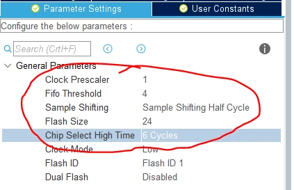

scottSD
Senior III
Sep 10, 2019 8:30 PM UTC
Awesome job, HP!
I appreciate it and can actually make out what you're doing on the video ;)
I hadn't commented out MX_ETH_Init(), so thanks for a heads up on that.
The only thing I would add is that a person might want to change the STM32CubeMX > Connectivity > QUADSPI settings to increase the size to what is available on the board. I ended up running out of space and needed to do that. And of course, as you stated, you only have one chance to generate the IOC file because it really messes things up if you do generate it again.
Here are the settings I used:0690X00000AQz1MQAT.png
 (From the link: https://touchgfx.zendesk.com/hc/en-us/articles/360019884752-Configuring-STM32F746G-DISCO)
