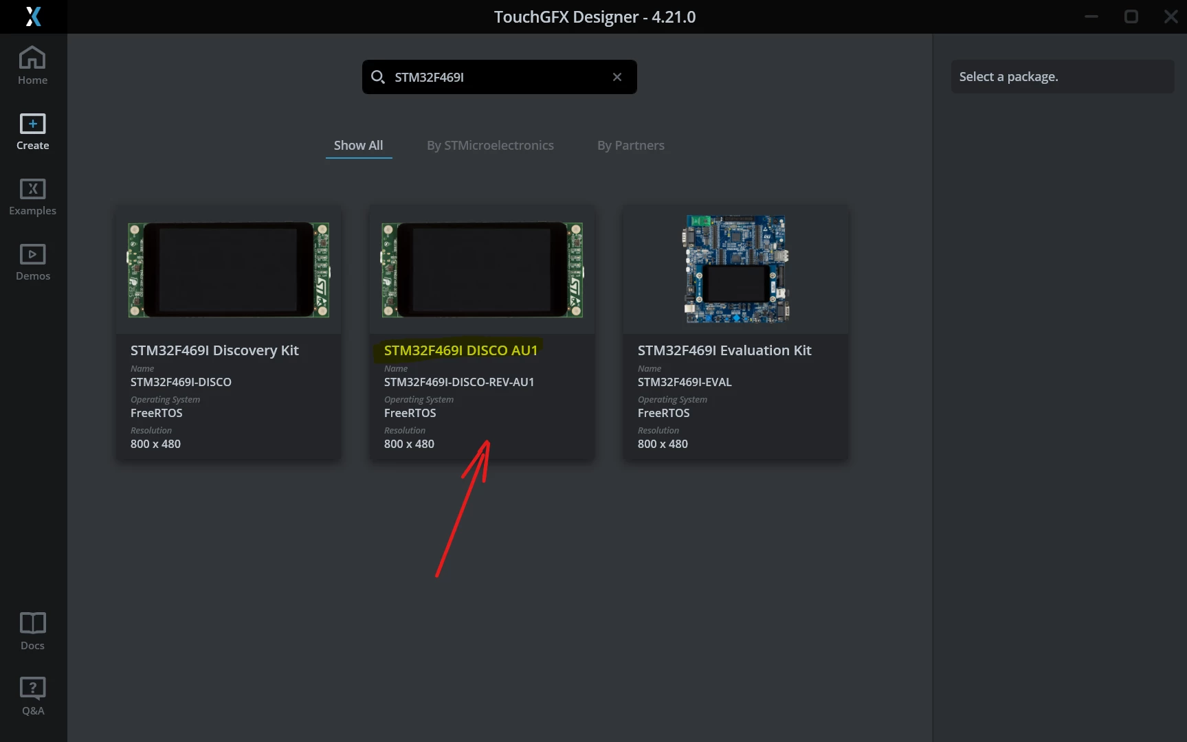

A new TBS is now available on TouchGFX Designer 4.21.0 for this STM32F469I-Disco $AU1 revision (B08)
It should resolve the issue with the black screen.
/Osman

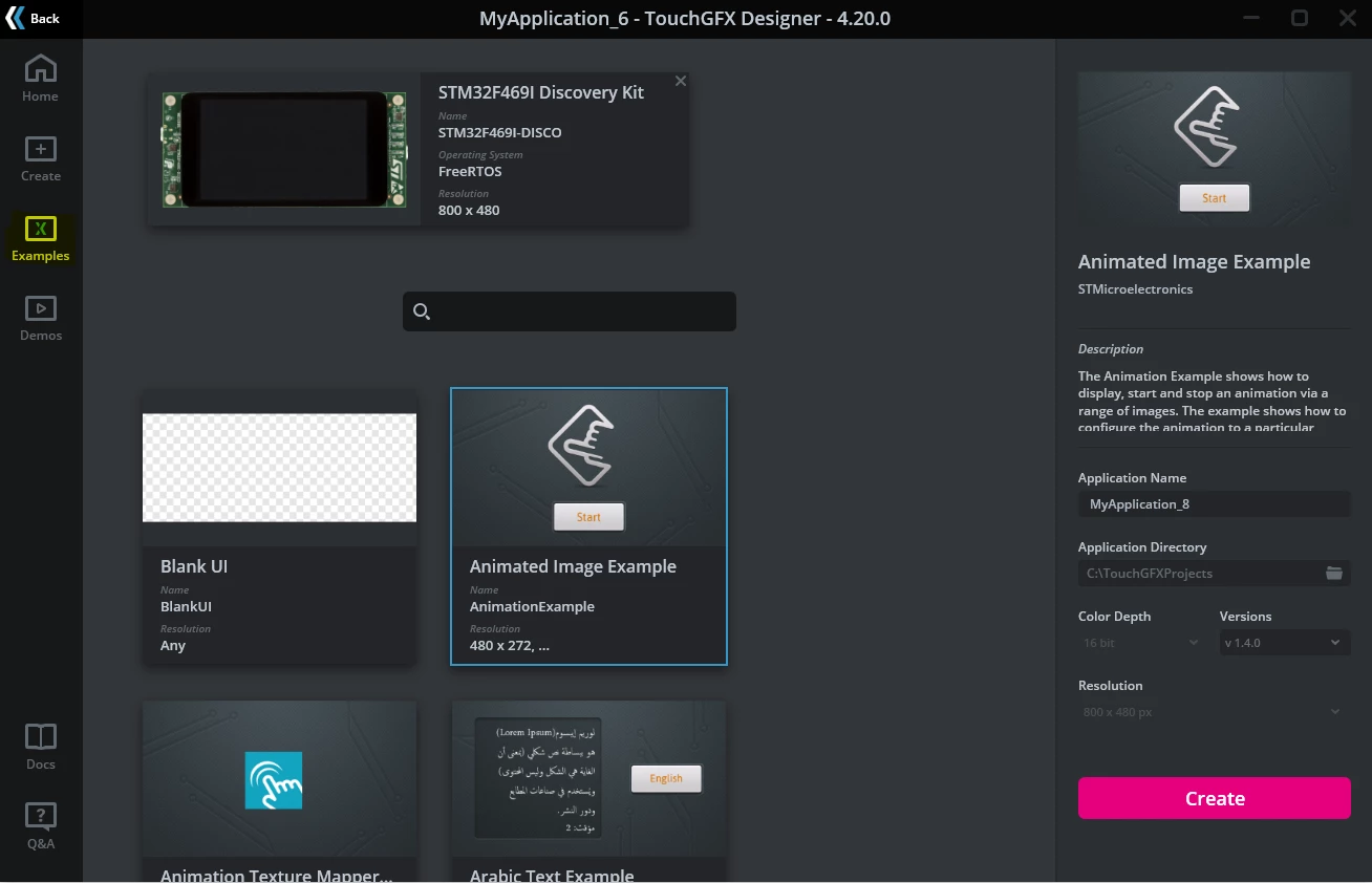

Simply step by step:
1. Start TouchGFx 4.20.0
2. Click on Example – select Animated Image
3. Click on Select Board
4. Select STM32F469i Discovery Kit
5. Click On Generate Code
6. Log – Finished with Done – no errors
7. Click on Run Simulator – working witout problems
8. Click On Run Target- compile without problems, finish with Done
9. Unplug / Plug – Screen remain black.

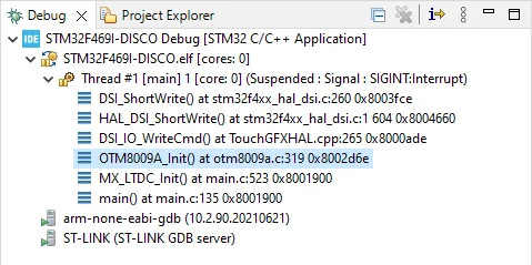

21. The first problem is in :
When system call „MX_LTDC_Init();“
Call stack:
while ((hdsi->Instance->GPSR & DSI_GPSR_CMDFE) == 0U)
 /* Check for the Timeout */
 if ((HAL_GetTick() - tickstart) > DSI_TIMEOUT_VALUE)
 return HAL_TIMEOUT;
  This function „MX_LTDC_Init�? take almost 2min time.

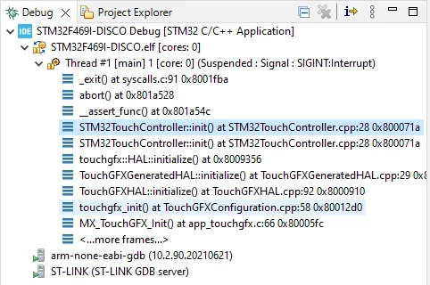

System is freezing in:
(STM32TouchController.cpp)
void STM32TouchController::init()
 * Initialize touch controller and driver
 if (BSP_TS_Init(800, 480) == TS_OK)
 bsp_ts_initialized = true;
 assert(bsp_ts_initialized);
Its invoke:
(syscalls.c)
void _exit (int status)
 _kill(status, -1);
 while (1) {} /* Make sure we hang here */
Call stack:
Best regards Stanislav P.

I am facing the same issue. I guess this happens with the Rev C boards. Apparently the board has a new screen on it with a new NT35510MH lcd driver but the same old FT6336G touch controller.
As a part of the touch controller initialization,
"I2C1_Read" function in stm32469i_discovery.c calls the "HAL_I2C_Mem_Read" which returns HAL_ERROR
I am not sure what the underlaying issue is.

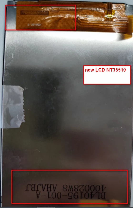

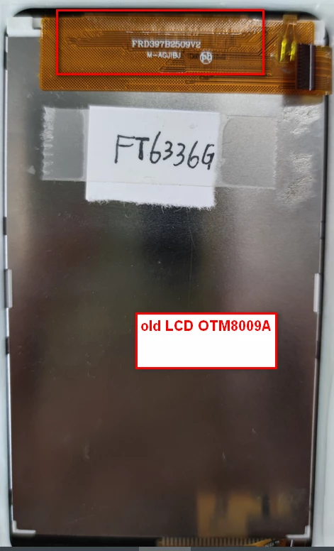

Ebby is right that the board has a new screen on it with a new NT35510MH lcd driver but the same old FT6336G touch controller. but I am not sure if the new LCD has implemented in your STM32F469-DISC board. the driver for old OTM8009A and new NT35510 is different, can you check which LCD is applied in your board?
  1. new LCD NT35510: FPC-400B25025V1
0693W00000WIL93QAH.png 2. old LCD OTM8009A: FRD397B2509V20693W00000WIL9DQAX.png

LCD originaly mounted on delivered 469i-Disco Board:
BL40220-005-A
400050W8 BBJBBC
FRD400B25025-A-CTK
BBJDJG
(Flex PCB)
FPC-400B25025V2
New LCD - (working LCD)
BL40200-001-A
400013W8 BAJAE
FRD337B250009-0-CTK
BAJBBB (I am not sure - there is thick layer of glue)
EXUE.2
November 15, 2022
the originally LCD FRD400B25025-A-CTK is NT35510 driver, so you should used NT35510 driver in code.
