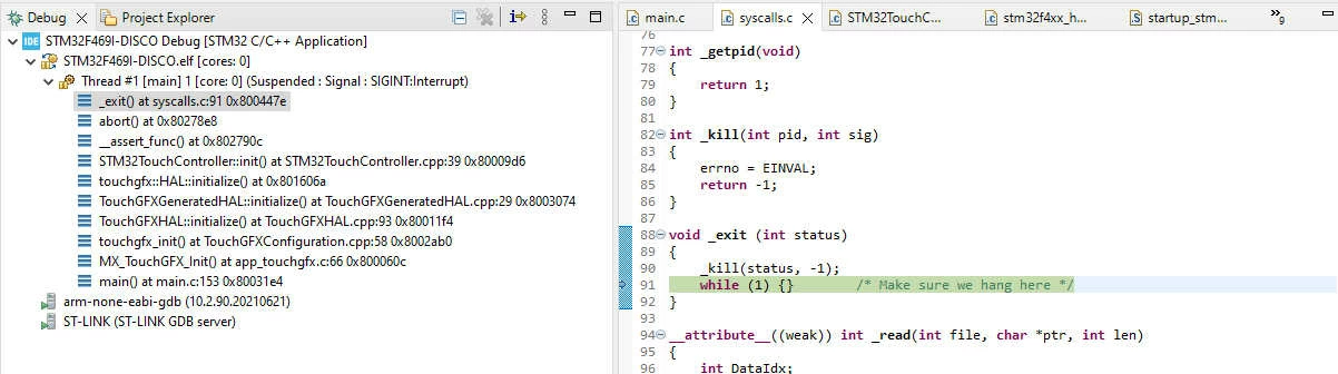

[SOLVED] STM32F469I-Disco and TouchGfx 4.20.0. I bought STM32F469IDisco. Version MB1189-F469NIH6-B08-A222300689. When I try start new project with TouchGFX, result is black screen.
I tried both "Run Target" from TouchGFX Designer, and Cube IDE (Cube MX) compile / debug result is black screen. Compile, debug and run is without errors.

Final debug screen:

Debug from stm32469i_discovery_ts.c file, function BSP_TS_Init
I2C_address = 112 = 0x70
PH7 - with or without PULL UP - not working.
I found, function BSP_TS_INIT return error 0x03 = TS_DEVICE_NOT_FOUND
Important this funtion is calling approx 15 sec after program debug started.
