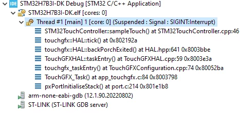

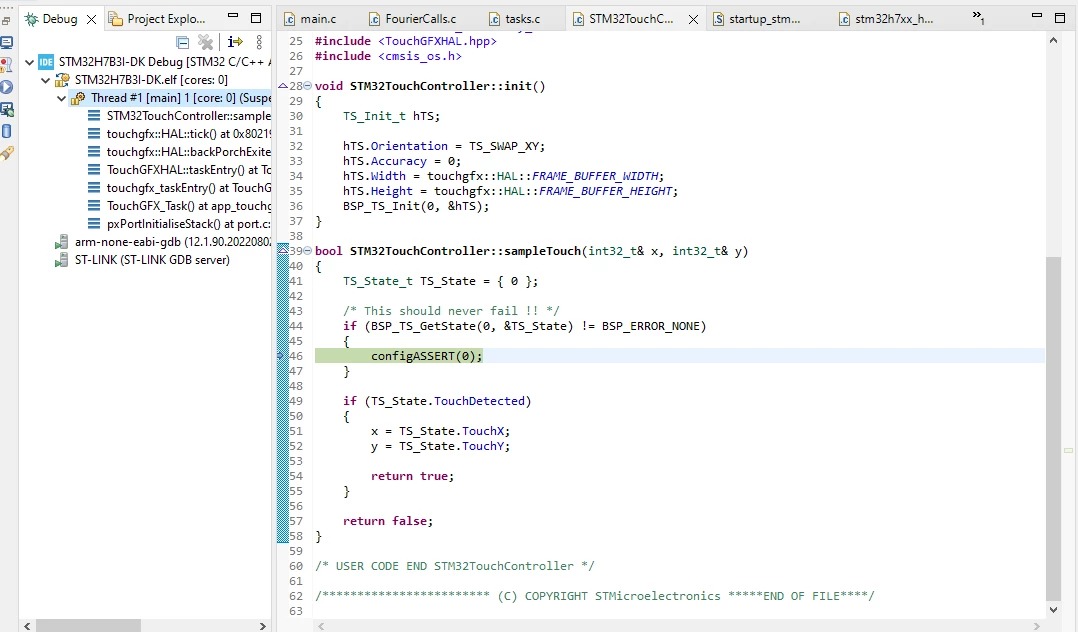

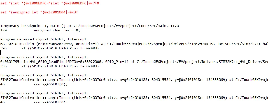

Hello all ,to provide  update on the status of issue - the issue still persists , as per @MM..1  suggestion , I tried debugging the code ,but the freeze does not occur immediate after display initialization or after specific time of execution .It is random, hence when display stops responding (freeze condition),I paused the debugging , the control is in "configASSERT() " line inside bool STM32TouchController::sampleTouch(int32_t& x, int32_t& y)function in STM32TouchController.cpp file.
For n number of debug process -debug ->display freeze->pause ,the control is always at same line specified above.
Hence, I shall restate the issue by eliminating frame buffer concept and other few details in a simplified manner-
ISSUE : When 61,440 DWords(245Kbytes) of SDRAM is used ,there is no issue with process, but when 62,464 DWords(249Kbytes) of SDRAM is used , display freezes or in other words display neither responds to touch nor executes main thread(display does not change as per expected function which is what I referred as freeze condition).
Does memory access time causing the issue?
I have attached images of debugger console and debugger track . Please kindly provide support to resolve this issue at earliest.CodeSnippet_onpauseCodeSnippet_onpauseDebuggerConsole_onpauseDebuggerConsole_onpauseDebugWindowDebugWindow
