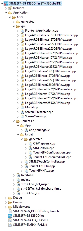

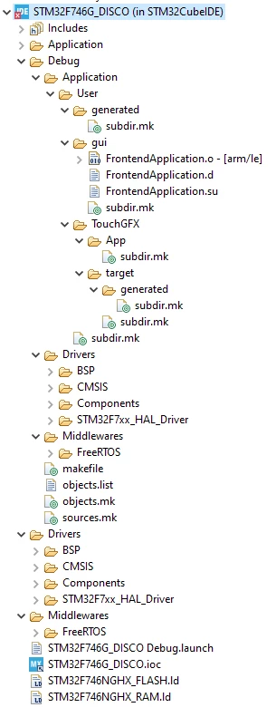

I tried regenerating code from within TouchGFX Designer, same error. From within STM32CubeIDE I also tried right clicking on the project and clicking "refresh", that didn't help.
The file "LogoARGBBilenear127QSPIPresenter.cpp" does not exist in my project. I just let STM32CubeIDE import the project. I didn't do anything special after that such as import other files, I figured STM32CubeIDE would know which files to import. I have attached a screen shot of the structure of the freshly imported project. To me, it does seem incomplete.
EDIT: It looks like the files might want to be in the project, but they have this yellow exclamation mark next to them. Check the new screen shot0690X00000BwJ1wQAF.png
Martin KJELDSEN
Principal III
Jan 21, 2020 10:29 PM UTC
This looks really weird!
You have .o files listed, among other things. And no code files. Very strange. Send me the project.

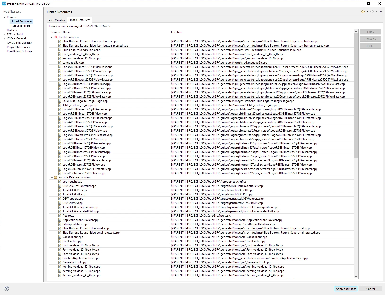

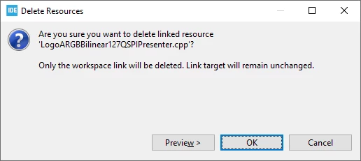

I went to attempt something similar, but instead I just wanted to try and delete these files. When in STM32CubeIDE I tried to delete the files and the STM32CubeIDE presented this dialog:0690X00000BwLMrQAN.png
That got me thinking about linked resources in other projects I have worked on, so I went to view all of the linked resources in this project. Right click the project->Properties->Resource->Linked Resources-> then click the linked resources tab. I then see a list of all the linked resources:
I did not link these resources, TouchGFX must have created these links when generating the project.
Clearly there are "Invalid locations". So I browse to these locations on my disk, and yep, these files don't exist. There are similarly named files, but not the correct ones.

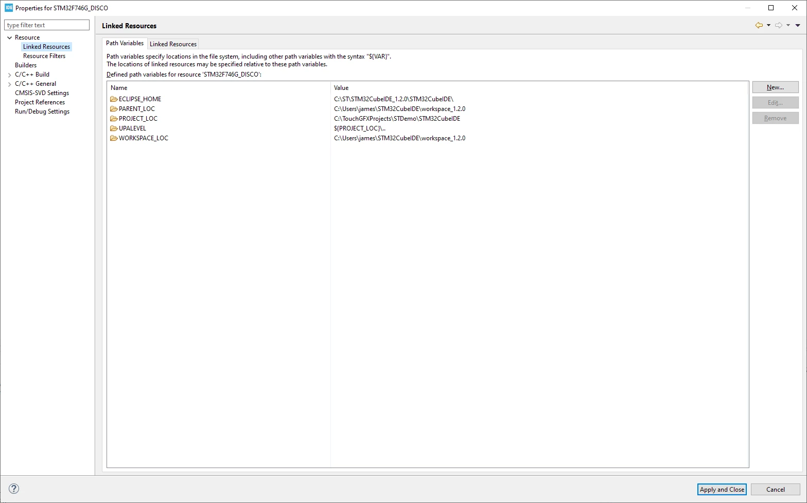

The Path Variable that is being used to generate the links for the resources is odd, and doesn't show in the Path Variables tab either:
