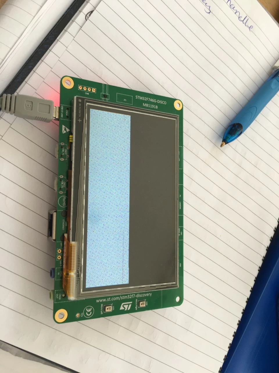

BO Re.1
Jan 31, 2020 11:40 AM UTC
Hi Martin,
i have tried several times the following:
  • Created TouchGFX project using Application Template STM32F746
  • Created 2 screens, button on each to swap between
  • Generated code and Run Target, in touchDesigner, which downloaded to board and touch worked.
  • then i set up a second task in Main with CubeIDE, following video tutorial (embryonic.dk) yours i think, thanks
  • Built project->failed to debug in CubeIDE as per previous posts.-> opened in Touch GFX and 'Run Target' successfully downloaded again
  • i then generated the necessary code in Model-Presenter-View files, in cubeIDE and built the project , fixed any errors and confirmed build.
  • when i tried to download to board again with RUN Target in touchGFX designer, it is successful but my screens dont appear i have attached a picture
  • i have checked the heap size and it is large enough, 32768, my second task is only 512(4)
any idea of what might be going on here, it is quite difficult not being able to debug in CubeIDE so i am at a loss. any help or guidance is greatly appreciated
