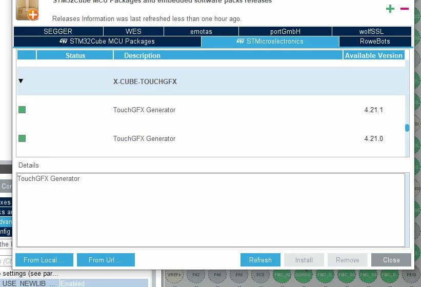

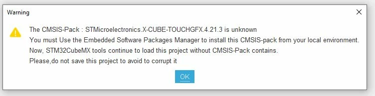

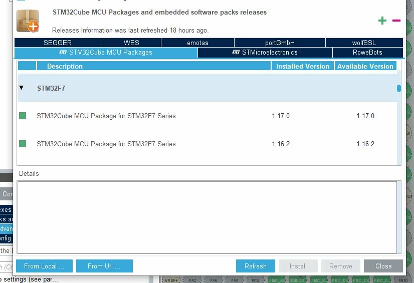

I updated to TouchGFX 4.21.3, STM32CubeIDE 1.12.0 and STM32CubeMX 6.8.0. At the first compilation I had an error telling that cmsis_os2.h was missing. For I couldn’t fix the problem instantly I totally deinstalled these 3 programs and reinstalled them. For testing I coded a simple demo in TouchGFX and imported it into CubeIDE without any problems. When opening CubeMX I got messages (image 4a + 4b). This project was definitely set up with TouchGFX 4.21.3 and should be encluding STMCubeMX V6.8.0. There should not be a message to ‘continue’ or ‘migrate’. A message that TouchGFX 4.21.3 is unknown is not o.k..
Further more it is impossible to install CMSIS-Pack by the embedded software manager. Those packages are missing - at least for STM32F7 (image 5a + 5b).
How can I install these packeges by hand or when you will have fixed this problem? I’m working with Windows 10 and with STM32F769 Disco.

TLang.5
TLang.5Author
Mar 24, 2023 2:09 PM UTC
0693W00000aJQt0QAG.jpg0693W00000aJQtAQAW.jpg0693W00000aJQt9QAG.jpg0693W00000aJQt9QAG.jpg

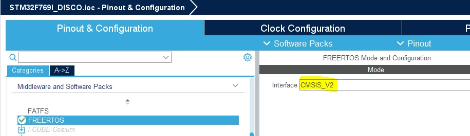

Rim LANDOLSI
Mar 27, 2023 9:47 AM UTC
Hello @TLang.5​ ,
Try to check application template version that you are using.
We noticed sometimes that CMSIS v1 does not work on some board but V2 works and vice versa.
As shown in this screenshot, STM32F769 Disco is working correctly with CMSIS_V2
Thanks,
TLang.5
TLang.5Author
Mar 27, 2023 10:03 AM UTC
Hi @Rim LANDOLSI​ ,
my setting is already CMSIS_V2 but it is good to know that this could cause an error. Up to know I didn't have this on the screen.
Thanks
